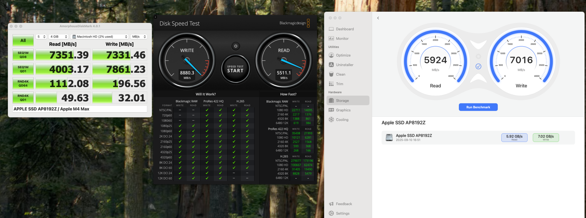

Thanks Surenmunoo, What Read/Write speeds are you getting? Over 7000MB/s? Original Apple gets 5800 MB/s read and 8500 MB/s write.
Hi, See the speed tests I got below.
