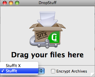

Consequently, I have a copy of Stuffit Standard 8.0.2. I believe it's the last version that they allowed you to have all the components on. It works in Leopard. DropZip, DropStuff, DropTar and Stuffit Expander.
You can have .sit or .sitx with this version. I've put it up on my Dropbox for you here if you want it.
I have a bad habit of collecting stuff because freeware/shareware developers have a bad habit of either dissapearing or making their stuff commercial only.
Many thanks! Downloaded, and will try it. 🙂
EDIT: Tried it. Works! Thanks a lot!

v10.0.2 Deluxe works fine. I am using it on my iBook G4. I guess it should work on Intel Mac as long as Rosetta works too.
The "trick" is to change in the preferences from .sitx to .sit, and use the archive option from the MagicMenu.
