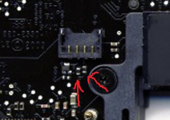

So I just got my MBP used on ebay, and it was listed as-is with the high fan condition. I found that whoever owned this MBP broke the fan connector off the logic board and tried reattaching it. They apparently broke one of the resistors off the logic board also. I want to replace that one and the one next to it just to be sure. I believe that the resistor is a 47k ohm resistor from what I can tell on schematics, but I need to be sure before I order the replacement, see attached photo.

Might not be helpful to you but you might want to give Dadioh a PM or something (he's a user here, in my friends list). He made a thread about logic board repair for bad backlighting but he is pretty experienced with these boards and replacing stuff on them. He can make sure you've got the right schematic and stuff...
Anyways, just letting you know, soldering these resistors sucks. A lot. I had to replace the 0402 backlight fuse on my mobo and they are about the size of half a grain of rice. Try soldering that without a hot air station! 🙂
