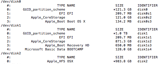

So... I'm a bit confused...
Disk2 should be equal to disk1s2, but it looks like it's adding disk1s2 and disk0s2 (plus a few extra mb?)
I'm at a loss.
Everything, in use, is working correctly. I just believe finder is showing me 120gb more available than I actually have. Unless my "OSX" drive has messed up the fusiondrive, and is now a "stacked" logical drive, in that the SSD has files stored on it, and the hdd has separate files stored on it, instead of the same files being on both, technically.
(in fact, I'm confused as to why "disk2" exists at all, shouldn't it just be disk1s2?)

I think you are in good shape and Disk Util is just reading wrong because of the Fusion/Bootcamp combo.
That Terminal output is normal. Disk2 is not a real drive.... it is your virtual 983GB Fusion drive created by 871GB disk1s2 and 121GB disk0s2 added (fused) together.
I believe this is just a bug in DU, because that Terminal output adds up exactly.
