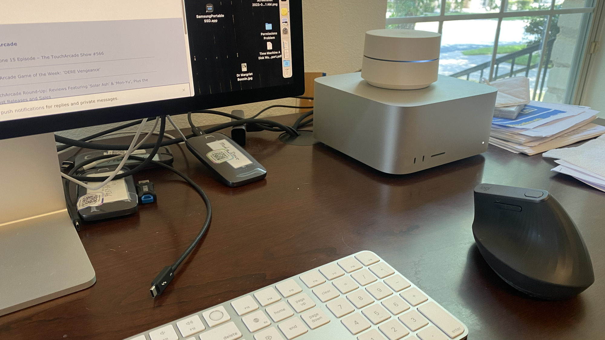

I have a Studio M1 Max and Studio display with a Google mesh base station sitting on top of the Studio and connected via ethernet to the Studio and to the Google modem. I have an MX Vertical which I've attached with:
  • first using the Universal Receiver plugged into the back of the display,
  • then found that the mouse can connect via Bluetooh and tried that
  • Then attached using a Samsung Thunderbolt 3 cable to a slot at the front of the Mac Studio
  • now back to Bluetooth.
I've attached a photo to illustrate.
In all cases, since installing the Studio, I've had problems with the mouse.
  • Often it seems to double tap. In mail, if I right click to delete, often two emails will delete.
  • Sometimes a mouse click doesn't seem to register
  • In most apps, not all, dragging too highlight text is painful.
  • Rarely will it just highlight the dragged area.
  • Mostly it does random things like highlighting a single word
    • sometimes it does a copy and move a small segment of text
  • etc
I thought the mouse was bad. Purchased a 2nd one, but it's has the same effect.
I have an Apple extended keyboard connected via bluetooth. Very occasionally it will add an extra character, but I suspect that's caused by my fat fingers.
I glad to see here that the Logitech has known problem with 2.5 GHz and "reducing the polling rate to ridiculously low levels." This thread has suggests moving the mouse away from the Studio, and if using the receiver, increasing separation for that too. I'll also try increasing separation of the Google WiFi Mesh router.
However, I don't see why using Thunderbolt 3 cable doesn't improve things. Perhaps it's not well shielded, or perhaps everything is just too close together.
  • etc
I've tried all the suggestions without success, except moving the Google mesh base station further away (I did move it a few feet away), or seeing if I can disable the 2.5 GHz channel.
However #1: I did replace the MX3 with an Apple Magic Mouse 2 and the problem goes away. But I don't like it's ergonomics.
However #2: I used the MX3 on an iMac for a few years and the problem didn't occur. So the fact that it only began when I connected the MX3 to the Mac Studio, and that connecting the MX3 by a cable to the Studio, leads me to think the Studio itself is part of the problem.
I highly doubt the problem is the Mac Studio. I have the MX3 paired via Bluetooth to my Mac Studio and have no issues at all. The same goes for several Mac Studios at work.
It's far more likely you're just experiencing interference as others have mentioned. Try using the little wireless adapter Logitech provides with the mouse instead of Bluetooth, and try plugging it into different ports. If you're already doing that, try pairing it via Bluetooth instead.
I've had interference issues with WiFi in the past and it turned out to be interference with a small desktop-sized fan I had about 12 inches away from the computer. The fan didn't have WiFi or anything like that, it was just a regular old fan - but something about the frequency of sound it produced interfered with WiFi. Moving the fan further away fixed the issue immediately.
The lesson is (for me anyway), don't just look at other computer equipment, but any electronics around the computer.
