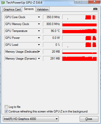

Let's see, you have one of the new MBPs with Nvidia graphics, if I'm not mistaken... Find a program called GPU-Z (it's only a couple of MB.) This program lets you monitor the clock speeds, temperatures and other stats of your graphic cards.
Now, in my experience Windows doesn't actually recognize the discrete and integrated cards, rather, it just lists your discrete (Nvidia) as the only one, but programs like GPU-Z still track the clock speeds of the intel card.
That said, in the graphs section of GPU-Z, find your GPU and Memory clocks. Keep an eye on them as you run the games that give you issues. If the stutter happens when the clocks go from very low to very high or the other way around, then the problem is the graphic cards.
Try it out, post your results.

Well here are the results of my intel card anyway.

Ah, so you have the 13 inch? Hmmm then there's no graphics switching... But did you notice any sudden changes in the graphs when the stutters happen?
The core clock changed from low to high as well as the power etc.

Ok I think that the stuttering might be due to the high graphics requirements of the games you're trying to play. I don't know about the other two, but Dead Island is a pretty graphics intensive game, and the Intel 4000 HD isn't a gaming powerhouse, rather, I think it's meant to provide good performance to everyday apps that don't require a high end card while keeping the power consumption to a minimum.
Just to make sure though, does the stutter happen when you're doing things other than gaming? Browsing the web, editing documents, etc?
