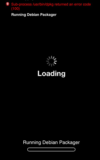

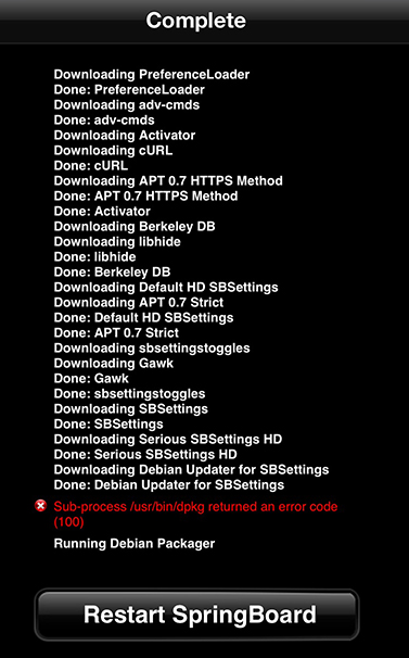

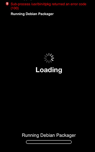

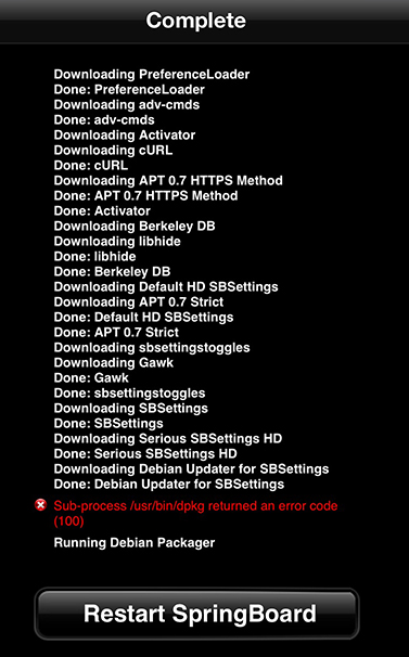

I did the above and it did reset my cydia back to default. But whenever I try to install an app I get an error. I took a screen capture of the error message I am getting.

I am trying individual packages. It looks as if every package requires dpkg to run and dpkg is incomplete or messed up.
Is there away to reinstall dpkg?
I fixed it. I used iFile and copied all of the dpkg related files from my jailbroken iPhone and replaced them in the same directory on the iPad.
