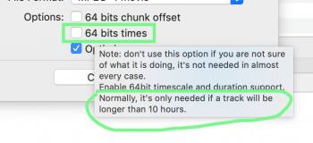

It's been 7 years since you posted this, but I figured you might be curious to know, if you leave your mouse pointer over the line "64 bits times" a tooltip appears after 2 seconds.
