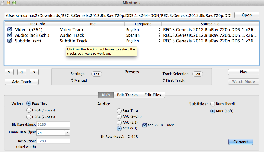

Yeah I just realized that I need to use mkvtools for this. Is the below correct for what I'm trying to do? Then I would just move the audio files over to subler to mux it all together?
Yes, you are correct. I was thinking that mp4tools would do it but it's mkvtools. You screen shot looks good to me. Give it a go.
If you want to remux MKV's to MP4's, you should go for MP4Tools. MKVTools is for editing / outputting MKV's but not for remuxing.
BTW, I've just checked the latest beta (released a week ago) of MP4Tools with a DTS-only MKV (the one at http://www.auby.no/files/video_tests/h264_1080p_hp_4.1_10mbps_dts_unstyled_subs_monsters.mkv ). The automatic mode with a combined 2-ch AAC + AC3 m4v output worked just fine.
As it outputs M4V's natively, there's no need to pass its output to Subler either.

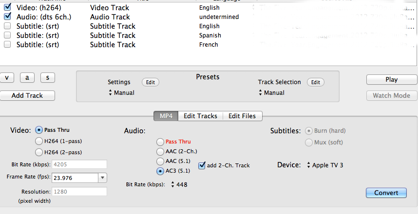

Wow I just figured out why it wasn't working. I had it on edit tracks (which apparently it can't do). I just switched it to mp4 and now it added them. I didn't touch that originally since it's how the program opened up. So a little help on this portion.
What do i do if I want to remux this file so that it plays on my apple tv? I selected Apple tv 3 as a device so I'm assuming I can pass thru, switch it to ac3 5.1 and add 2-ch track. The only other question I would have is what bit rate to use for the audio file?
Also, once the file is output from MP4Tools can I throw it into Subler to update the metadata in it?
Crap. now I think I'm more confused then ever. MP4Tools isn't making any sense.
I just reuxed 5 gb file and I ended up with a 349 mb m4v. I set it so the video was pass thru, the audio was ac5 5.1 and add 2 channel and that's it.
I guess I just don't understand how this program works. I'm obviously doing something wrong.
