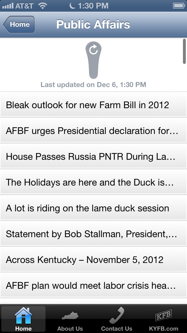

Here is what they said:
During the review of your application, we found the pull to refresh feature, shown in the screenshot, mimics an iOS interface and behavior.
It would be appropriate to remove or revise this feature. Thank you, and we look forward to reviewing your revised application.
Reply that you're using UIRefreshControl, part of the iOS 6 SDK.
You're not mimicking anything; you're using the same provided control.
