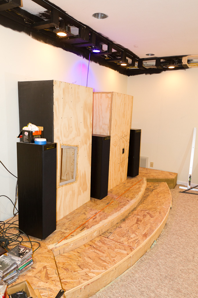

I have two monolithic horn-loaded subwoofers with 15-inch drivers in my theatre. In order to keep the foundation from cracking (seriously) and the rest of the house from vibrating into oblivion I had to decouple the platform they sit on from the house as best as I could - no connection to the walls, minimal connection to the floor. To do this I built a stage platform that is filled with more than 2000 pounds of sand. The key here is mass.
So while it's easy for me to say that it's bad the only solution I can really suggest is that you add mass and a lot of it to decouple the sub from the floor. That will reduce the mechanical vibrations. If the tower is vibrating due to air pressure then you have a totally different problem.
