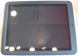

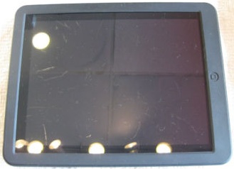

Since you didn't post a "before" picture, do you think it was as bad as mine is? See attached pic

That is really impressive. I've got these same scratches in the coating, does a screen shield make them less visible?
YES!
