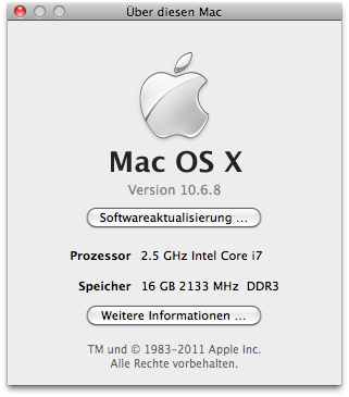

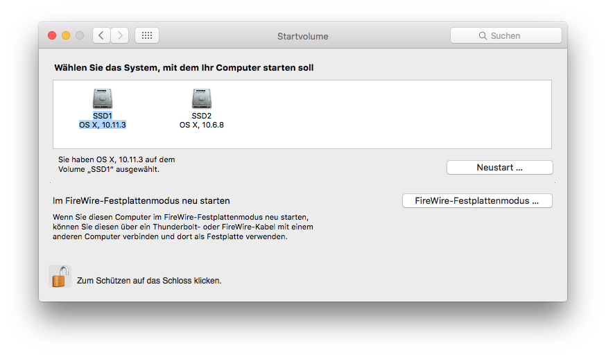

I just put the SSD with 10.6.8 on it back into my Late 2011 and it even showed my RAM running at 2133MHz too:
