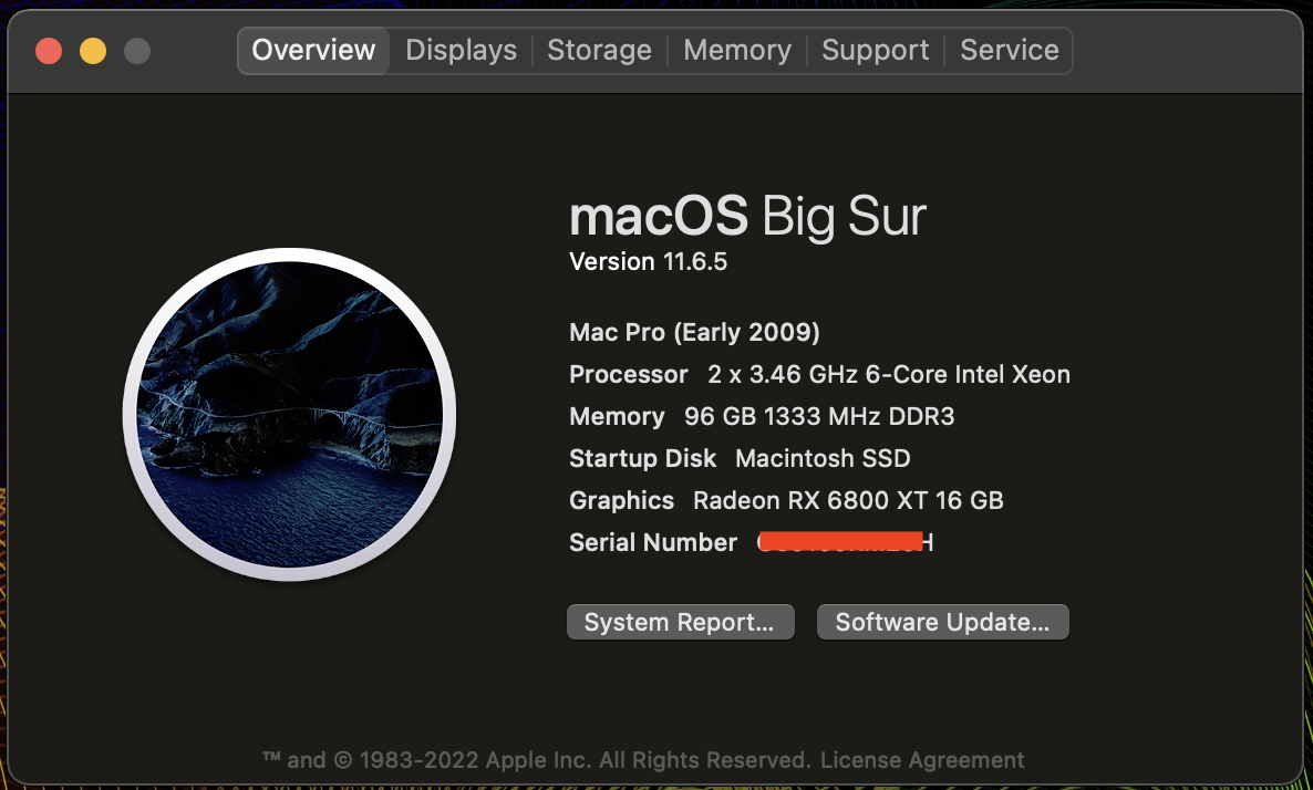

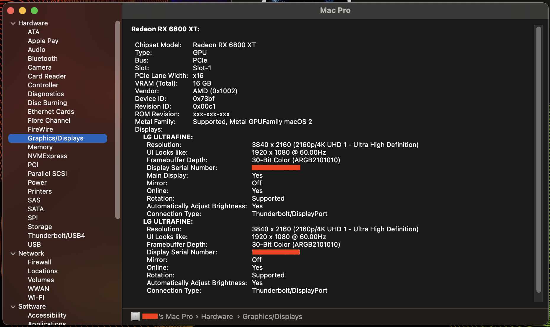

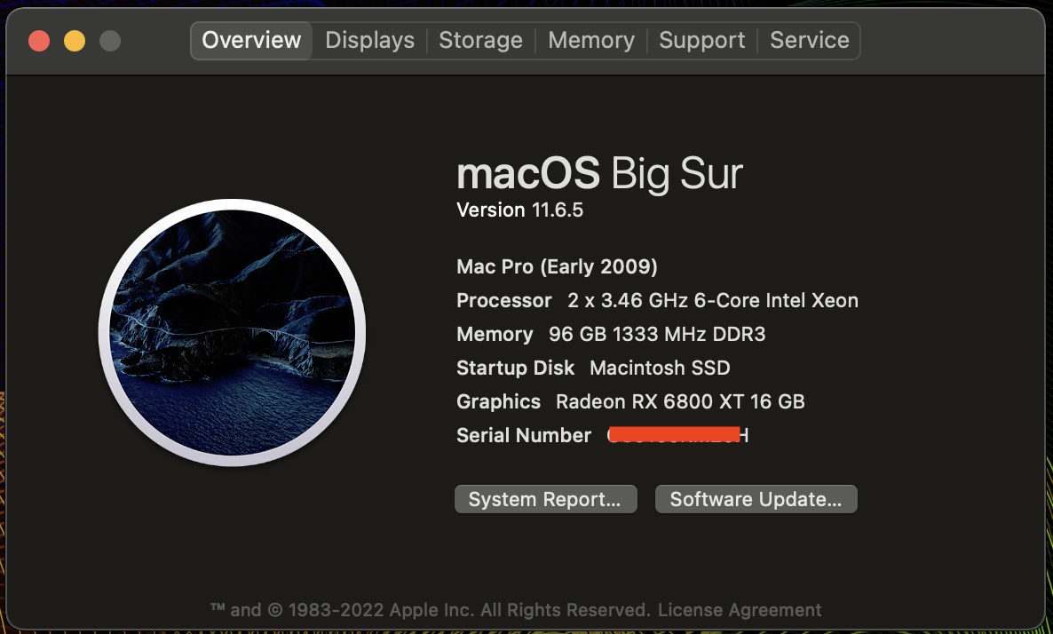

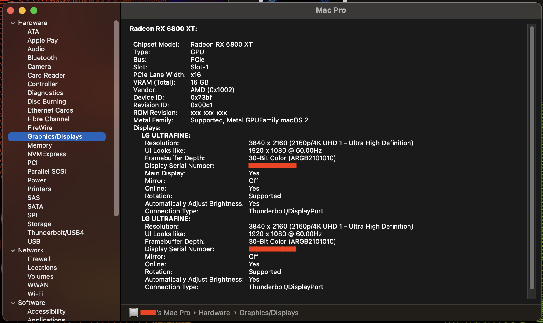

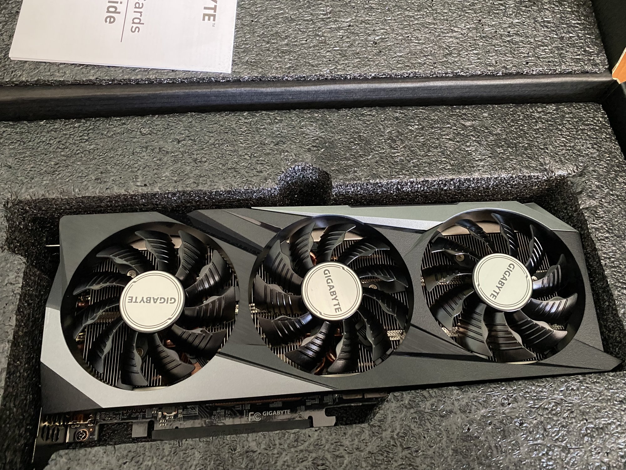

I posted this in the 6800XT/6900XT thread, but I feel like it's not getting the visibility it deserves, so I'm posting in the main forum, so that people can see that the cMP is STILL going strong, now with the addition of AMD's 6k series cards, all thanks to Syncretic.

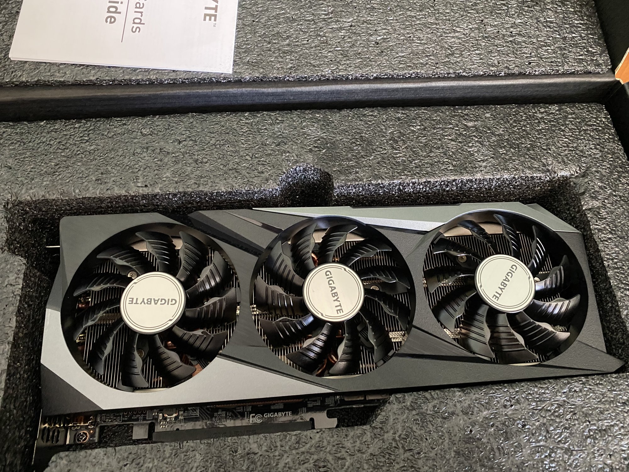

I am more than happy to report that @Syncretic 's patch does work 100% to install an RX-6800XT on a cMP 4,1>5,1 running OpenCore 0.8.0, Big Sur 11.6.5, the rest of my specs are in my sig. (@Greggant, if you wanna mention this confirmation on the DMUG youtube, gimme a shoutout! 😛)
As soon as Syncretic made his post, I returned my RX-5700XT and acquired a brand new RX-6800XT.

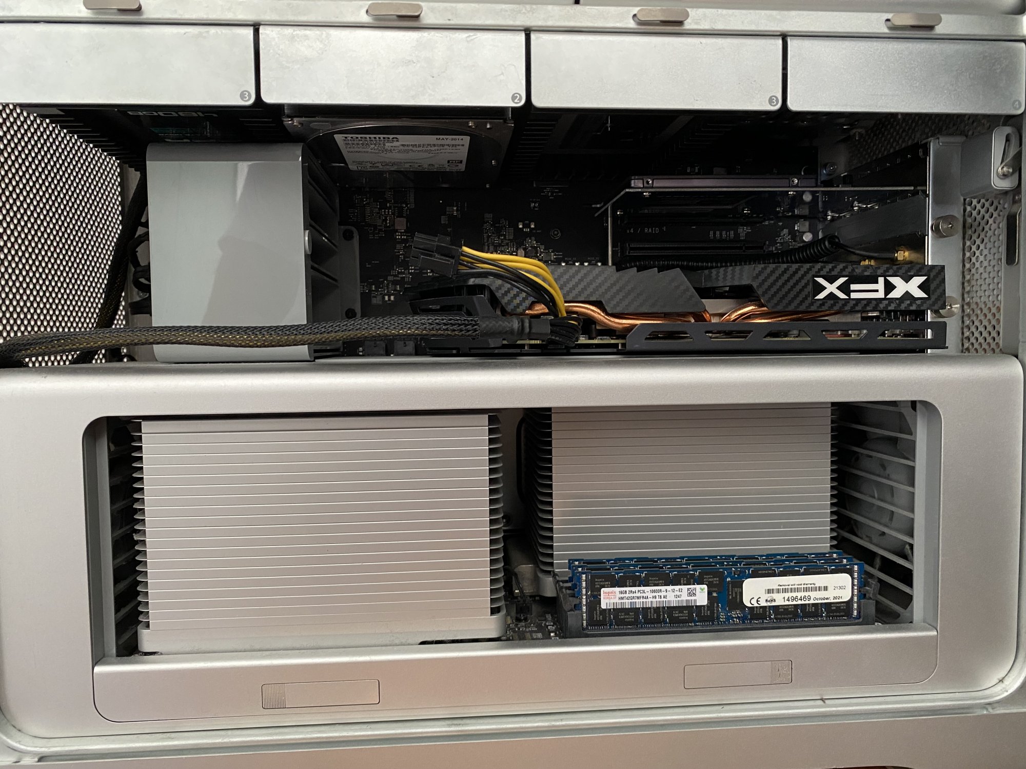

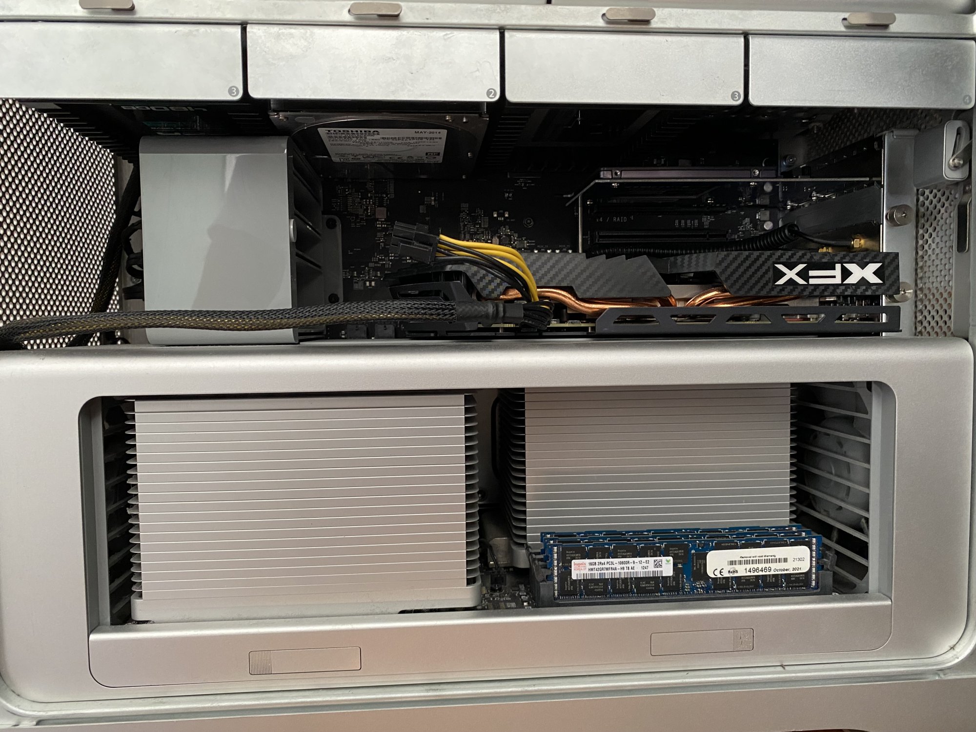

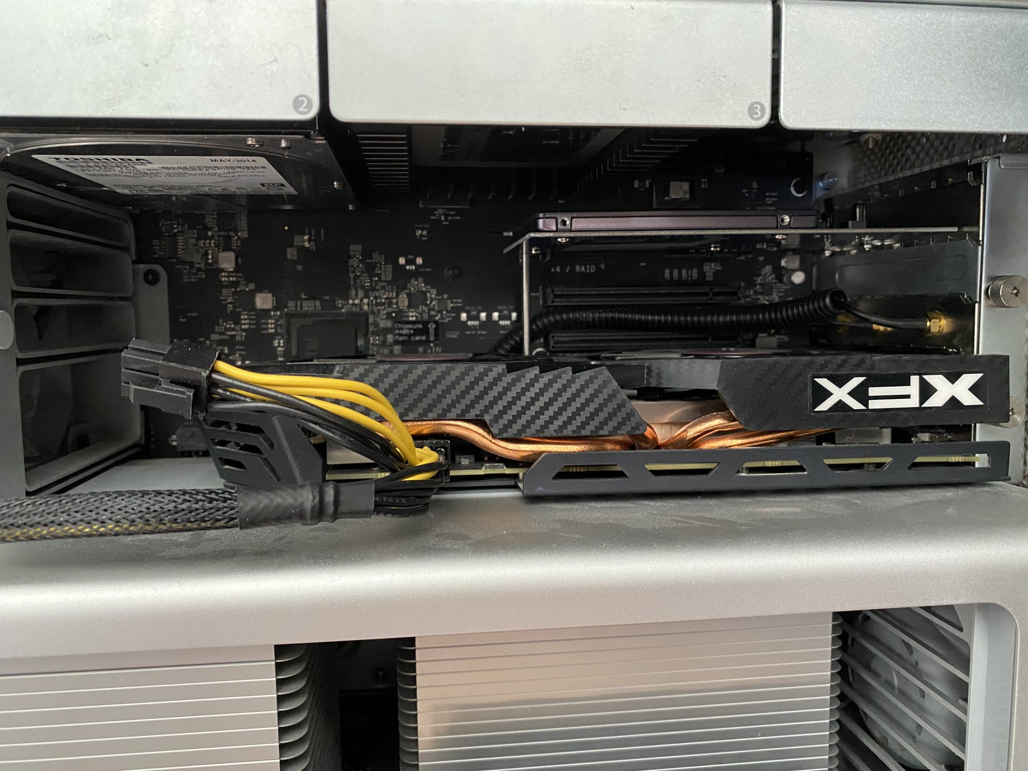

Whilte I waited for the 6800XT to arrive, I went back to my XFX RX-580, so you will see before and after pics below. Since I had previously already done the Pixlas mod for the 5700XT, it was a simple plug and play.
Here you go folks, as promised, the excitement!:

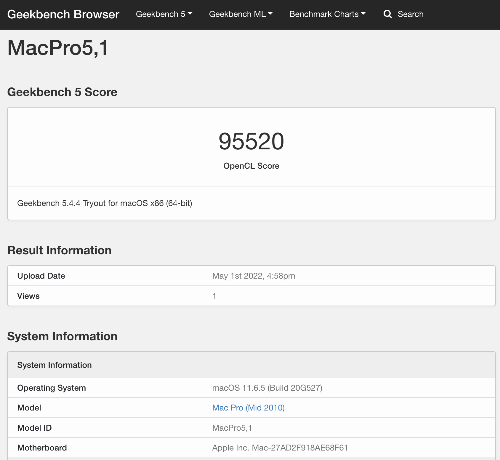

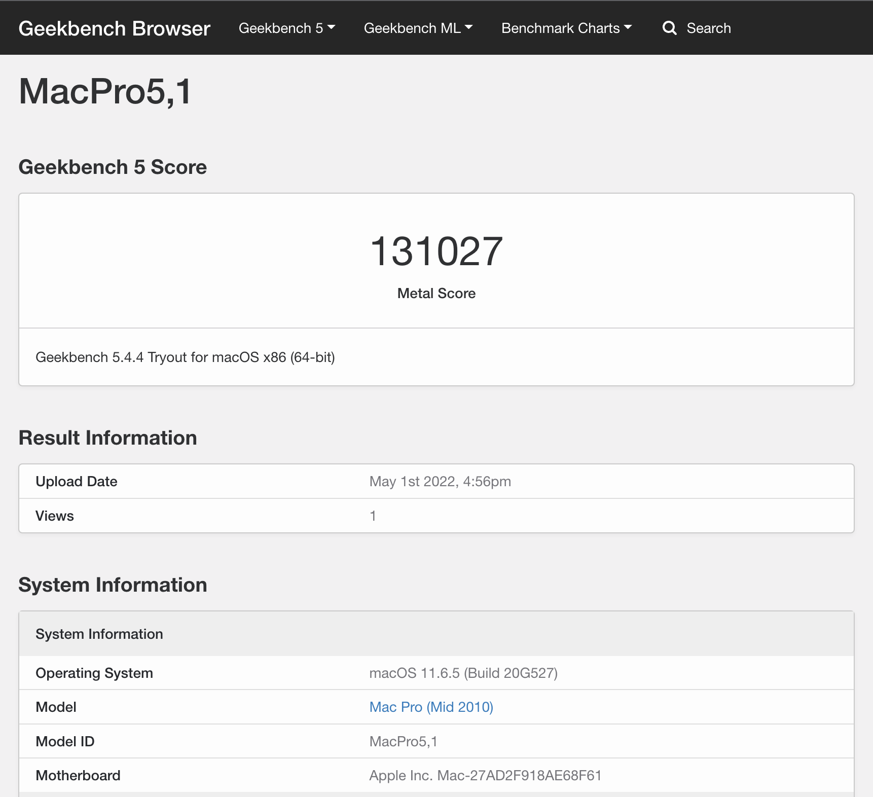

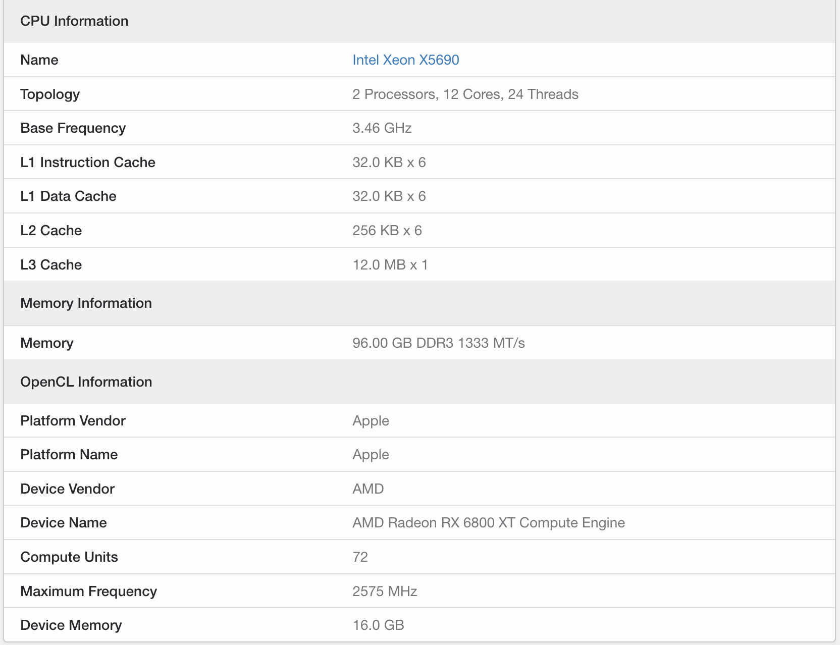

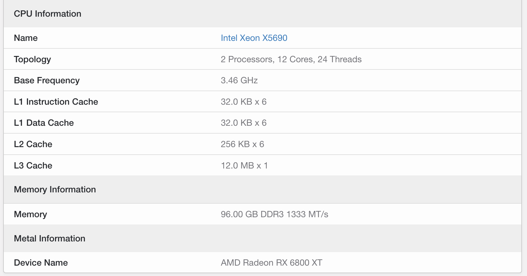

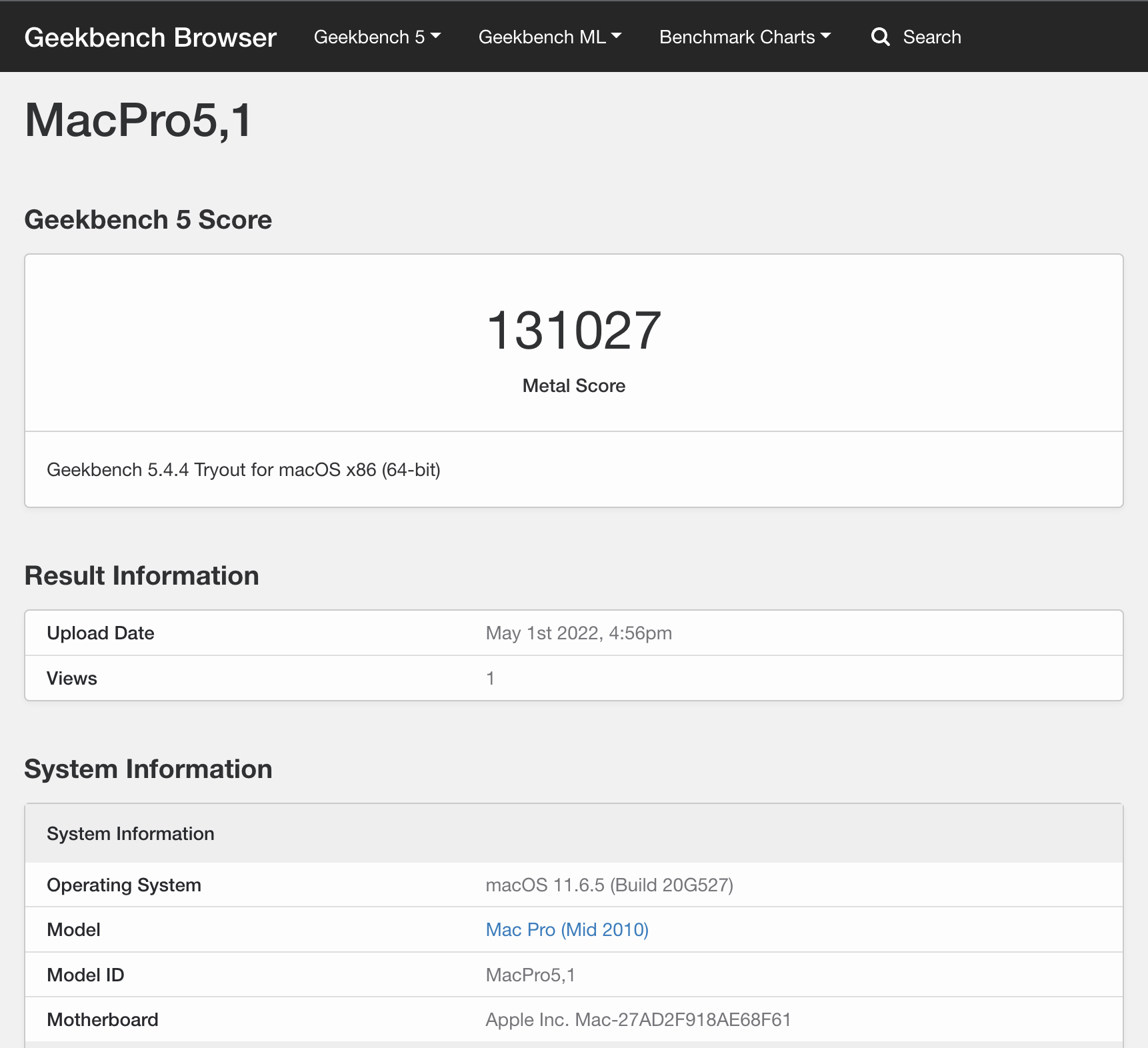

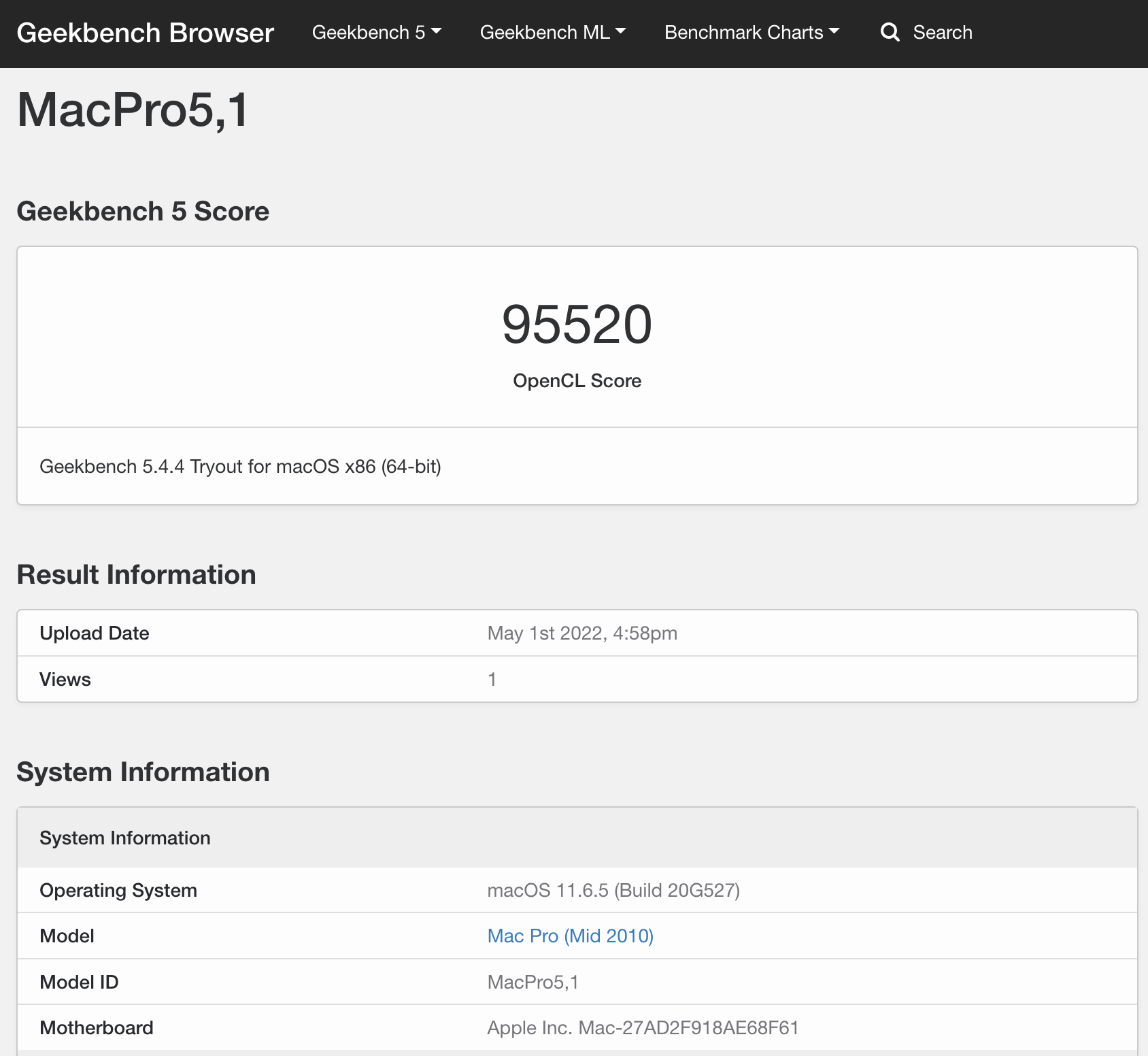

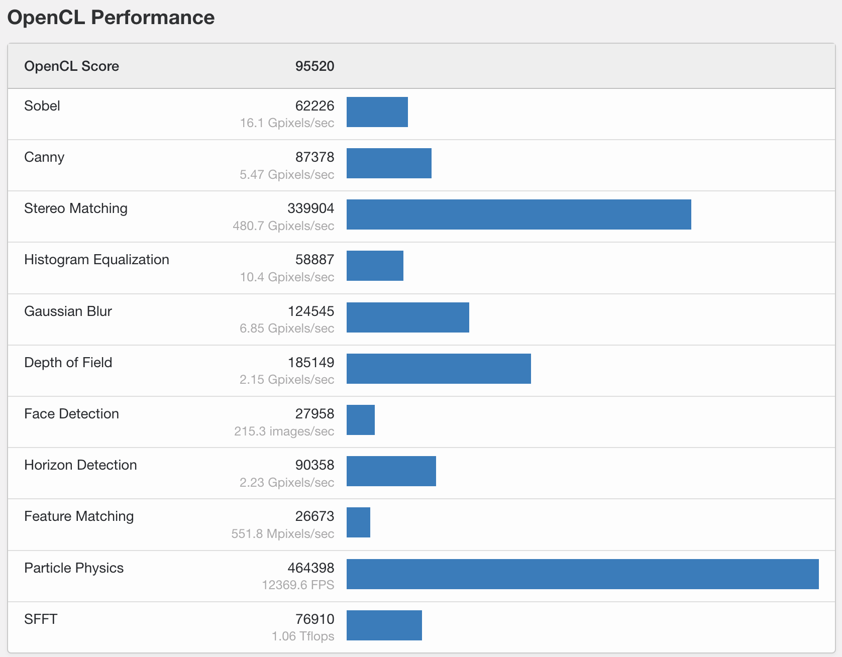

The day I installed it (May 1st), I ran some quick benchmarks:

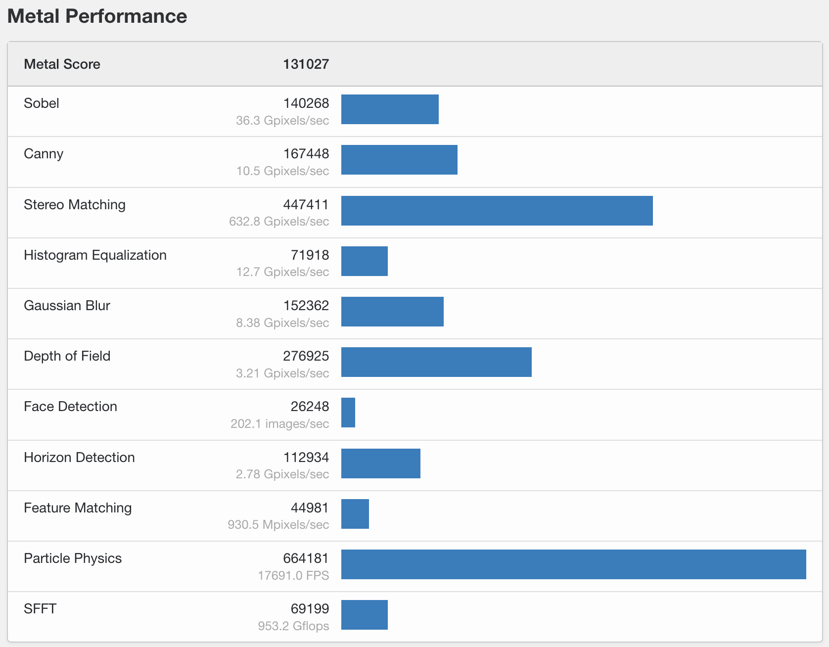

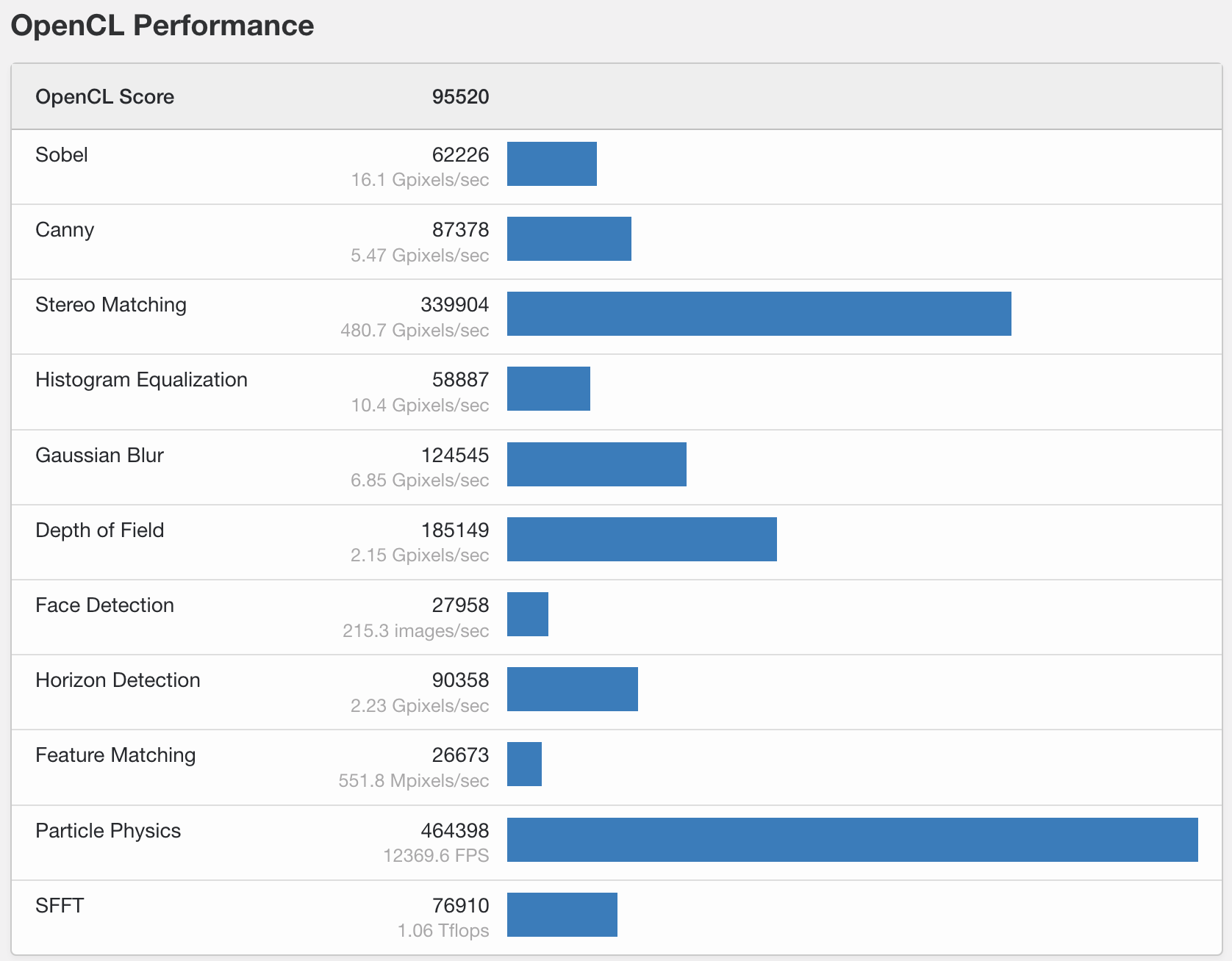

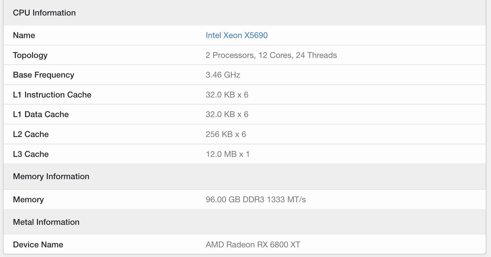

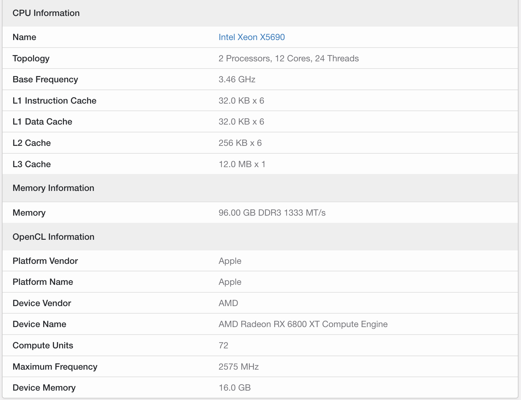

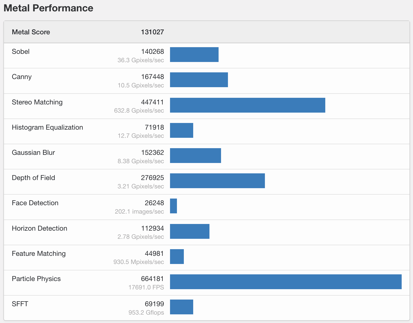

I made a GB5 account a few days later, so here are more results:
And of course Windows:
As you can see from the various benchmarks, the cMP now easily DECIMATES the 20-core Ultra Mac Studio in terms of graphics processing power. Just had to put that out there as I'm tired of reading BS posts from iSheep around that.
I ran a bunch of different benchmarks in the 6800XT thread, so if you're interested in that, take a look beginning on page 39.
Again, just wanted to put this here, so that it gets the visibility that it deserves. This proves that, thanks to the brilliant work by members of this community, our cMP's are STILL very powerful and capable machines, even 12 years down the line. I want to thank you guys, especially Syncretic, and the OpenCore team for keeping this very capable machine, still purring like a kitten!
Cheers!

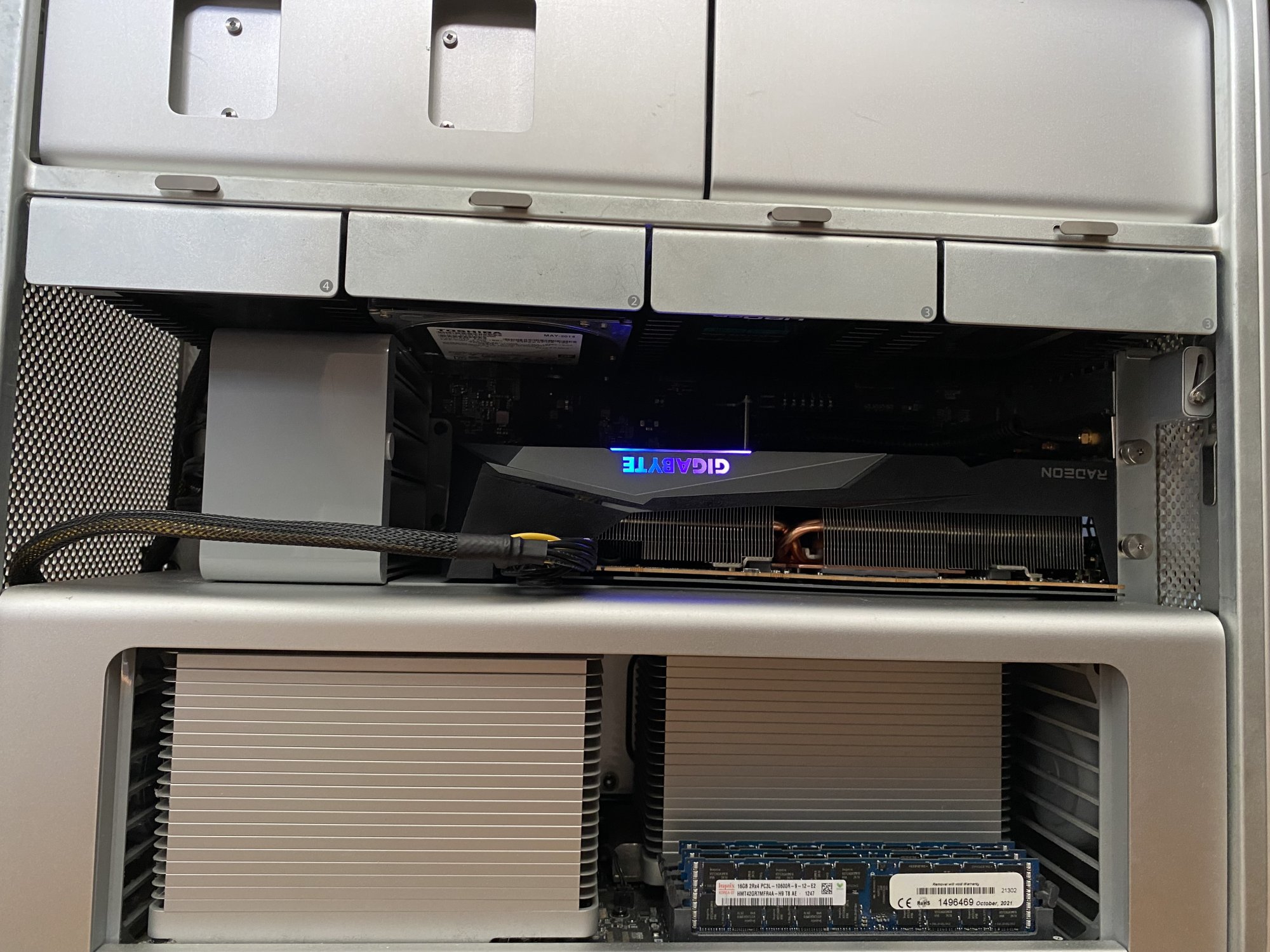

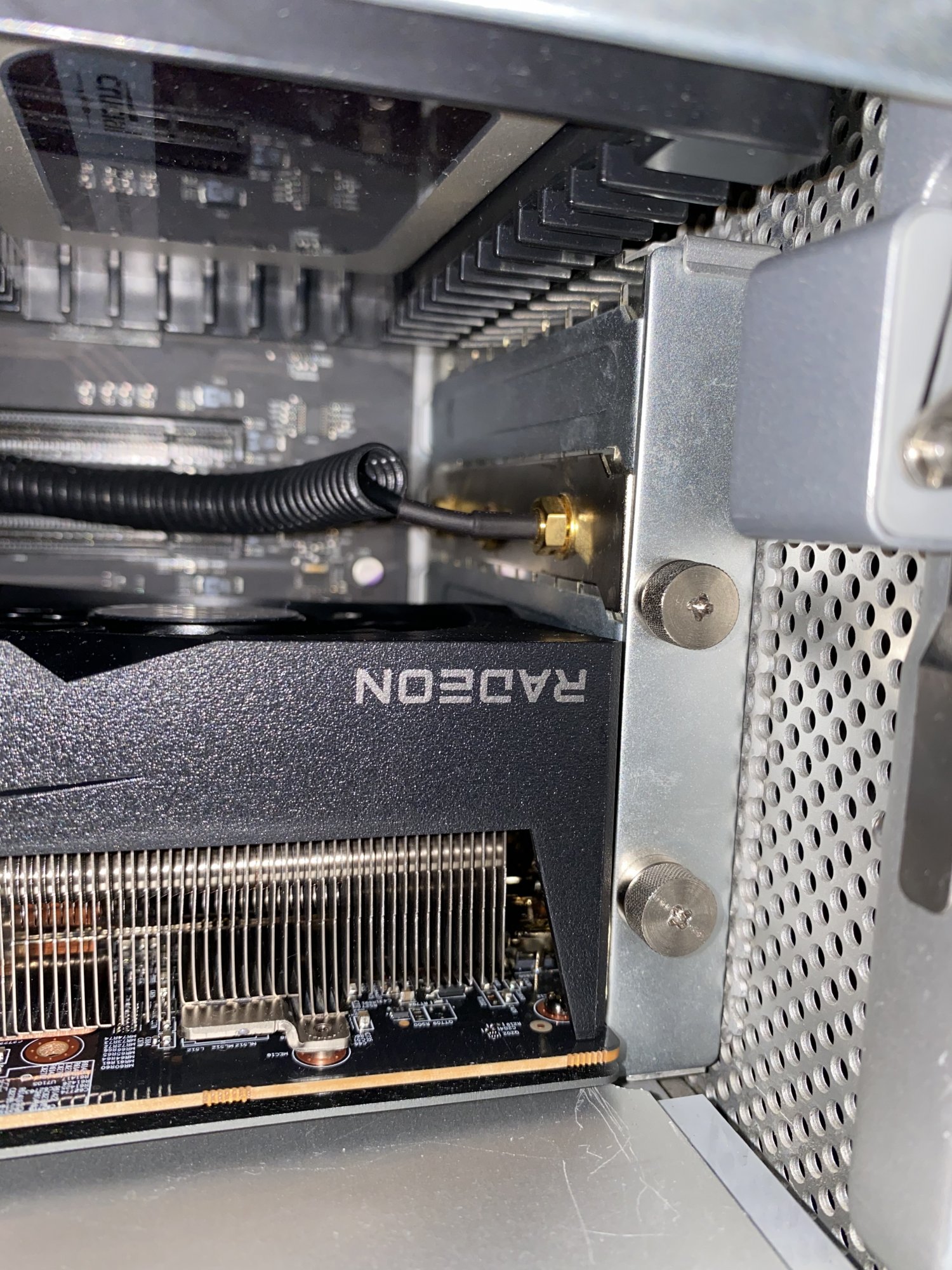

@prefuse07 is your 6800 xt , 2-slot, 2.5-slot or 3-slot?
I just realized 6800 is 2-slot but 6800 xt reference is 2.5-slot. So I am not sure I can run my PCIe NVMe card in slot 2 if I were to get a 6800 xt.

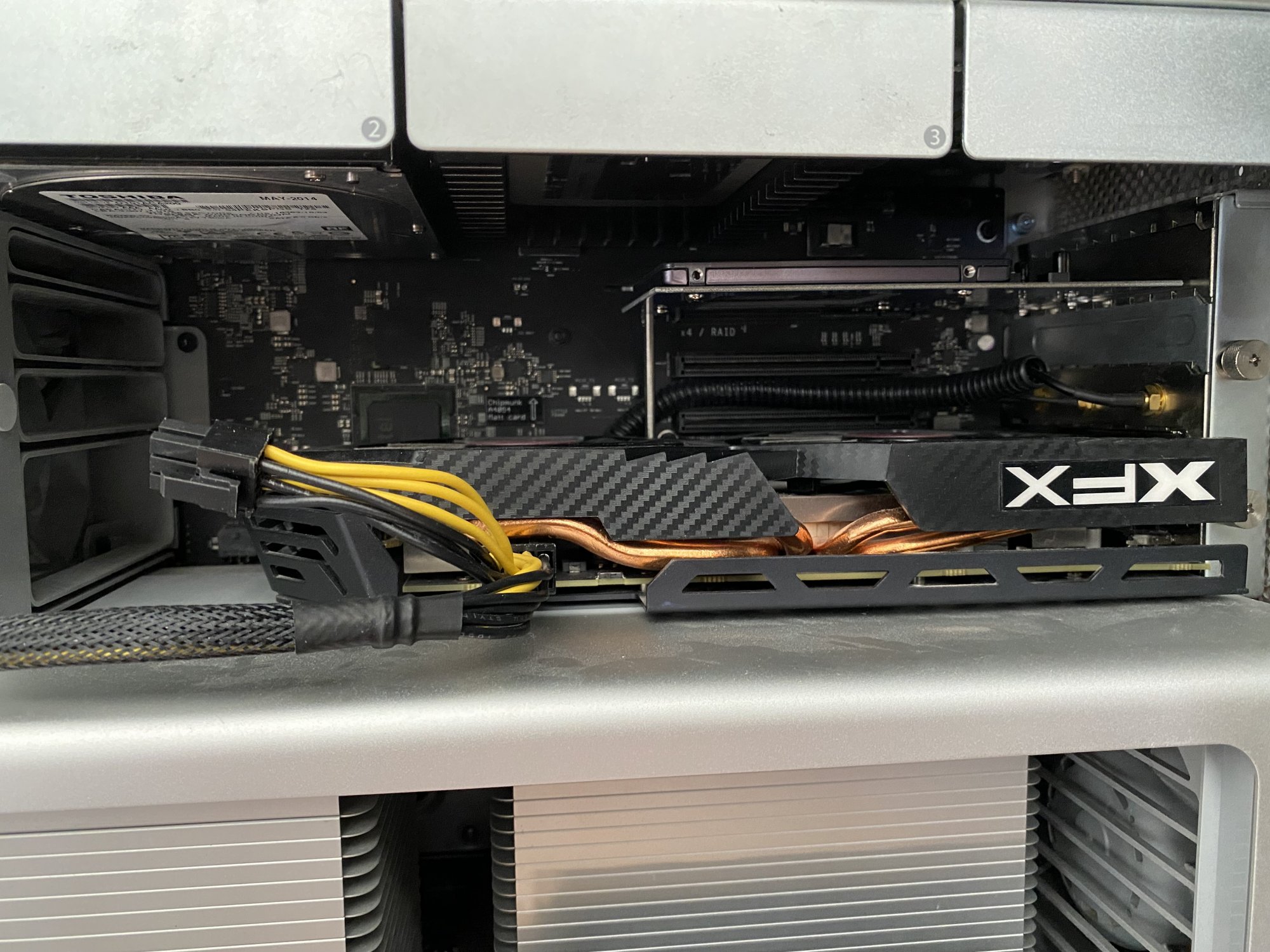

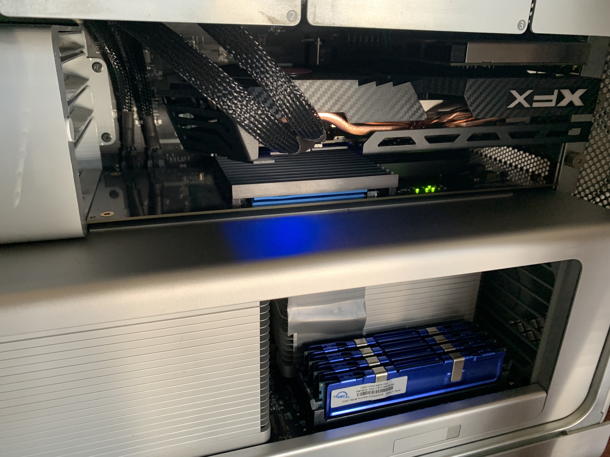

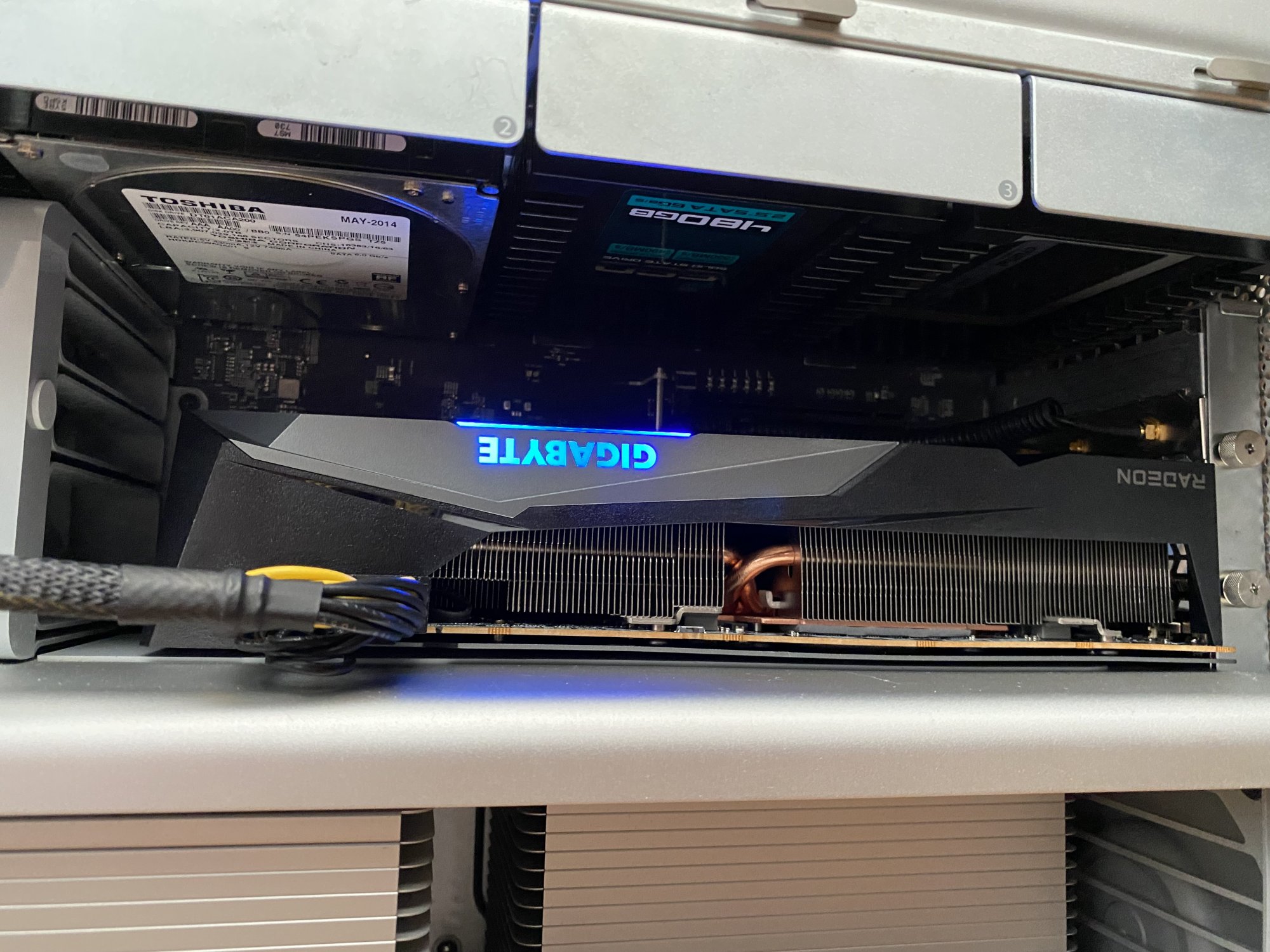

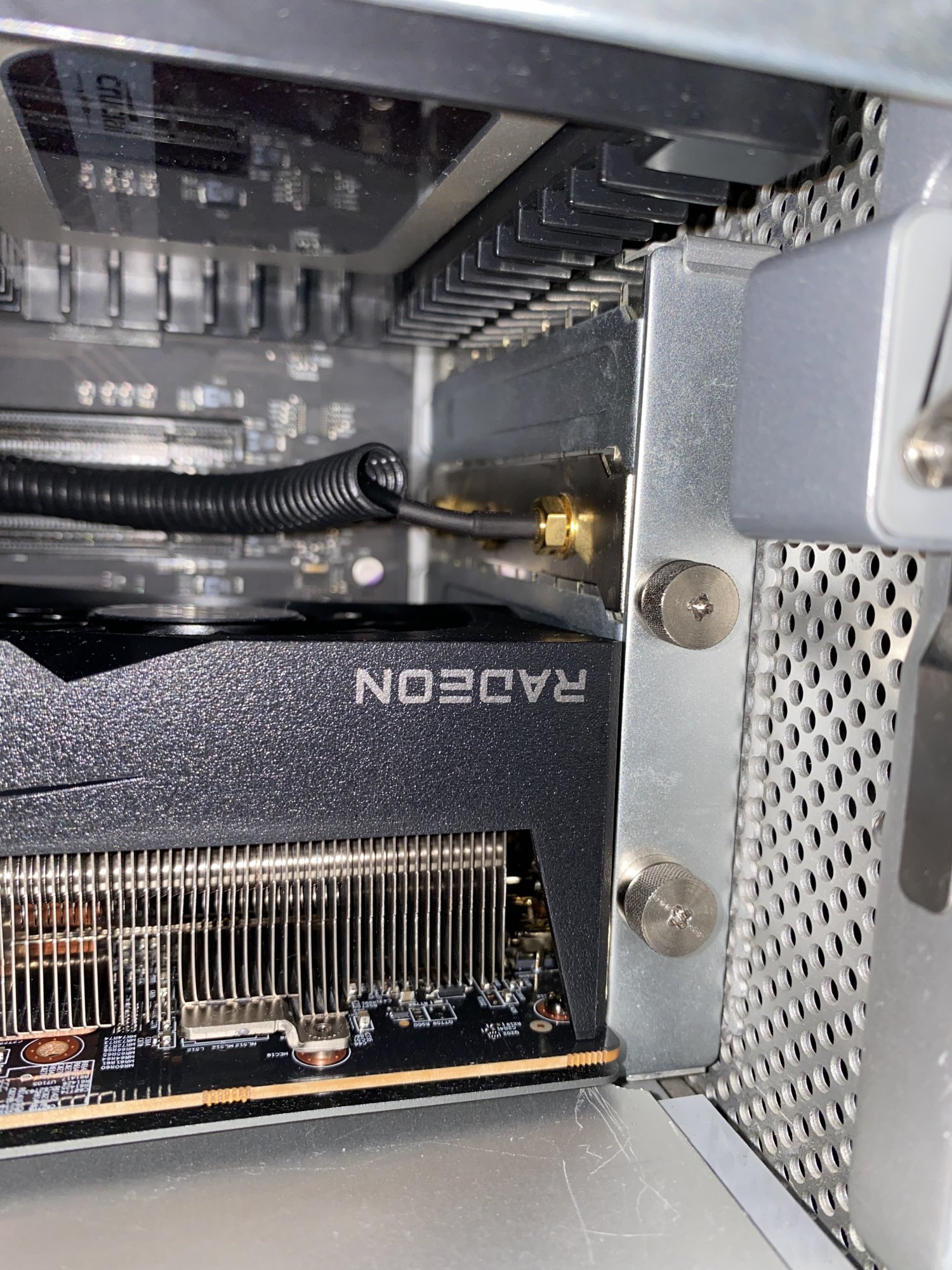

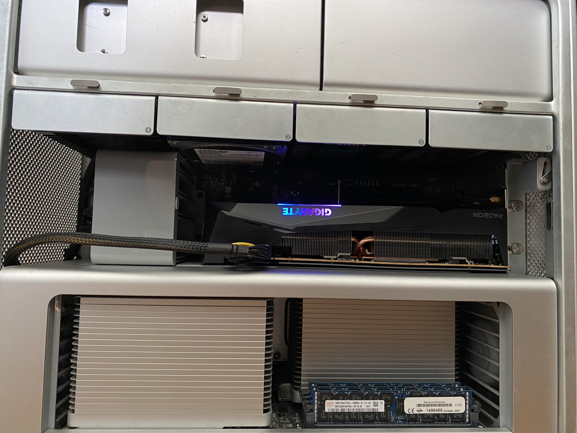

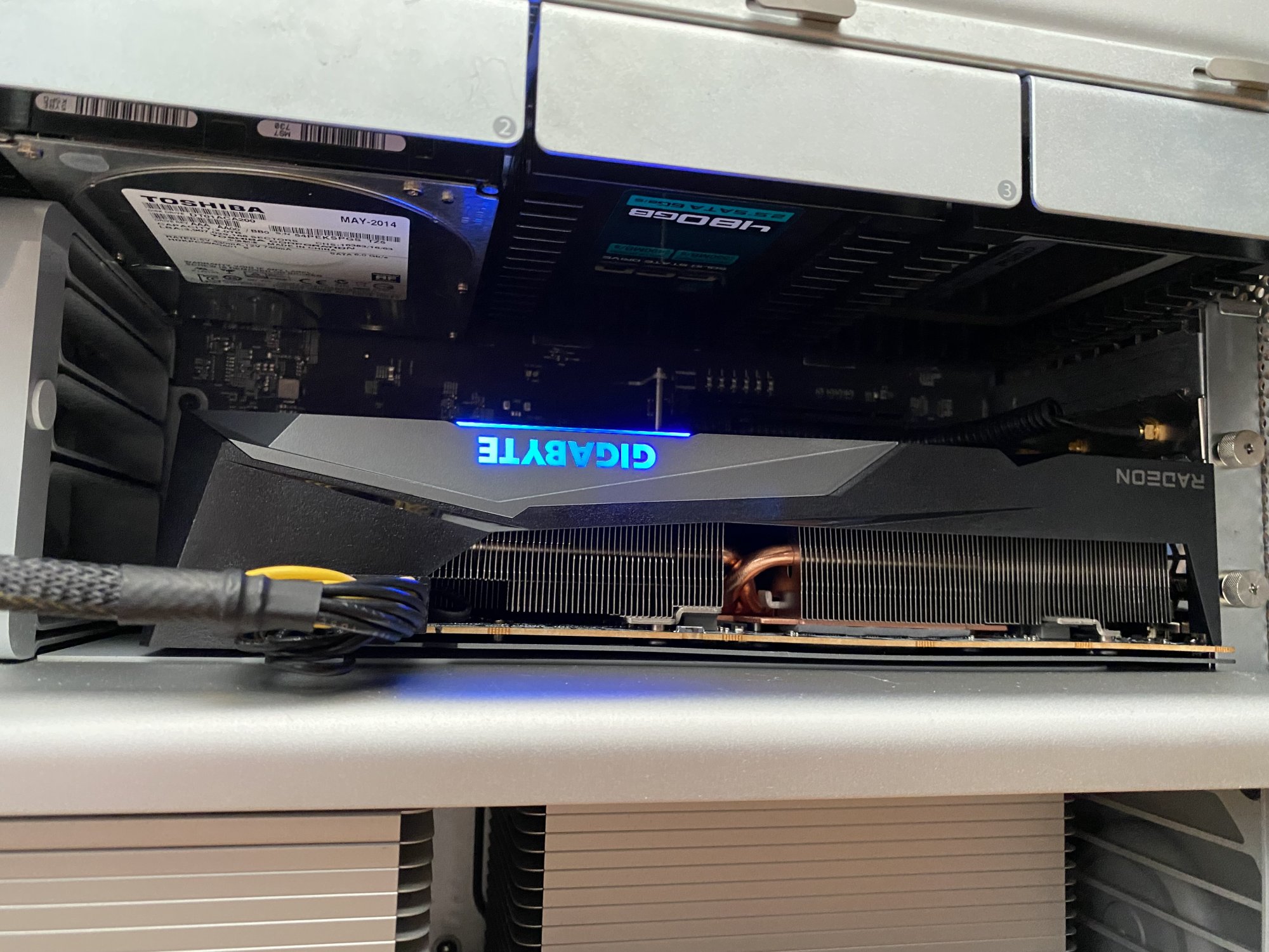

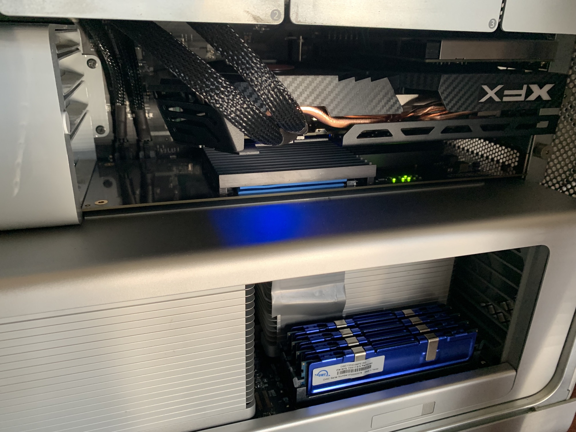

It takes up 3 slots on the cMP:
I used to have an SSD sitting in an OWC PCIe adapter sitting in Slot 4, but I moved it into the SATA bays, and moved my bluetooth/wifi antennas up a notch, as you see in the pic.
Maybe time for a PCIe NMVe.2 card and blade on your cMP, even in slot 4 would give you about x3 times speed of your 2.5" SSD, very beneficial for games and more... 🙂
As you can see from the various benchmarks, the cMP now easily DECIMATES the 20-core Ultra Mac Studio. Just had to put that out there as I'm tired of reading BS posts from iSheep around that.
This will cause difficulties for me if I were to try it, I have a Sonnet NVME sled in the #1 slot, RX580 currently in #2 slot and #4 slot has the mandatory Gigabyte Titan Ridge thunderbolt:
So for anyone thinking of this, be mindful of the above. The sonnet still runs quite fast in #3 slot.

Yeah, you'd also have to be very careful with which RX-6800XT you choose, as the majority of them are too long to fit into the cMP without having to disconnect the fan! (same goes for the 6900XT). Even more-so with how many things you've got in there!
Maybe stick to reliable 4,1/5,1 then...! Forever! 😉
I like your enthusiasm for the cMP, but a lot of 3rd party GPUs have had serious issues in the cMP. The GPUs in this thread didn't even work before someone made a patch. I think GPU compatibility will be less problematic with the 7,1. As time passes the 7,1 will become very cheap, so no reason to keep cMP forever.
Off topic, but did you buy that WiFi/Bluetooth antenna extender? Something like that would really cleanup my setup, but wasn’t finding anything with a quick search.
Most of the size is probably just the cooler and it would probably benefit from adding a water cooling solution to take it down to two slots.

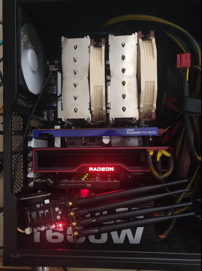

The size is a real killer for my PC:
As you can see the reference RX6900XT occupies 3 slots. What is even worst is if I install a 2 slot reference card in the first PCIE slot it almost touches the 6900XT. That is why I had to go with a single slot card. Also see how am I running the wifi/BT card? I will most probably rearrange everything with my PCIE expander chassis. Even with PCIE2 it has 80GB bandwidth and it is better than any thunderbolt (40GB only).
