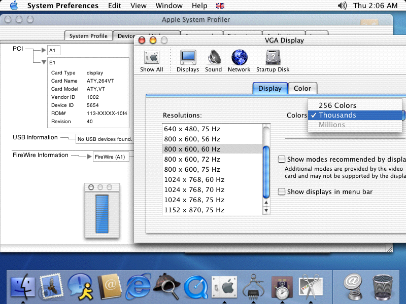

I am very pleased to be bringing you guys and girls this about this Macintosh shot 😀
after over a year at hacking away at it I have finally gotten OS X to boot on the Power Macintosh 4400! 😀 its not Tiger no, but its amazing to see any form of OS X boot on the 4400, and man what a complicated journey it was to get here
the long and the short of it is, the onboard ATA controller does not play ball with OS X at all and causes OS X to stall very early on in the boot, to get around this I had to nuke those drivers from OS X and figure out how to Boot OS X from another volume not attached to the ATA bus, in the end using the tools I had available to me, I settled on using xpostfacto with a CF card on the 4400s ATA bus as a helper volume, so I could actually boot the OS X kernel from OpenFirmware, then I had my Pismo in target disk mode also running 10.2.8 plugged in via a PCI Firewire card where I then had it setup to tell OS X to use the Pismo as the root device so then it would find the Pismo (as OS Xs Firewire drivers are good LOL) and then switch to booting from that basically and bingo it booted up (rather slowly) to a (very slugish) desktop woo! 😀 if I had a nice PCI SATA or ATA card that did play nice with the 4400s OpenFirmware then I could avoid having to use the Pismo in TDM, but I do not have such a card sadly (sadly not only is my firmtek flashed SATA card incompatible with 10.2.x as a whole. it also will not boot OS X from open firmware on a 4400 the, card works fine in the 4400 under Mac OS 7-9.1 however 🙂 )
Ill say OS X 10.2.8 is very slow on the 4400, you can watch the windows being drawn in real time as it builds up all the quartz elements LOL kinda cool actually seeing how its all rendered. im planning on throwing a Radeon 9200 in here and seeing how that fairs, but im pretty sure everything is VERY CPU bound, as just moving the mouse curser pegs the CPU for example 😀 right now its running off of the 4400s built in ATI 264VT Graphics chip, which does actually have some driver support in OS X (its how im able to get proper rez and colour depth control) no 3D or anything like that in OS X however. it says VGA display as im using a DB15 to VGA adapter with it connected to my HP w19ev test monitor, I do have a multiple scan 14 that came bundled with the 4400 but its packed away in storage atm. if i drop the Rez low enough i can get millions of colours out of this thing 🙂 it only has about 1MB of VRAM installed IIRC, its in an upgrade slot so it can be upgraded to increase the colour depth at higher resolutions for example.
I hope this makes sense and is interesting to the members on this forum, its quite a big achievement for me, especially as its taken me over a year to finally get OS X to boot on this 4400, and its the first time I have seen anyone boot any form of OS X on an actual 4400 🙂
it is really a shame I cant run anything newer then 10.2.8 on here due to the Xpostfacto BootX incompatibilities that prevent tiger from booting at all that you can read a bit about in the posts before this one, I might be able to boot panther however, but ill have to figure out how to patch and compile its kernel first so it works on the 603ev 😀
ill keep you updated as I play with this some more 🙂 I should of probably made this its own thread on the forum... oh well 😀

Yes! This is an amazing achievement for Apple’s little Tanzania outcast of the 90s. Who would have ever thought it could boot OS X!? I honestly wish I never sold mine. I had one (a regional model 7220/200) maxed out with 160MB RAM, a 3dfx Voodoo(3?) PCI GPU, 40GB 7200rpm WD HDD and a Sonnet Crescendo L2 G3/400Mhz/1MB upgrade card.
Does your 4400 have it’s L2 cache card installed? The onboard ATi Mach64 was configurable to 2MB VRAM if you can find a module. It does provide 2D acceleration for Mac OS and Linux/X11, perhaps there is a way to activate this on OSX. Panther would likely redraw quicker than Jag.

sounds like you had quite the maxed out 4400 🙂 I have a love hate relationship with mine, its such a buggy machine its unreal 🙄 indeed I have found 10.2.8 to be quite slow in general, and that 10.4 tends to run better on the same hardware. (running 10.2.8 on a G5 is fun tho throwing way more power and ram at it then it can shake a stick at 😀 )
My 4400 does not have any sort of L2 cache/L2 cache upgrade installed, which is probably part of the reason why it runs so slow 🙂 (Sadly the G3 L2 cache slot upgrade cards do not work in OS X)
in regards to its onboard Graphics chip, the oldest chip to have any sort of more than basic frame buffer support would be the Rage Pro, does have some basic 2D rendering in OS X but nothing 3D like OpenGL (there was a lawsuit in regards to this actually, over the G3 beige not having full acceleration in OS X) you can see the RagePro.kext and RageProGA.bundle in the extensions folder, but anything older than the Rage Pro, like the ATI 264VT mach64 in the Power Mac 4400 only has basic NDRV support theres no Graphics acceleration kexts for it of any kind in OS X. the ATI 264VT does however support 3D in the form Rave in classic Mac OS IIRC, but it does not support OpenGL. (the Rage Pro in OS 9 does do OpenGL)
speaking of Graphics chips, I did test out a Radeon 9200 PCI Mac edition, OS X boots fine with it and the GUI does run a bit smoother, and of course I was able to properly drive my monitor, however enabling QE actually caused a slow down LOL poor PCI bus cant handle it at all 😀 (I was expecting it to crash and burn at some point with the Radeon 9200, the Firewire card, and a 10BaseT ethernet card I ended up installing LOL)

a couple things I forgot to mention in my original post, sound does not seem to work from the internal speaker, ill have to plug in some headphones and see if it works there, but going into system preferences only shows 1 output device..
OS X does detect the serial ports and I think onboard SCSI is working too but I do not have any SCSI or serial devices on hand to test this with (well I have other computers with serial and SCSI ports, but I need to acquire a suitable cable first, im planning to use the DB9 RS232/422 serial port on my Xserve to get my SE connected to the internet 🙂 )
