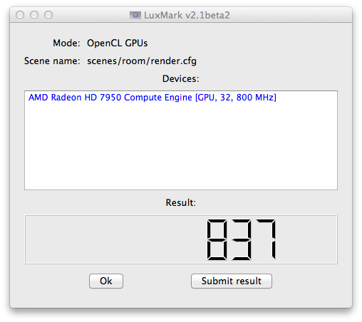

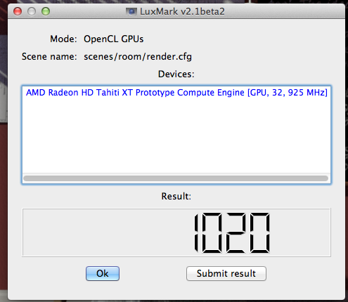

It read the 7970 just fine, comes up as a 7xxx series card. Then I ran LuxMark Room. My previous Nvidia GT640 ran a 77 on the room, so I was betting this would do a little better... well...
Now that's fast. I'll keep reporting back with issues and such if they crop up. I'm curious to see how Photoshop handles the hardware. The expansion slot fan acted up a bit at first, but it is running smoothly at 800RPM now. The GPU temps are incorrect, heat monitor is reporting 85C at all times which is obviously not right. Maybe an SMC reset will fix it or it may just be an artifact of the beta drivers. Hopefully we see even better support as we approach the Mac Pro refresh.

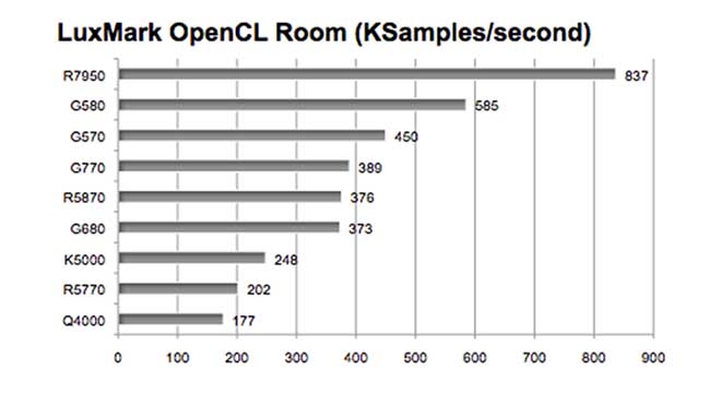

That is lightening fast, but not totally unexpected for the new Radeon 7900 series of cards. Bear Feats just tested some GPUs, and the R7950, Mac Edition did very well in that test:
My flashed upclocked GTX570 only does 461.
http://www.barefeats.com/gpuup.html

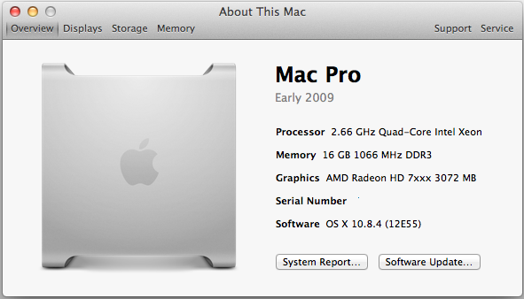

MacPro 3,1 with 7970

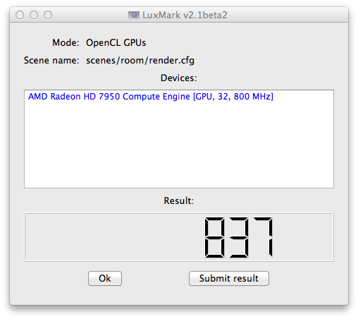

Interesting 🙂 First time I've run this test.

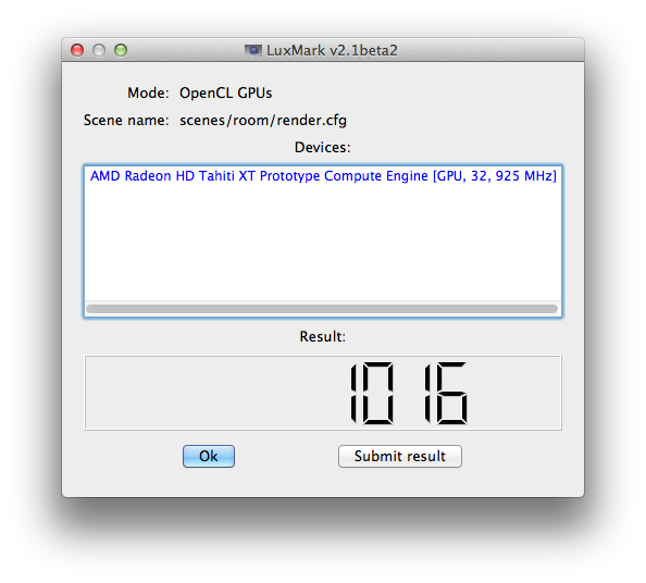

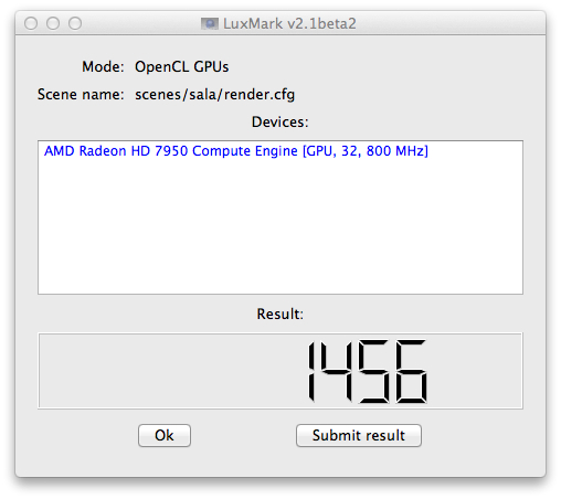

I don't know how but i got better result with my sapphire radeon 7950 mac edition?
You've used different scene. Use room if you want to compare score with OP's card.
Don't worry, only in Luxmark. Its code is highly optimized for AMD 7xxx series.

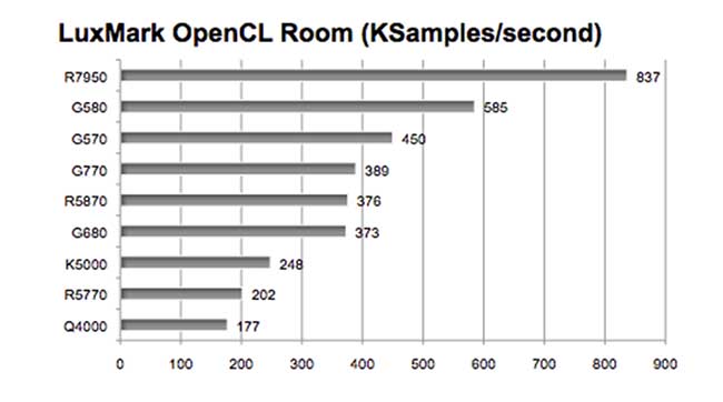

Yes you were right. Here's the result with same scene.
