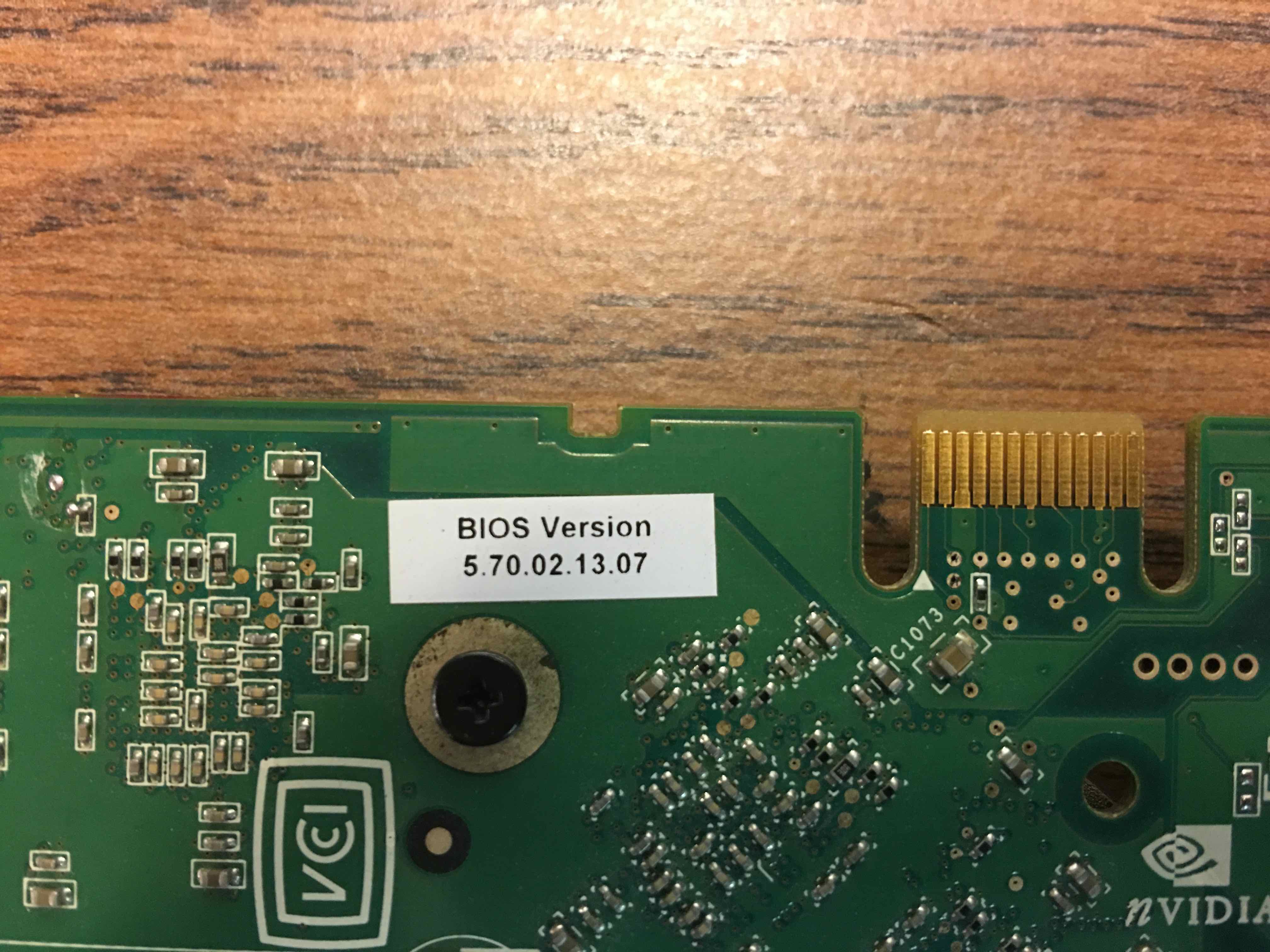

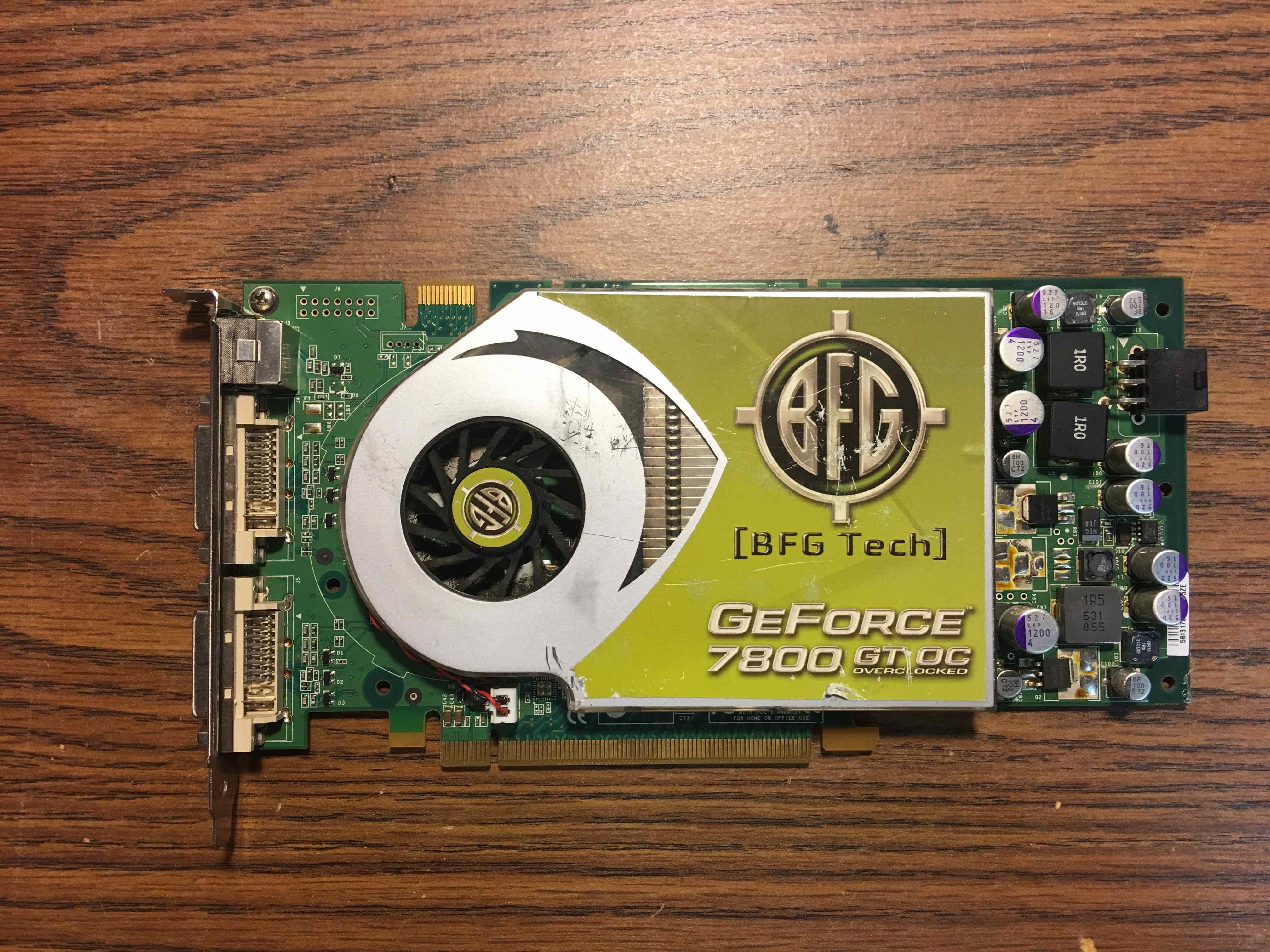

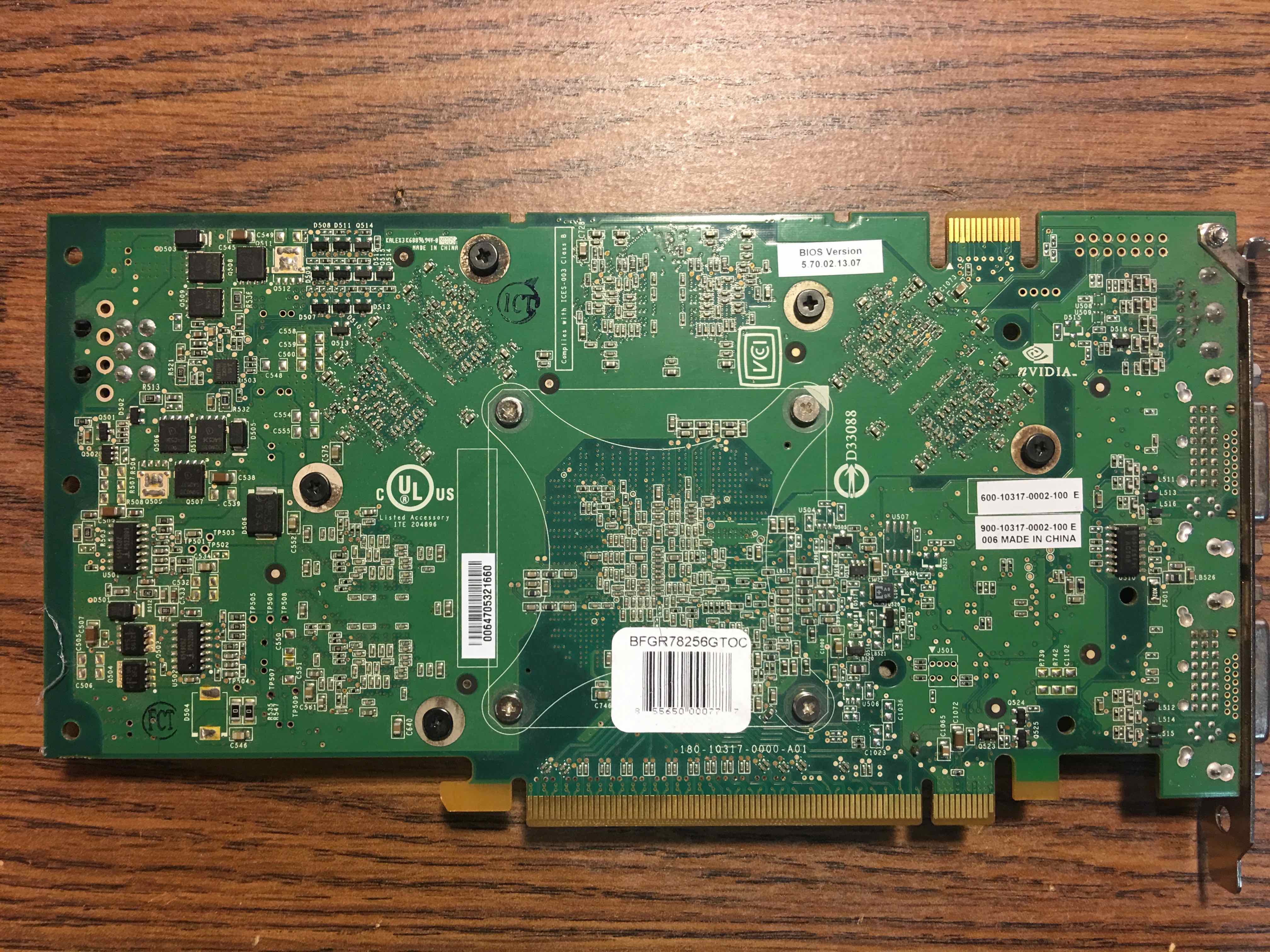

I've attached pictures of the card I did this on. This procedure might not work on all cards.
