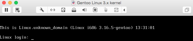

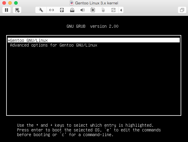

After probably about 16 hours of work (with some sleep involved too), I finally got a working VM of Linux Gentoo running. Thank God for Snapshots in VMware. I took several several Snapshots at key points during the build and they came in quite useful when I'd screwed something up.
Late last night when I got to the part where I had to build and compile the kernel and then wait, I ended up falling asleep on the couch until I awoke at 3am. Then I went to bed and picked up work today around 10am. Now it's all done.
I don't really know what I will do with it. I only built it to see if I could and to practice on Linux and learn some command line stuff. That's why I chose Gentoo because it's all command line, and tough for a newbie like me.
Now, I wonder if I can copy the VM, made in Fusion 7 to my VSphere environment at the office...

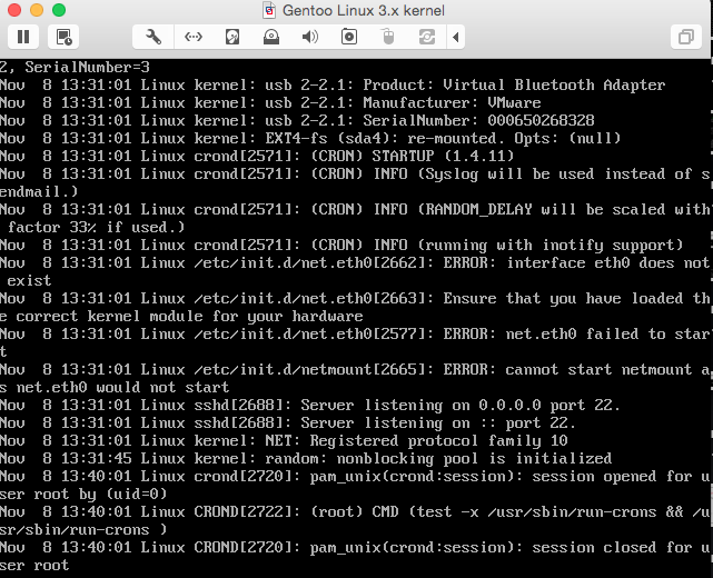

I do have one issue that I need to figure out. Because it's in a VM and you have to press Control + Command to release the cursor from Linux back to OS X, when pressing the Command button Linux displays a bunch of info and I don't know how to get back to a working prompt. I can type stuff in but nothing happens.
The only way to get back is to reboot it either by pressing control + alt + delete or restart from VMware controls.
I didn't have this issue throughout the install process at all on the LiveCD (or actually ISO). Just when I am booted into the final product does this happen.

The only issue I have so far is in post #2. Pressing the Command button makes the OS display odd stuff and I can't get back to a useable prompt - have to reboot it.
I press the command button + control to release the cursor back to OS X.

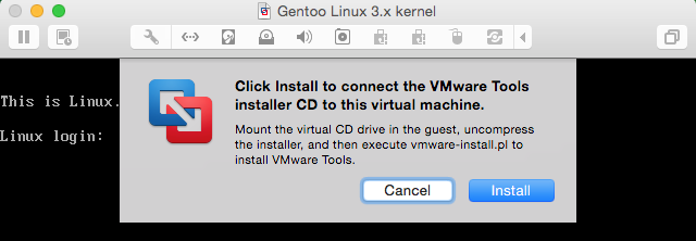

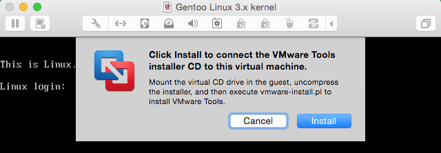

Did you try installing the VMware tools for Linux. I was able to do that for Ubuntu and that removed the need to hit the cmd key. I'm not sure if the distro you're using will be compatible with the vmware tools.
I have not tried that yet, for the same reason; I'm not sure if it will work or not. But, I will give it a whirl and see what happens.
I did update VMware the other day to the latest version and there were some updates for Linux included.
I'm not really sure how to do this in Gentoo.

Did you try pressing enter?
If that doesn't work just bring up a different TTY. Use f1 - f6 to change between them.

I run several gentoos (for database servers) in VMWF7. First rule, never run the console in full screen, just leave it as a window. When you navigate away, it usually goes dark. To get back in, click in the window, giving "focus" to the VM, then hit return, you can also hit ctrl-d, which is a "non-killing" unix stop command.
