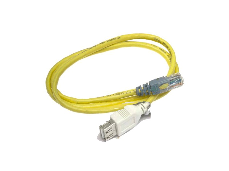

hey all... just thinking, can i make my printer/usb external plug into my router with a cable like this? (btw, my router does not have a usb port)
what i am suggesting is a ethernet cable whos end is a female usb port? such thing? can i make it?
any help appreciated
heres a graphic

You cannot just make one of those cables: the USB end has some circuitry in it to present the device as the correct type to the OS and to turn the USB signals into Ethernet. This is non-trivial.
If you were to buy one of these cables it would not make your printer network accessible unless:
1) The printer has drivers for this USB device. This is very unlikely as both the printer and this cable are "client" devices relying on a Mac or PC for the "host" part of the USB protocol.
AND one of:
1) The cable contains enough circuitry and logic to act as a network print-server. This is highly unlikely.
2) The printer already has a print-server built in and is willing to use that network print server over USB. This is also highly unlikely as if the printer had a print-server it would have an ethernet port and we'd not be having this discussion.
So in short: no chance, you need a (more expensive) USB network print server. For example something like this. Note I have no idea if it's any good: it was the first Google result!
