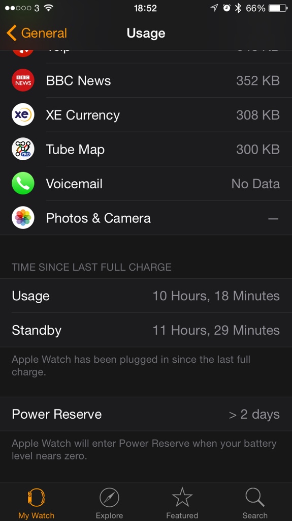

I too, have had this today. Had it since launch, today is the first day. Usually I get home with 70% left, today, not the case!! I've not had any new apps. Checked the usage, it claims it's been almost solidly in use since unplugging this morning, but I've been at work, so I've not been constantly using it.
