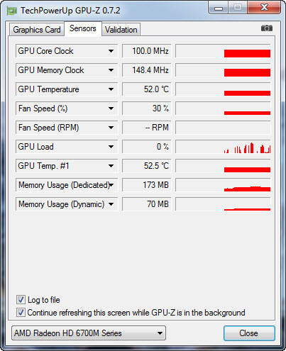

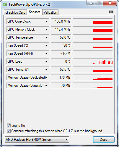

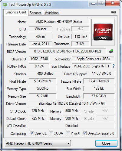

I just tried running Batman Arkham City on OS X and did a Benchmark. The average fps was 11, so same problem again. I tried Dirt 3 on Bootcamp, it also ran extremely slow even after installing the drivers. Strangely enough the GPU load is not 100% when idle in Bootcamp, while in OS X it is 100% when idle. I uploaded some screenshots of GPU-Z, maybe it shows something.
Well, it sounds like it could certainly be a faulty graphics card/logic board. Is it under warranty? Either way, take it into an authorized service provider and get them to check it out.
