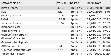

I believe it was working for the last time just before 29 Jan.
And, on 29th, there were Security Updates installed:

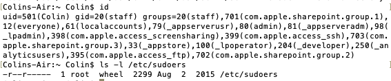

Are the user and group IDs set correctly? → id (should include “80(admin)”)
Does the sudoers file have to correct permissions? → ls -l /etc/sudoers (should be “-r--r----- 1 root wheel”)

This is what I see for Id and permissions:
So, permissions seem ok...
Id includes 80(admin).
I compared the results with those of my partner's Mac (same model with Mojave).
On her machine, sudo works okay.
The only difference I see is that I have :
701(com.apple.sharepoint.group.1)​
702(com.apple.sharepoint.group.2)​
703(com.apple.sharepoint.group.3)​
and she has:
703(com.apple.sharepoint.group.2)​
A bit strange maybe that her sharepoint groups are 1 with 701 and 2 with 703, and not with 702.
So, unless this changes something, it looks like we all agree, a reinstall is the way to go.
