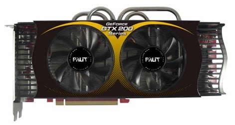

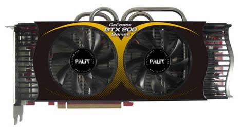

Nice windup grue. My PC 285 has been chugging away for weeks in a Pro with an 8800 and the sys remains cool. I do have 285 card with two fans and cooling pipes and I am sure the system will explode without all this. Looks like a Mac Pro Turbo with the side of the case off.
