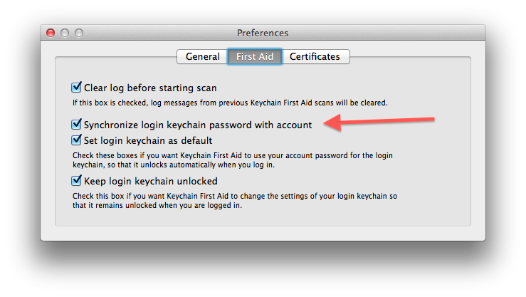

Any advantage of using any of the 3rd party apps if it's built into OS X? Also can you have a separate password from Logging in and Keychain?
I've never seen much of an advantage other than the tracking across multiple devices with offerings like 1password, and even that it changing with Mavericks / iOS7. Keychain has strong encryption (still haven't seen mention of it being cracked), secure notes, a password suggestion tool, etc.
The login password / keychain password sync is enabled by default but can be turned off in Keychain Access > Preferences > First Aid by deselecting synchronize login keychain with account, see attachment for reference. You can then change the keychain password to something stronger. Alternately you can leave the login keychain alone and create a new keychain, with a different password, to store sensitive info.
Yes, you can. Just go to Keychain prefs and tell it not to sync the login PW with Keychain, then change the Keychain PW to something different.
