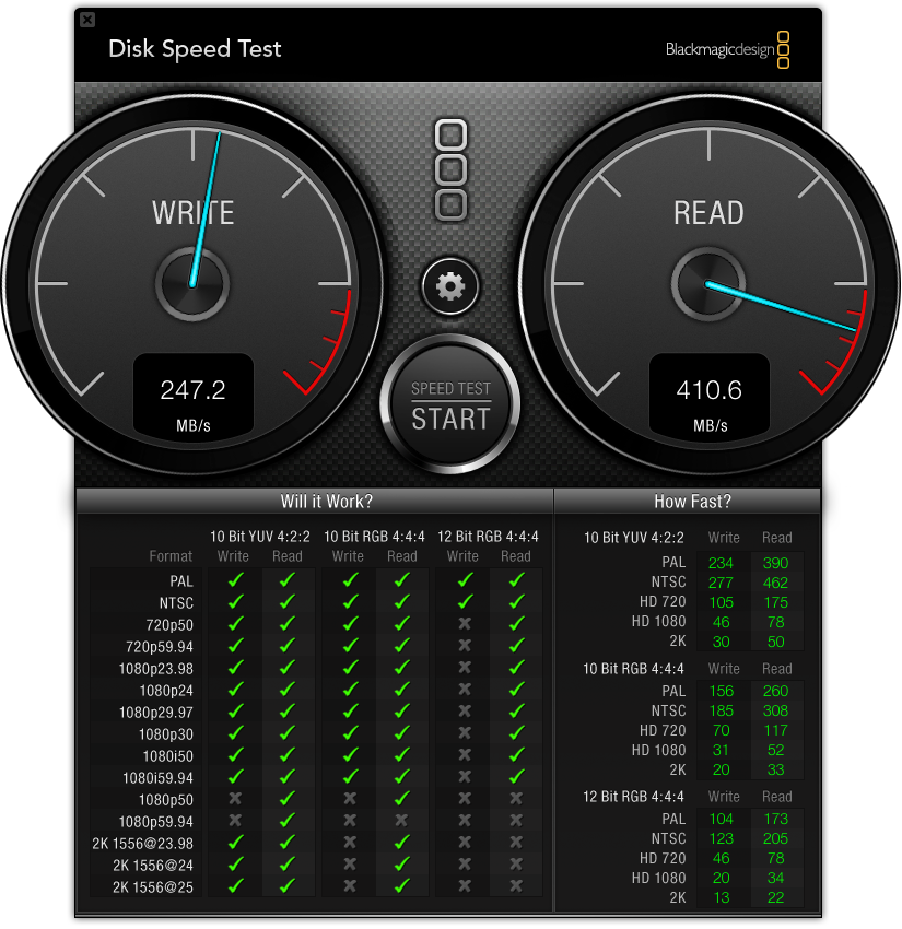

Here's the report that "BlackMagic" gives me for an Intel 520 series SSD in the Plugable dock I mentioned above:
