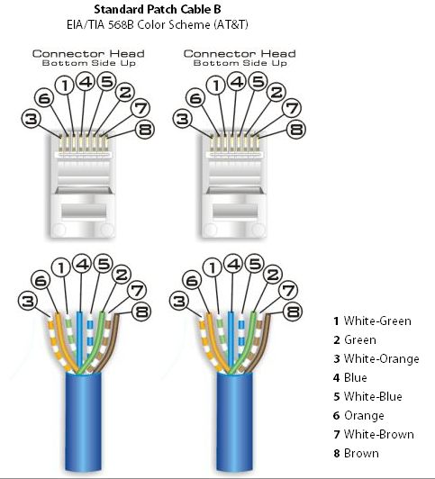

I bought a drill bit big enough for the cable to go through, but it means I need to cut the ends off. Is re-crimping (provided I can get a cheap crimper and ends) difficult? And I'm really not sure what the difference is between crossover and patching. I've looked online, but still unsure. What kind of wiring should I do if I'm just connecting my airport express up to another router thats connected to the modem?
Crimping ethernet cable is pretty simple. All you need is the correct tools.
If your connecting two pieces of network gear together - you would need to make a patch cable (both ends of the cable are pinned out alike). If you're going to connect two computers together without a router, a crossover cable is used (the two ends of the cable are pinned out reversed). Also of note is that more modern NIC don't require crossover cables since they are auto sensing.
You setup would require patch cables.
It would be best to follow a standard diagram (see attached) when making your cables. In reality, however, as long as you connect the wires in the same order for both ends of the cable, it will work just fine.
I've purchased crimping tools and ends at Menard's and they are pretty cheep. They have more than one brand of crimping equipment - a more professional grade brand and then a more DIY level that's cheeper. I'd just get the DIY stuff since you won't be using it everyday.
