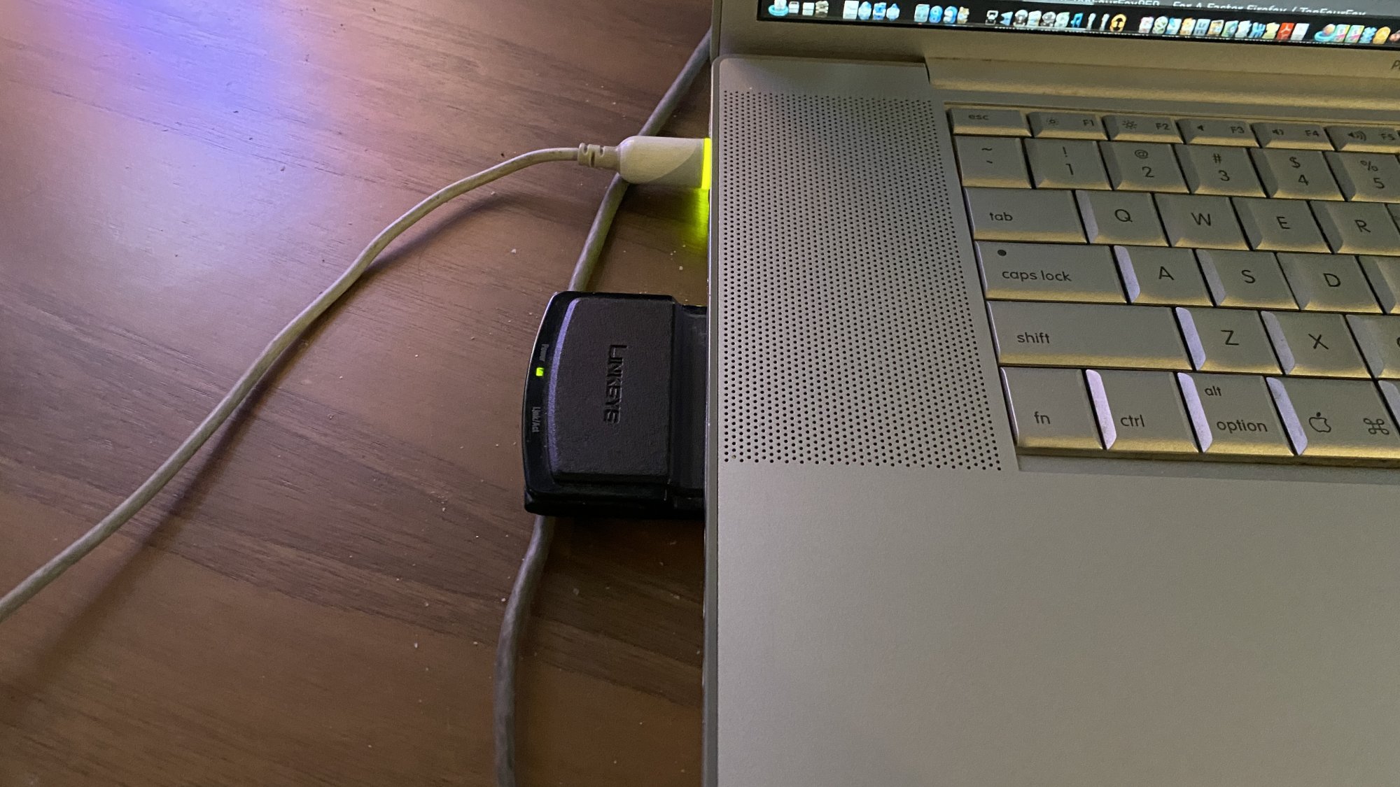

Give a WPC600N a try. It’s what I use in my 17-inch PB, which I’ve used to connect successfully at coffee shops.

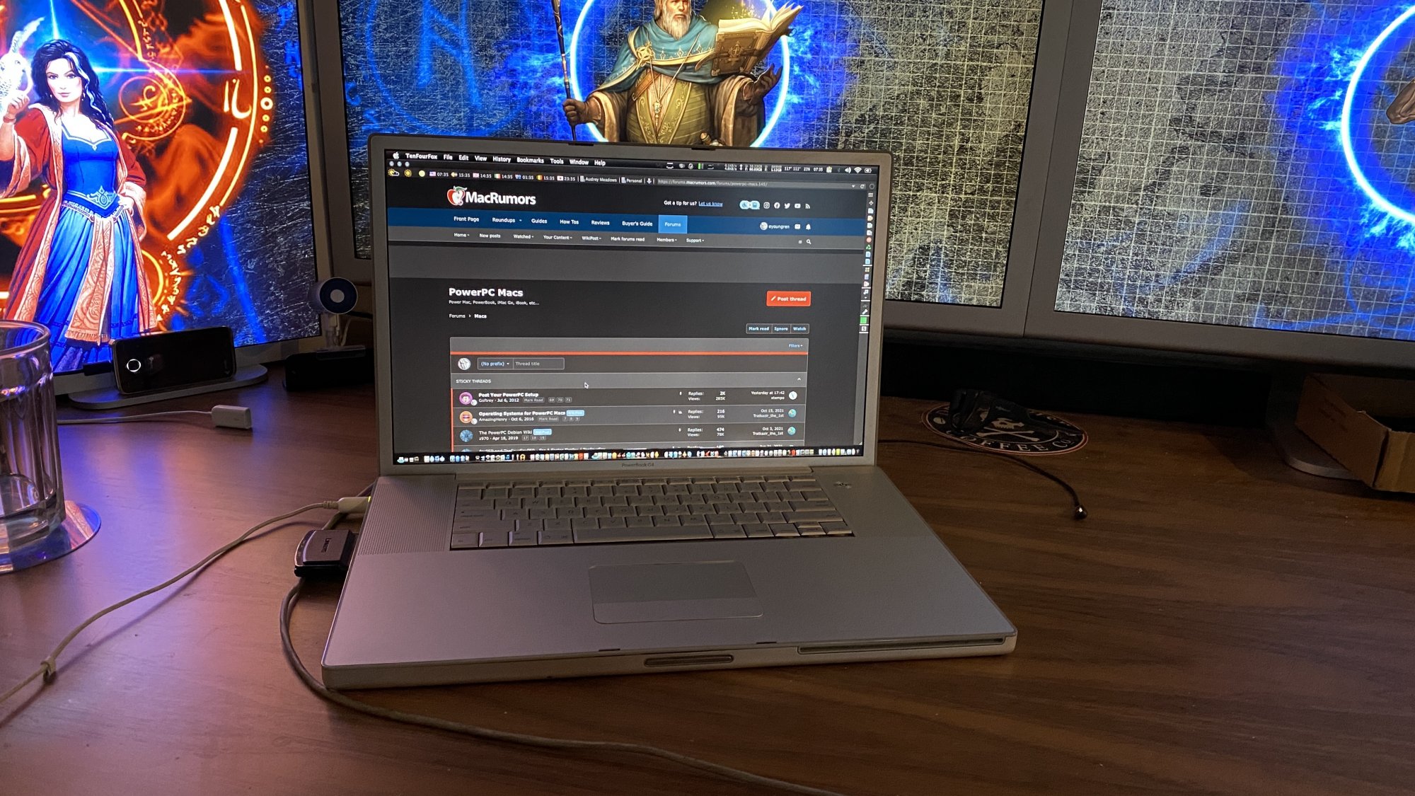

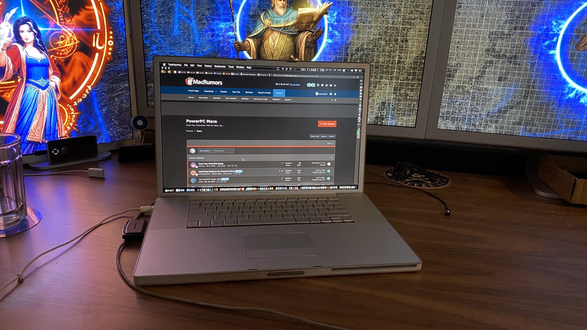

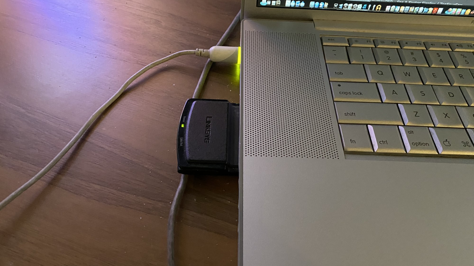

Well, that was fast. I have a tracking number. :D
Do you get faster performance with this card? I searched it and it seems it’s an N spec card that’s also dual band.
I use ethernet most the time on my PowerBook’s because the airport cards are noticeably slower just loading web pages. I like the fact that it’s PCMCIA since on the newer G4s with FW800 and USB2 I have no use for the cardbus slot. I often forget it’s even there…
Reactions: Amethyst1
I got this for the Mac mini, has been working great.
Reactions: eyoungren
Relative to the on-board AirPort Extreme card, it is appreciably quicker — both when retrieving raw data from the loading of a web site and also when moving files via AFP. I’ve never bothered with running any kind of major benchmarks because, idk, I’m lazy.
It is an N-spec card, rated to reach as high as 300Mbps (gross, not accounting for packet overhead); in practice, I typically see speeds closer to the 160–220Mbps range when I’m nearby the router. For me, that’s good enough.
The only issue I have is, occasionally, the card will go “offline” in that it appears active, but it is no longer on the network. Usually this can be remedied by powering off the card (from the menubar), ejecting the card, then re-inserting it. After doing this, it tends to work fine again (though the AirPort icon in the menubar will show it incorrectly as powered “off”).
Mind you, my card has been through a bit of use, so that might be part of the reason. For instance, I bumped it by accident around the end of December 2019. I thought I’d broken it, but it continued to work fine (with exception to the LED indicator lights in the part which sticks out, which no longer light up).

:success kid meme:
Wow yeah, I forgot how the LEDs on there looked! My LEDs died a while ago due to negligence on my behalf. I’m so glad your A1013 has a new lease on wifi life! :D
I guess we can file this one… RESOLVED. :Law and Order clunk-clunk::
Yeah, it's resolved. :D
The card is 802.11n, but for web browsing at a coffee shop? On TenFourFox? Running on a PowerBook G4 from 2003?
Does. Not. Really. Matter! :)
The important part to me was WPA2 and dual band, both of which it has and which I can expect the coffee shop to have. Even so, it'll tether just fine.
Had to put my kexts back and repair permissions to get it to work though. I had ripped all that stuff out previously.

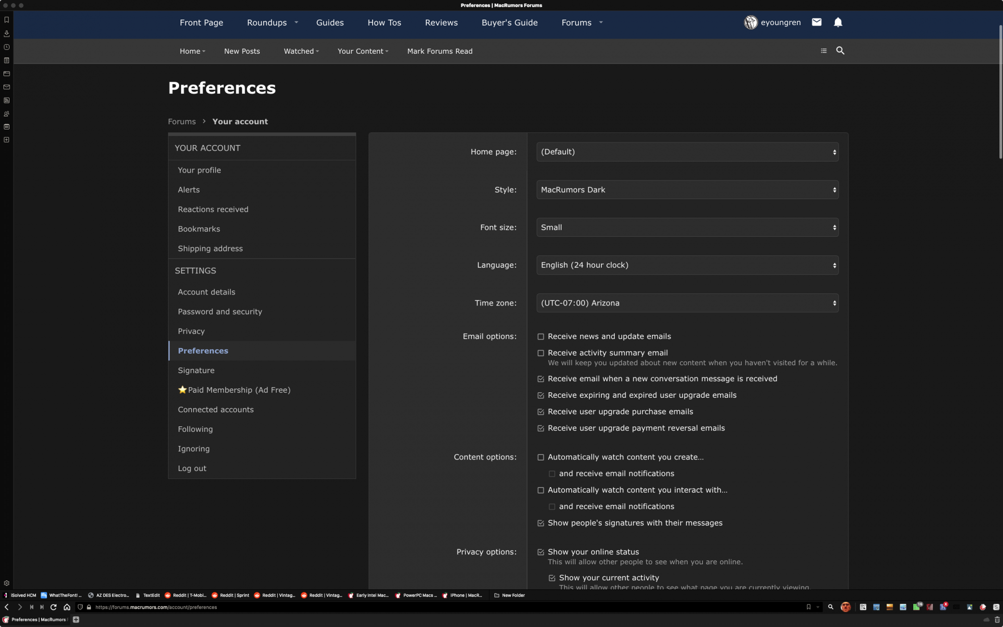

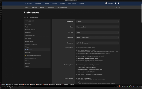

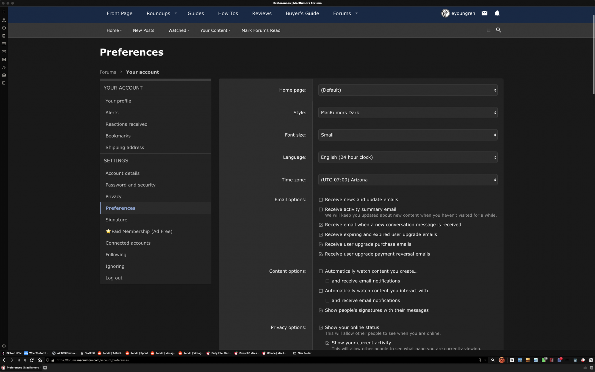

How did you get the dark mode to work on your powerbook ?
For MacRumors?
Preferences -> Style…
Or do you mean the menubar and OS theme?
The browser itself is using FTDeep Dark…the Linux version.
