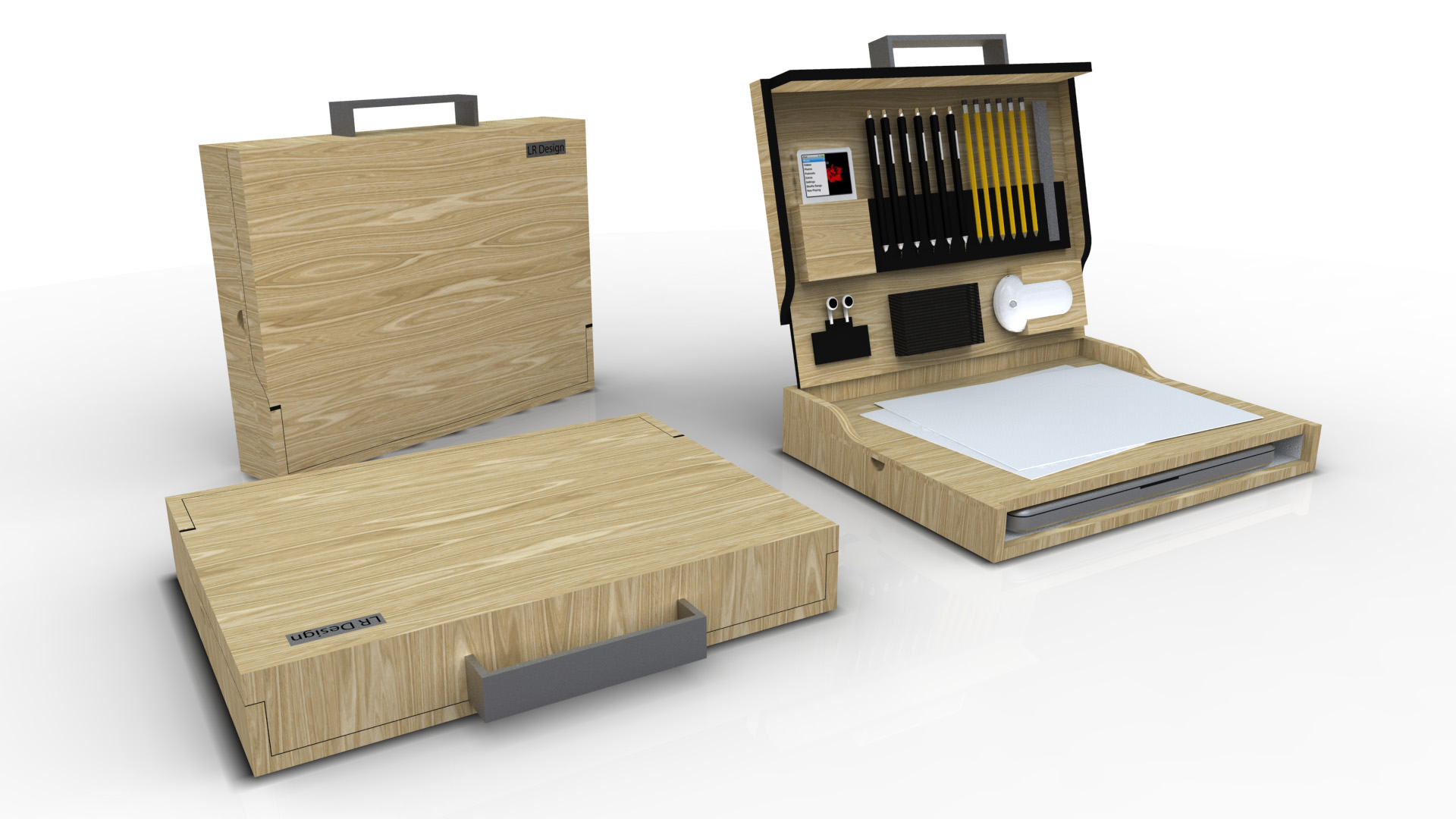

In looking at your designs, it seems you are making a case for your own personal needs and no other. If that's the situation, then anyone else's opinion doesn't matter as much. However, if this is supposed to demonstrate your pinnacle of design expertise, put down the buzz saw and please listen to some of the comments from others (or forge ahead and at some future point, look back and smile).
The mouse pad is too small for practical use. If you use the area where the paper is for a mouse, how do you access the Macbook? If space is cramped and you have a portable why is a mouse even necessary? Use the trackpad. You added another flap on the left side for coffee(???)! Next to a laptop? Without even anything to secure it? On a commuter train? I take it you've never actually spilled anything on a laptop and taken it in for service.
If the Macbook is placed where the paper is, the compartments are blocked. And the compartments appear to be primarily for pencils. How many others need such a large pencil case? Most laptop slip cases have space for a few pencils. You've made a place for the iPod but what if someone has a different model -- an iPhone or a nano? Most people would want to play music while working or even while carrying the case. Under what circumstances would they want a shelf to hold it? As others have said, if this is actually a sketch surface, the lips need to go since they restrict arm movement. Why not place paper on top of the closed case to write? Better still, why not just put sheets of paper directly on top of the laptop if there's a need for a hard surface? Is this supposed to combine a method of writing while using the laptop? It so far has not been visually communicated.
You may impress everyone when you get to the final iteration but your prototypes so far appear to offer little value and have not achieved the coveted visual elegance.
A couple thoughts. (Disclaimer: I'm a programmer, not a designer, so take these for what you will.)
Material:
1) instead of wood, maybe a bamboo laminate. It's a good 'green' material, and it's relatively cheap.
2) If you use bamboo for a veneer, it will look quite nice, since bamboo doesn't have a pronounced grain like most hardwoods.
3) Don't use leather for the padded compartment's lining. It looks nice, but the heat of the laptop will dry it out pretty quickly, and in humid weather it'll want to 'stick' to the laptop. Fabrics are a better bet there.
Structural:
1) A proper dovetailed join will be just about the strongest thing you'll be able to get, and it'll be cheaper than trying to mill out the inside of a block of wood.
2) Slot-mount the desk/divider. It'll stand up to anything the case can handle, and won't require any visible connectors.
3) Don't forget to leave room for cables to plug into the laptop while it's on the 'desk'.
4) Where are those side platforms (the 'wings') coming from, and how do they stay on with no visible connectors?
Accessories:
1) Mount the accessory holder bits on an integrated rail, so they can be moved/swapped as needed? Modular designs add a level of flexibility you'll never quite achieve with an all-purpose layout.
2) A simple drawer compartment to hold the power supply/mouse would keep them out of the way, but still accessible when needed. Not only that, but it will be usable even if the user doesn't have a wireless Apple Mighty Mouse. (That's a pretty specific assumption to make.)
Size:
1) Don't be afraid to make the case larger than the laptop. For example, if you set the padded compartment up properly, you could use the same basic design for all 3 sizes.
Gimmicky Ideas:
1) Integrated laptop dock?
2) Pass through connector in the bottom of the iPod compartment?
Ok so I've started to get more time now, I'm going to start developing this a bit more hopefully. I will be reading and replying to the feed back - as well as using it for development of the product.
I've just started to make the design much more fluid and ergonomic whilst maintaining the sharp, crisp and clean design!
Heres the first change I've made, just thought I'd post it here and explain my thinking at the moment.

Not too sure about this one...
Why? I don't see the use or how this implementation takes into consideration how it will be used. 😱
If someone is using this thing, he is probably sitting at a table. I don't see how there's a need for him to put it on anything else than on the table. First off, having that thing on the table would be constraining because it takes space on the table. Second, when using the laptop on the apparatus, it would be higher, not ergonomic at all. Having a higher keyboard is hard to type on and straining on the wrist, same thing for the wrist. Just try switching back and forth between using an apple keyboard to the keyboard on your macbook...
Next up, how do you keep those papers you have on there from flying everywhere when you close the thing. Also, it's kind of an odd place to put and iPod : where your laptop is 😕 a card holder that can fit an iPod would probably be better. The pencil seem to be dropped from the top, kind of hard with the handle on top of it.
Maybe I just don't get it, anyways, I'd go with something like this :
sorry for the really crappy sketch, also had to take it with my iSight...
Looks like another promising project!
Obviously there are a load of things to work on, as outlined, but I look forward to seeing where this is going 🙂
I think my main concern (assuming all the others were addressed) is that the handle is on the lid rather than the laptop compartment. I don't think I could buy something that would send my laptop to certain death if it did happen to accidentally open. And anything can accidentally open, even if its my own fault 🙂
Promising concept though - Mobile workstation...

Luke. that case is ugly and out of proportion, yours looks real business like,
and i would totally buy one if you get around to getting them produced, continue
with your concept just the way you have it, fixing a few things along the way 😀
one idea is that where the pencils go, there would be designated pencil size slots
so that the pencils dont fall out everywhere
also for the ipod holder...maybe make it so the middle is open
so if people are using their speakers they can change the song without removing the ipod from the slot
other than that wonderful idea, id totally buy

hey luke!
This design is pretty awesome! I have just one consideration.
I always avoid using an optical mouse on wooden surfaces because the grain seems to mess up the accuracy.
I'm surprised no one else has mentioned this? Or maybe my mouse just sucks.
I'm envisioning a nice built-in solid-color surface for the mouse pad. I've also noticed that graphic mouse pads mess up the laser as well because of the color changes and lines.
