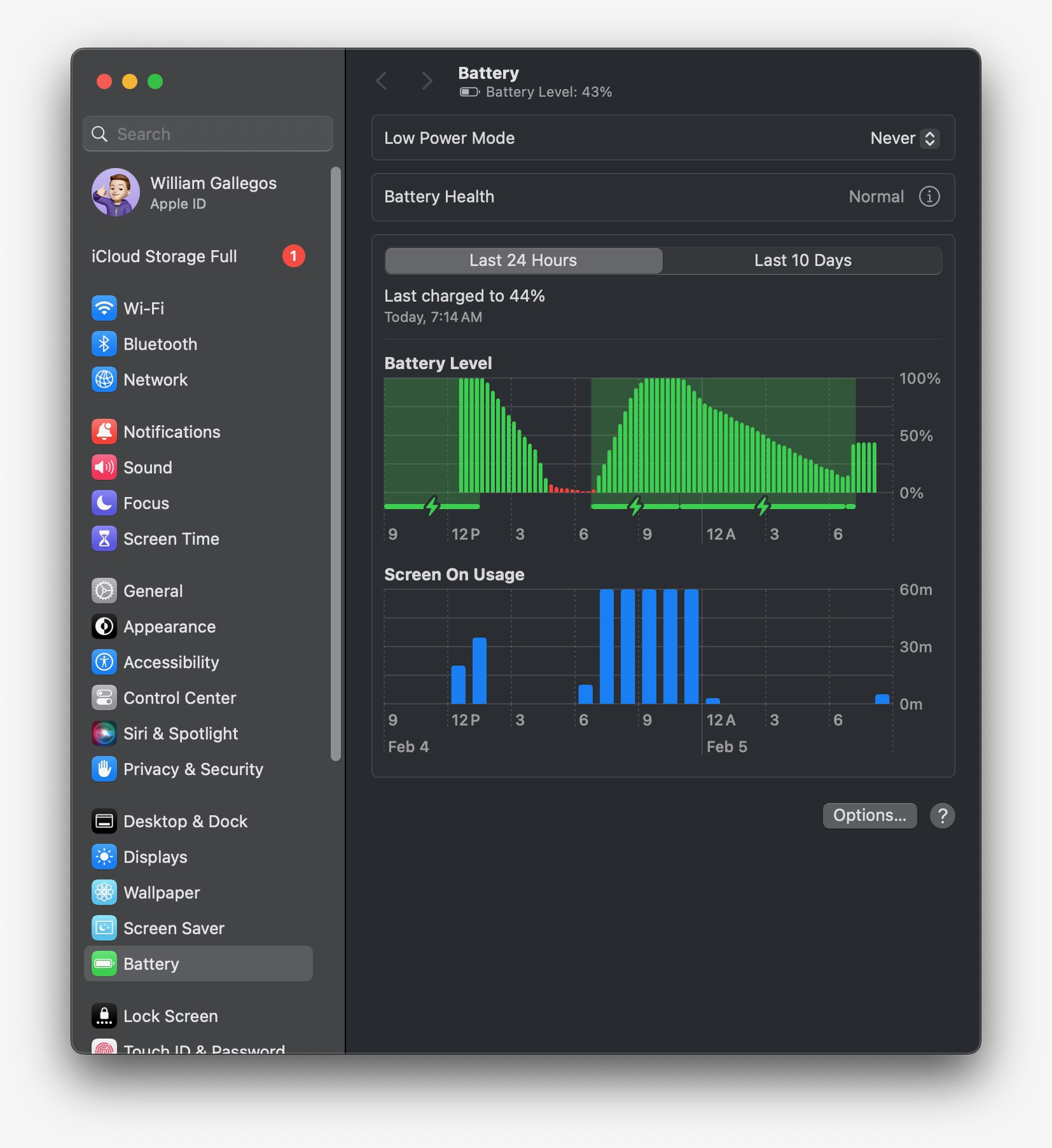

I have an M1 MacBook Air, 80% battery health, and according to Apple's diagnostics, it is perfectly fine.
However, just take a look at this with Discord, Safari, and Apple Music opened:
And this when charging it overnight occasionally so I can use it the next day:
You see the problem right? Very abnormal behavior with the battery.

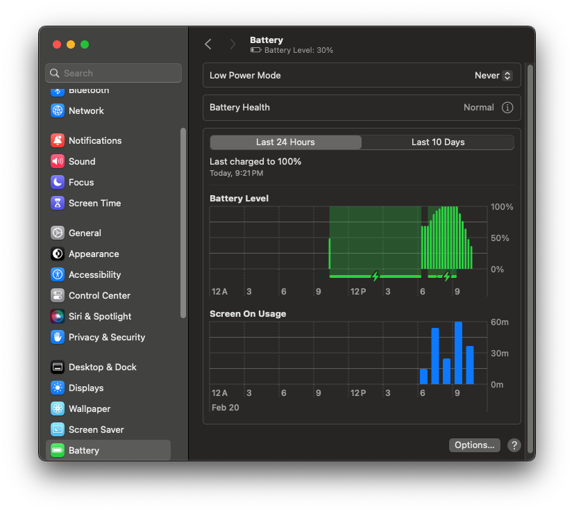

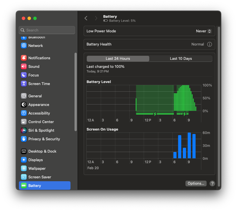

Now today, I present you with the battery chart from when I got my Mac back to now when I am writing this post:

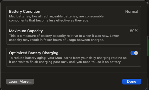

Battery Health is still 80%:
And I still have the issue.
I haven't had the draining while charging issue yet, but I guarantee that will happen sometime this week.

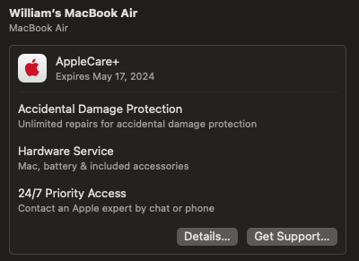

I never had a bad experience with the Genius Bar, and keep in mind, I have AppleCare+ on my Mac...
I expected more when I bought AppleCare+...
Funny enough, it says battery replacements included in here...

I think if you can get it to a point where apples battery health level is below 80% they’ll replace it. And that’ll probably happen soon at this rate. Otherwise just stay insistent. Kind but insistent. Hope the Apple Store is close to you.
Be patient for it to drop below 80. (But yeah to be at 80 is so so close and they want to string you along.).
