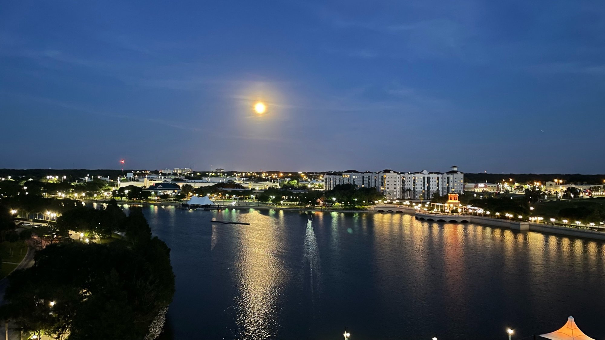

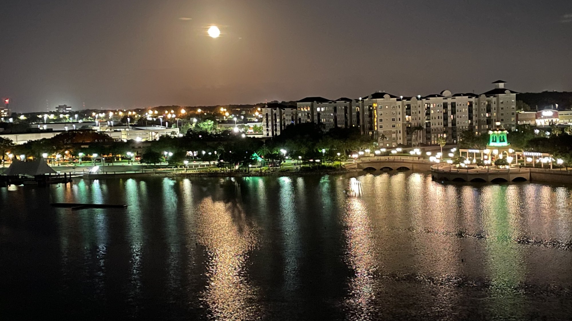

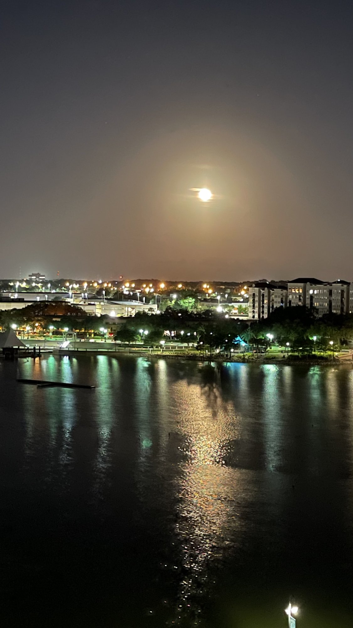

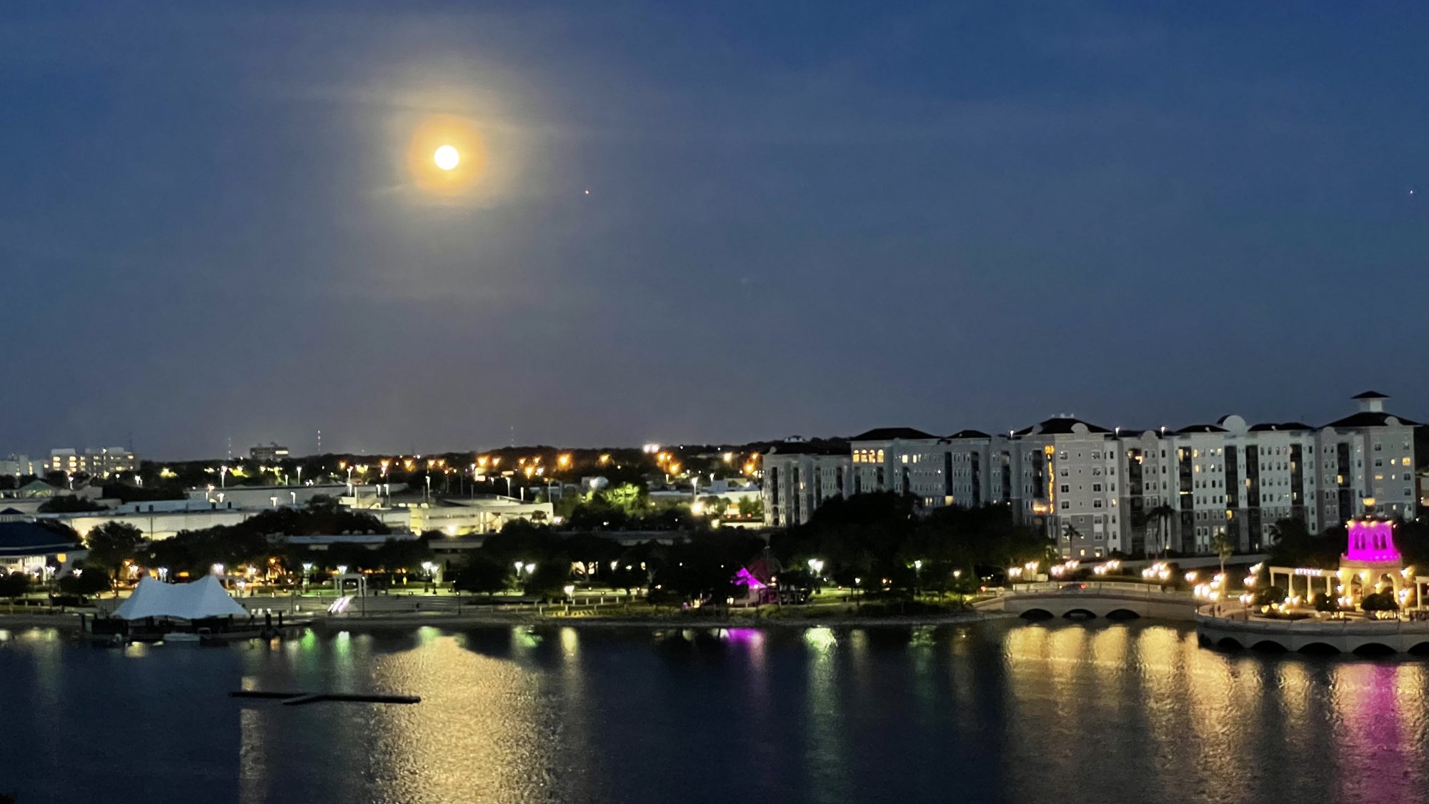

I have to say I'm disappointed in the night photos I am trying to take of this beautiful super moon. In some shots the background is blurry and out of focus. This is not intentional. And in all of the the beautiful orange tinted moon is nothing but a blooming ball of light. You have no idea what it is. Maybe my expectations are too high but I was hoping for more out of this phone. I am posting a few and would love thoughts. Maybe I’m doing something wrong.
The moon is actually much brighter than most people realise. As it’s so small in the frame the auto exposure adjusts for the whole frame, making the moon just a white dot.

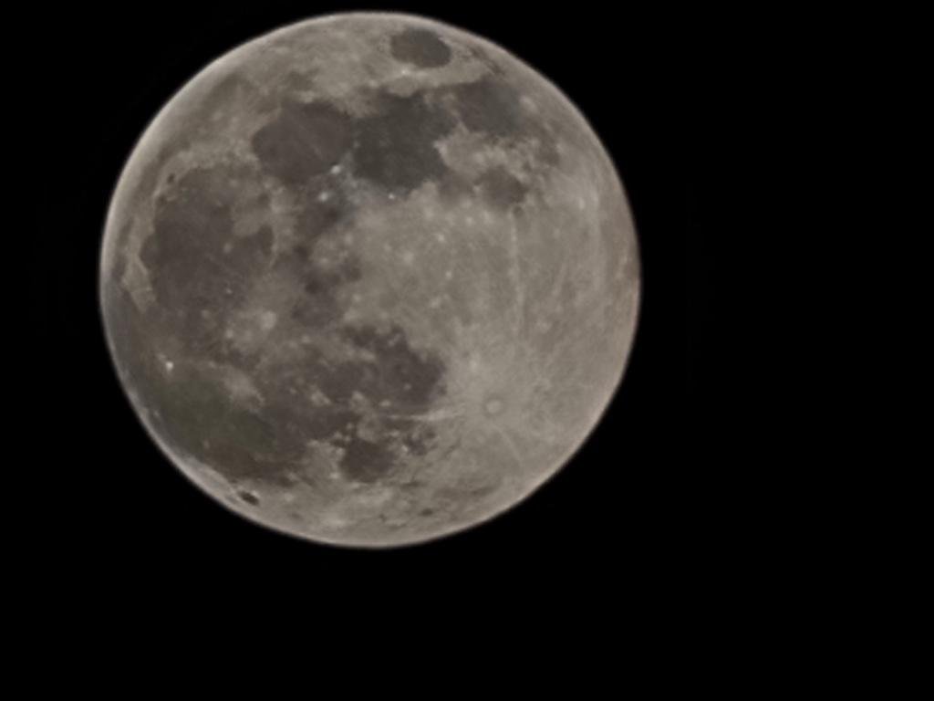

I have a photo of the moon taken on a camera and correctly exposed, at F11, 500th Sec, ISO 800.
Try taking another shot, adjusting the exposure to make the whole photo a lot darker and you might get the details back on the moon’s surface.
The moon is a whole lot brighter than you think. Particularly a full moon in a dark sky. Without a separate lens attachment or sometimes thru a binocular, you won’t get a halfway decent shot on any basic phone camera.
Do not use auto. Download a camera app that allows manual setting. An auto algorithm will look at the majority dark sky and try to boost exposure.

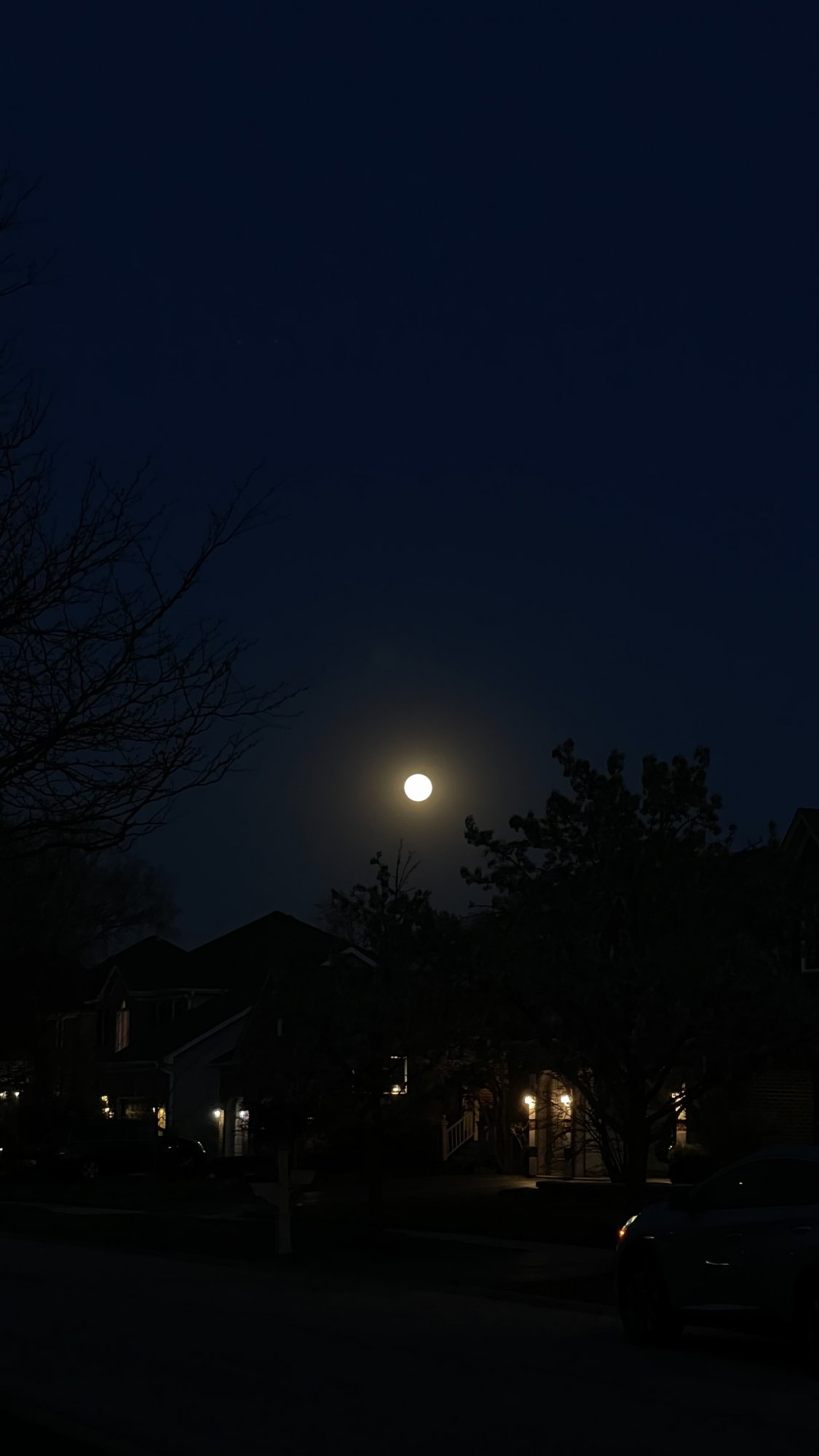

I used the ProCamera app with manual settings and this is the best my 12 Pro could do shooting from my hand.
