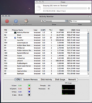

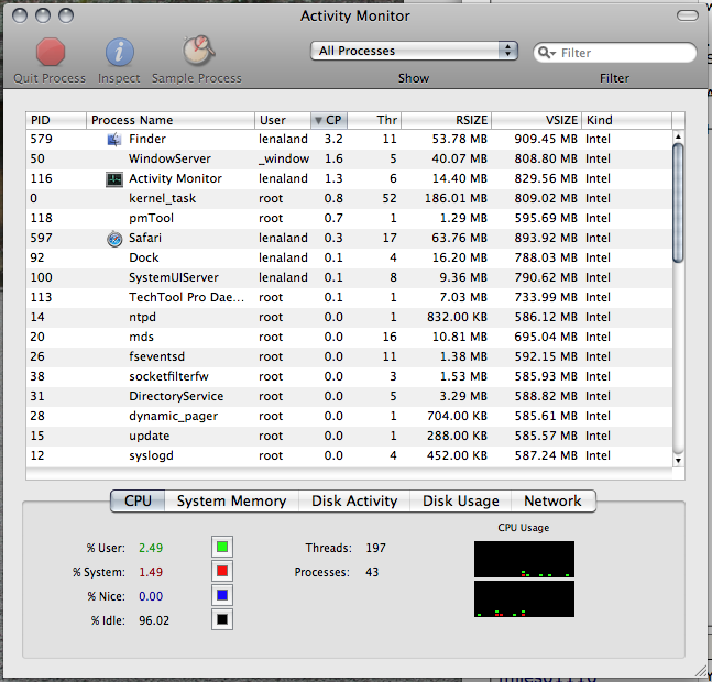

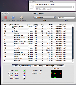

Here's a screen shot:

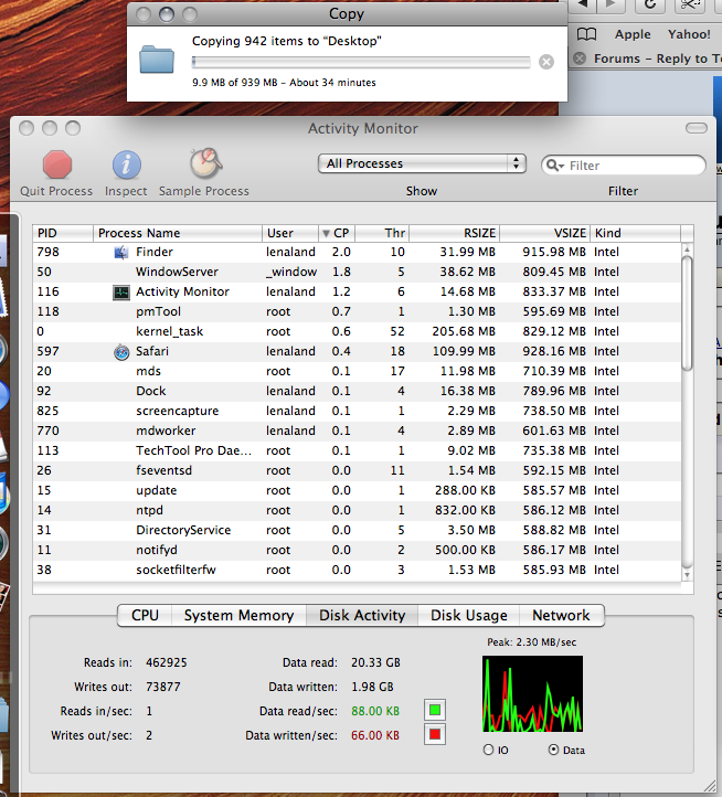

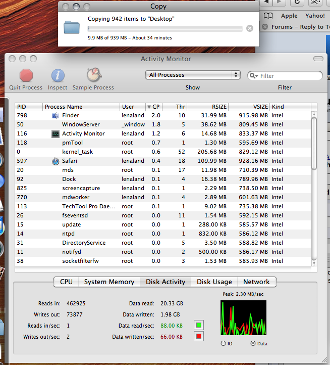

If you check the "Disk Activity" tab on Activity Monitor is it showing a large amount of activity?
Right now, yes, but only because I've resorted to copying at least some of my files to DVDs :[
This is horribly inefficient, and probably won't fix my issue, but at least I'll have a backup.
I'll check the disk activity again when the disc is finished being burned.
What are the chances that my internal HD is at fault?
It's not showing a huge amount of activity, but there is some. Also, the light on my external HD (where I'm moving files from) is hardly even blinking.
