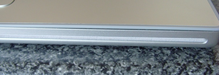

Just had my Superdrive replaced on my 6 week old MacBook Pro because it stopped reading DVD-R and DVD+R by an authorized repair centre.
Here is the first attempt

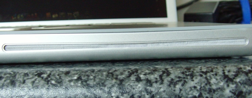

upon getting it back in this state I contacted Apple and the repair centre responsible. They said it is highly irregular and a simple 5 minute fix to put it right for me.
here is the second attempt.

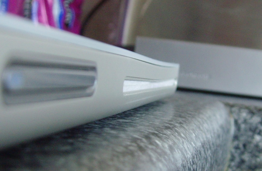

now the Superdrive wont eject discs because of the warped top section. I have to bend the case slightly to allow them to come out
I now have Apple collecting it tomorrow for repair by them I dont know whether to laugh or cry.

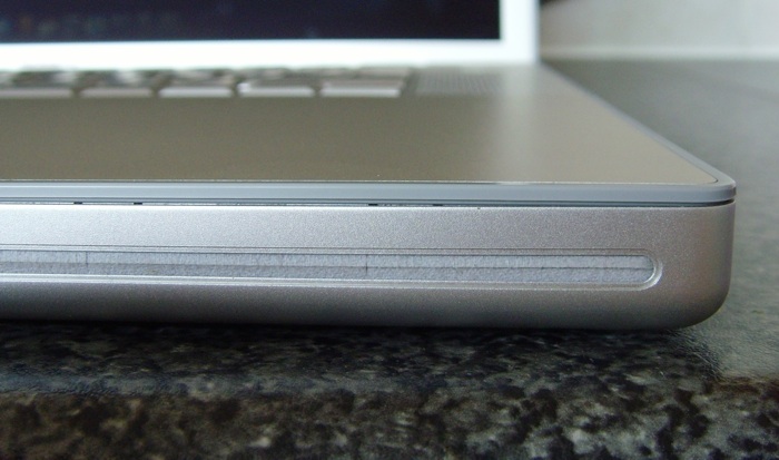

I actually did this trying to remove the top case off a MBP. The top case is very hard to get off sometimes and you have to pry around the edges to get it off. The lesson learned is to pry VERY, VERY lightly around the superdrive because there is nothing supporting the metal casing underneath that spot. It took me a while but I was able to get it back to where the drive worked fine but it always left a small gap like the one I see in your pictures. I would see if Apple can fix it this time and if not tell them they need to replace your bottom case on your MBP, that would fix it. Looks like the person doing the repair was a little to forceful trying to get the top case off.
it might be just that the snaps are not snapped in, put a disk in half way, and press down really really hard to try and snap them back into place, you'll hear some clicks and it should be better
yeah, I had to snap those clips back in before mine sat flush after a hd install. I had to use a hard flat surface to support the weight of the drive bay as I pushed down on the top case.
you dont have to pry it off with a tool, etc. Just pull the top case up from near the LCD screen back towards you.
