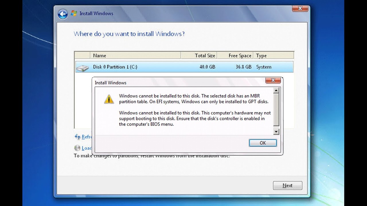

If the error is 0x80300024 there is a workaround:
