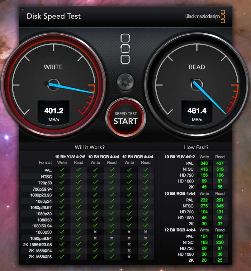

The 2011 imac is SATA III not II. I have just installed a 512 Vertex 4 in my 2011 imac and I'm getting 400MB/s write and 460MB/s read speeds using the Blackmagic disk speed test.
Would you be able to run the BM speed test on your 2012 imac for comparison.
Thanks
Thanks
while the 2011 iMac may have a sata III interface, a BTO/refurb 2011 iMac is supplied with a SATAII SSD drive from apple and therefore negotiates and runs at SATAII speeds. Sure you can add a third party SATA III SSD like yours but unless you get an apple authorised dealer to do it (additional cost) you blow your warranty/applecare.....
Wow, that is astounding and to think the 512 bto SSD would have cost $1300, now I'm even more chuffed than I was earlier. The raw speeds don't really tell a lot because some drives are better in tougher conditions, but might be slower moving smaller blocks.
