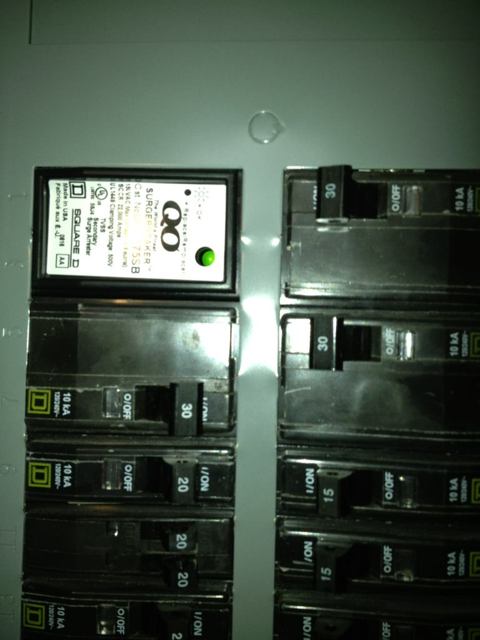

Here is a whole house protector I installed in my house.
Installation is relatively easy with a bit of electrical know how. With extra spaces in the panel its easy. If not you may need to use "cheaters" to make space. I'd recommend using cheaters on small things like lights, and outlets that are normally not used.
Then supplement that protection with HIGH QUALITY outlet surge protectors. APC professional line. I use an old PRO8T2MP12B.
Also my local power provider offers a whole house protector that's installed on the meter outside. Basically it goes on between the "glass part" and the base. Unfortunately they charge a monthly fee for it, but it does include a bit of financial protection.

The effective protector is typically 50,000 amps. That Square D protector I believe is only 22,000 amps. Two are recommended to earth and remain functional. So that even a direct strike to the telephone pole causes no household damage.
Where is a picture of what was far more important. What defines protection: connection to and quality of the earthing electrode. A protector is only a connecting device. Protection is provided by earthing. Hundreds of thousands of joules dissipate where? In a 1500 joules protector? Advertising is about ignoring damning numbers.

SquareD says for their "best" service panel protector "electronic equipment may need additional protection by installing plug-in [protectors] at the point of use."

The square d breaker protector I post above came with a warranty for equipment that's on it but it doesn't actually cover anything. If you read the fine print basically anything with a control type board in it isn't cover (sensitive electronics). Basically anything that would be damaged by lightning.
Best warranty on cars is found on GM products. Does that prove GM products are superior to Honda, Toyota, or Hyundai? Of course not. Warranties are often hyped as sales gimmicks to the naive who ignore technical facts - especially the spec numbers.

If I remember right one of the SquareD 'whole house' protectors does have a warranty on electronics, and the warranty is doubled if "point of use" protectors are also used.
