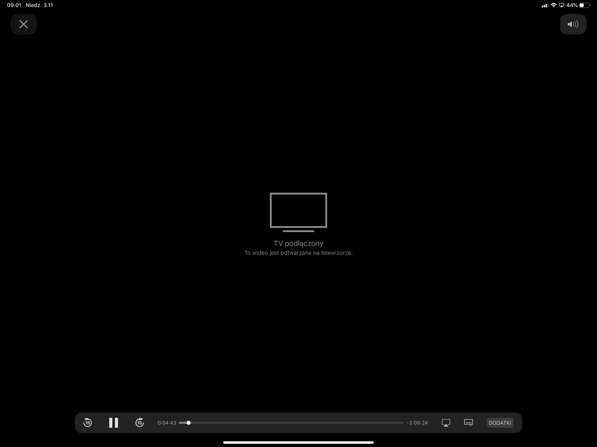

I was not able to have "sound only option" becasue after connecting HDMI to iPad when you play movie ipad displays message as on the below photo. So after connecting HDMI to SONY headphones receiver you will hear the sound but you will only see a warning message on iPads display.

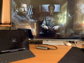

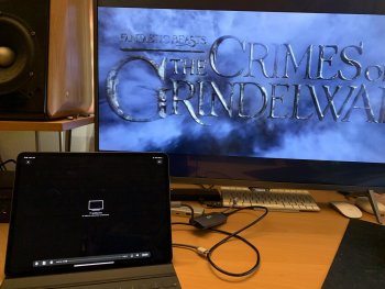

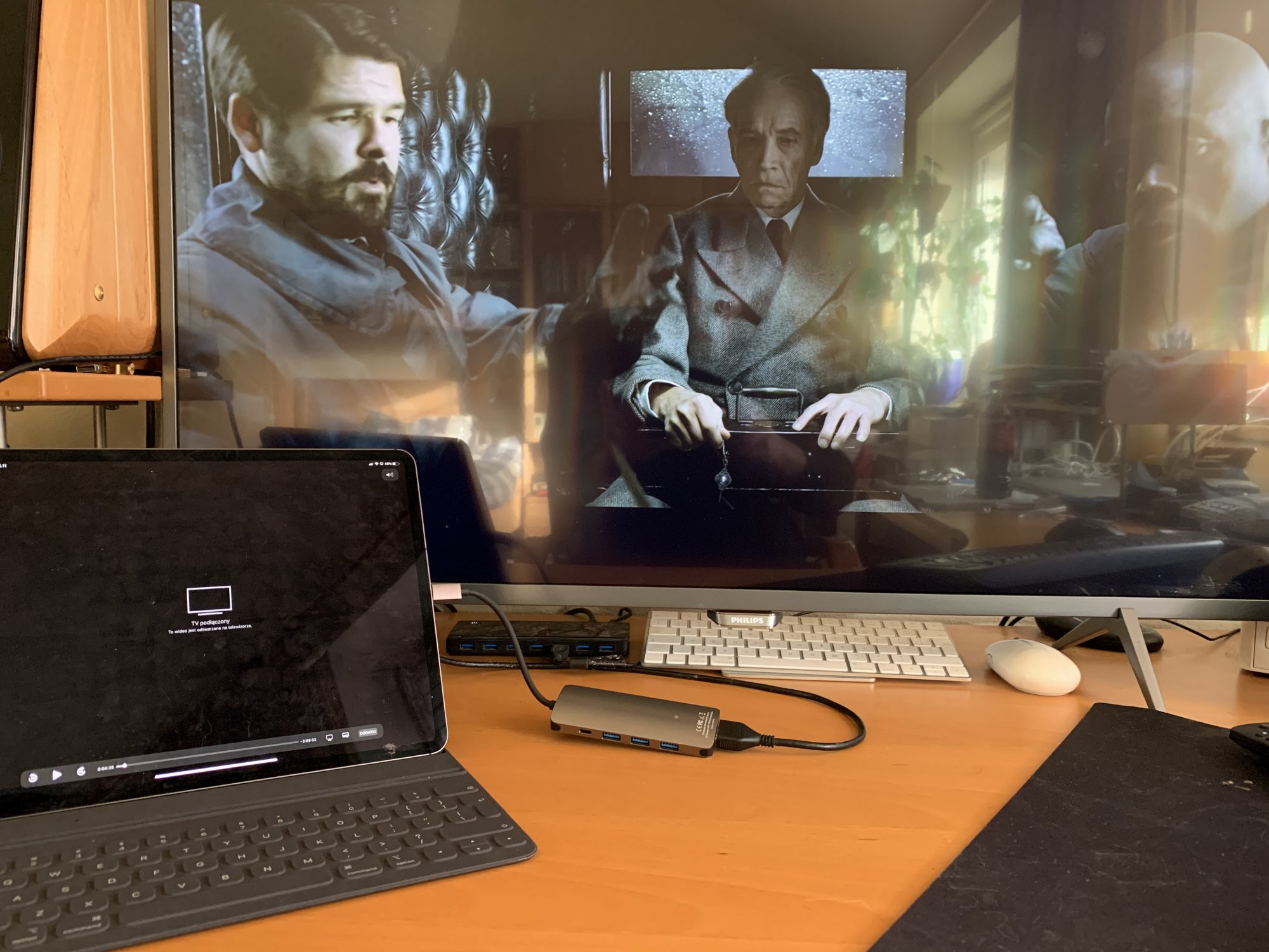

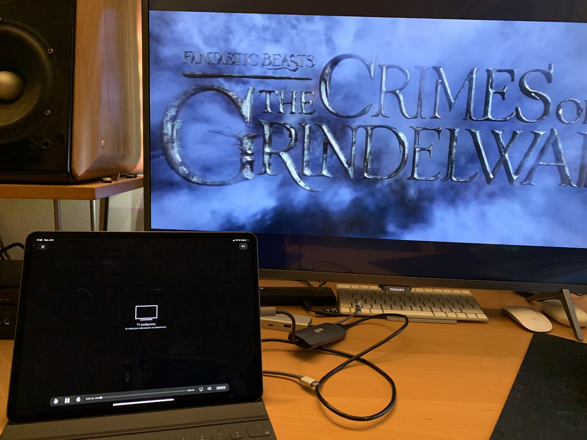

I connected it once again using different cables. Everything is as it should be. Picture from iPad on TV screen and audio via Sony headphones in multichannel.
