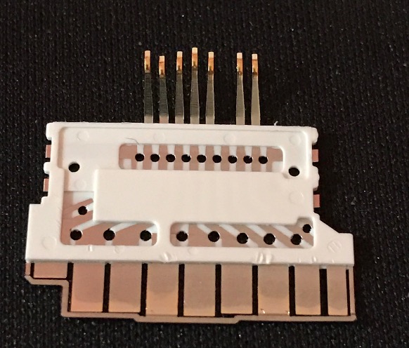

There are no electronics or other electrical components in these adapters, just direct connections from pins to pins. Therefore I have to presume that performance issues with the BaseQi were the result of inferior material and / or construction.
Here is a photo of the inside from the Samsung micro SD adapter.

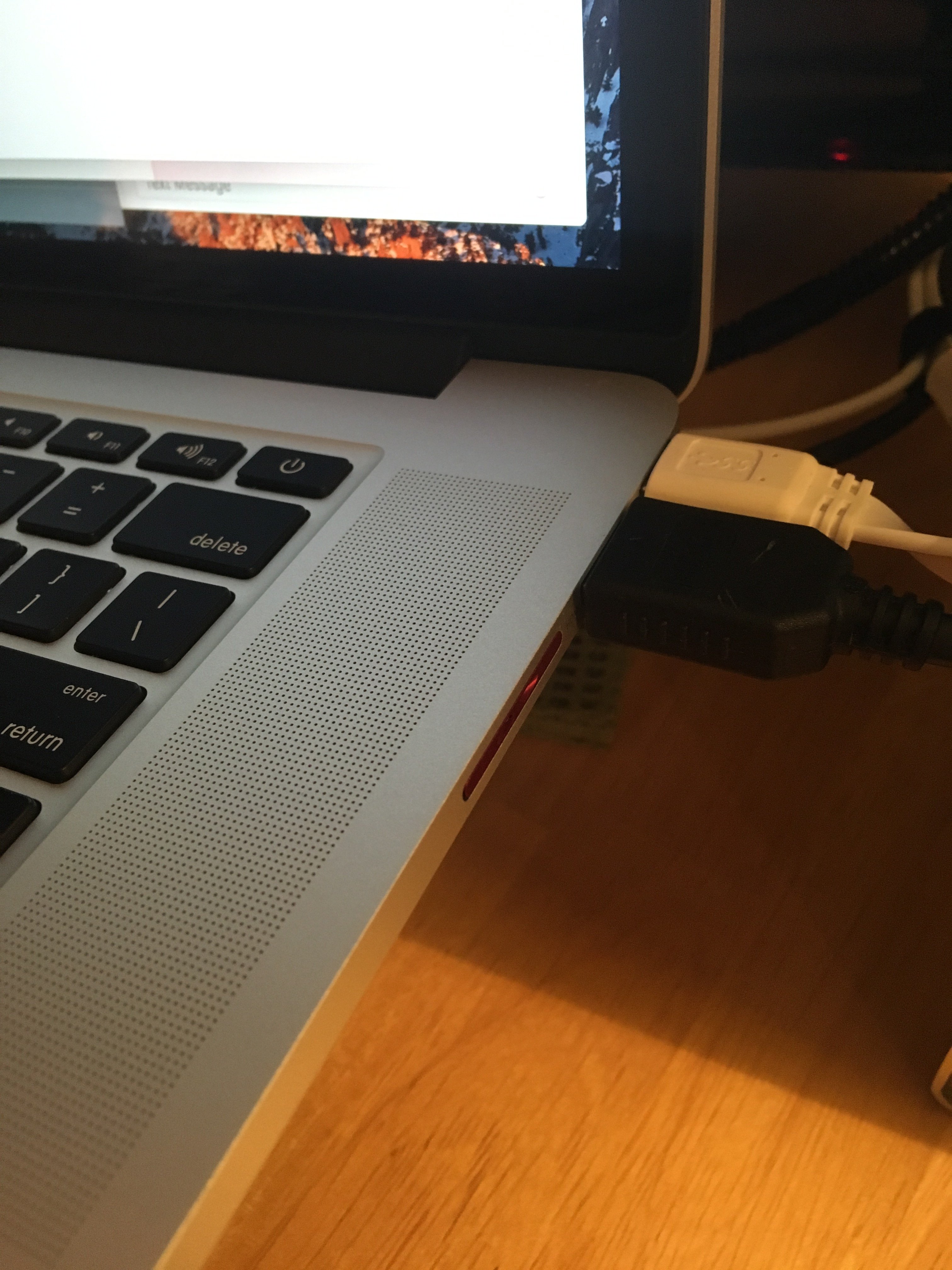

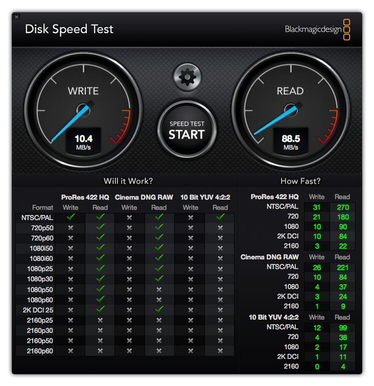

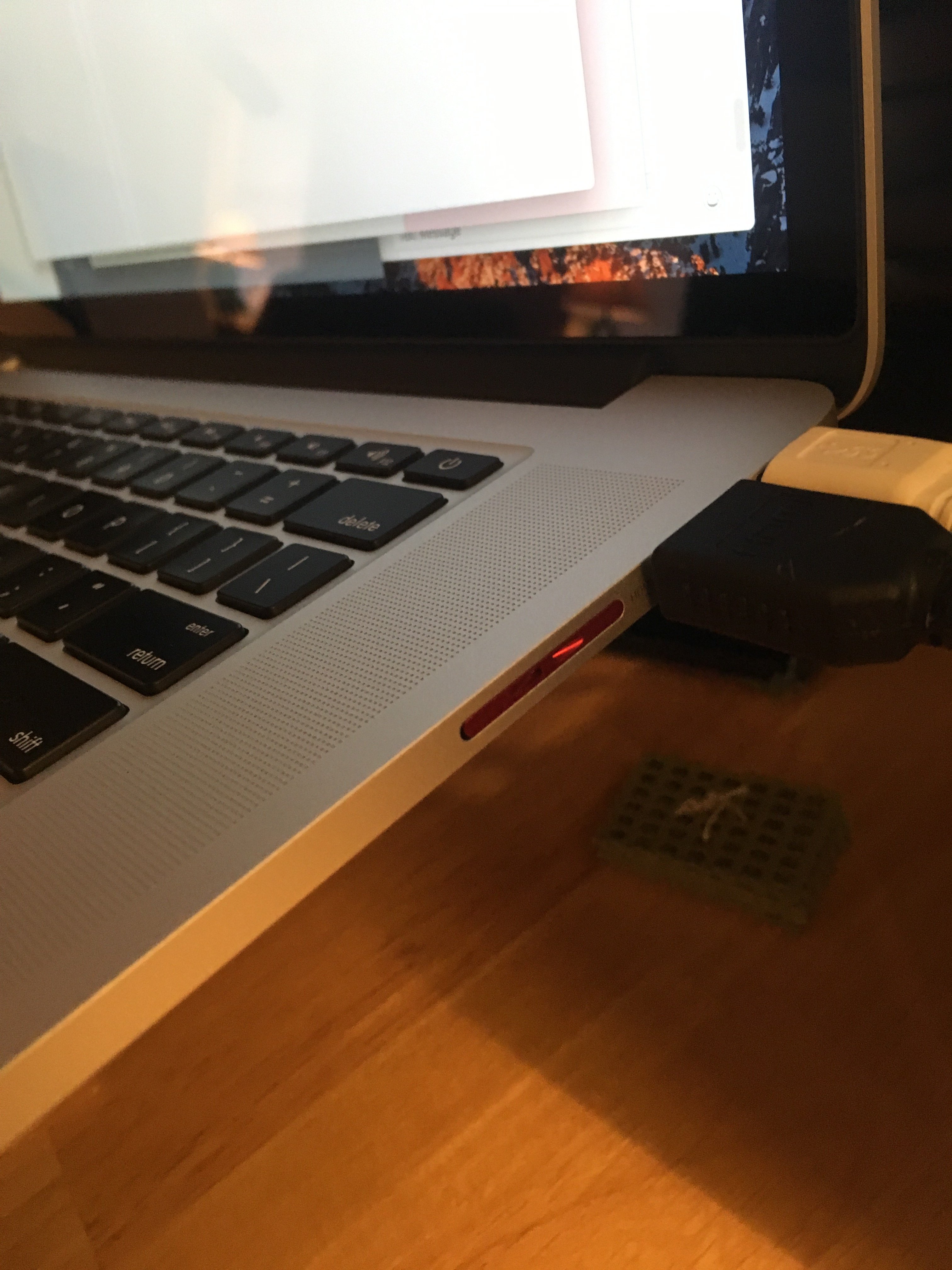

Received the eBay adapter today. Speed results (link in post #1) are close to the free Samsung adapter and much better than the BaseQi in both read & write.
Because it was not made specifically for the MacBook Pro Retina 2013+ it's a bit long (photo below).

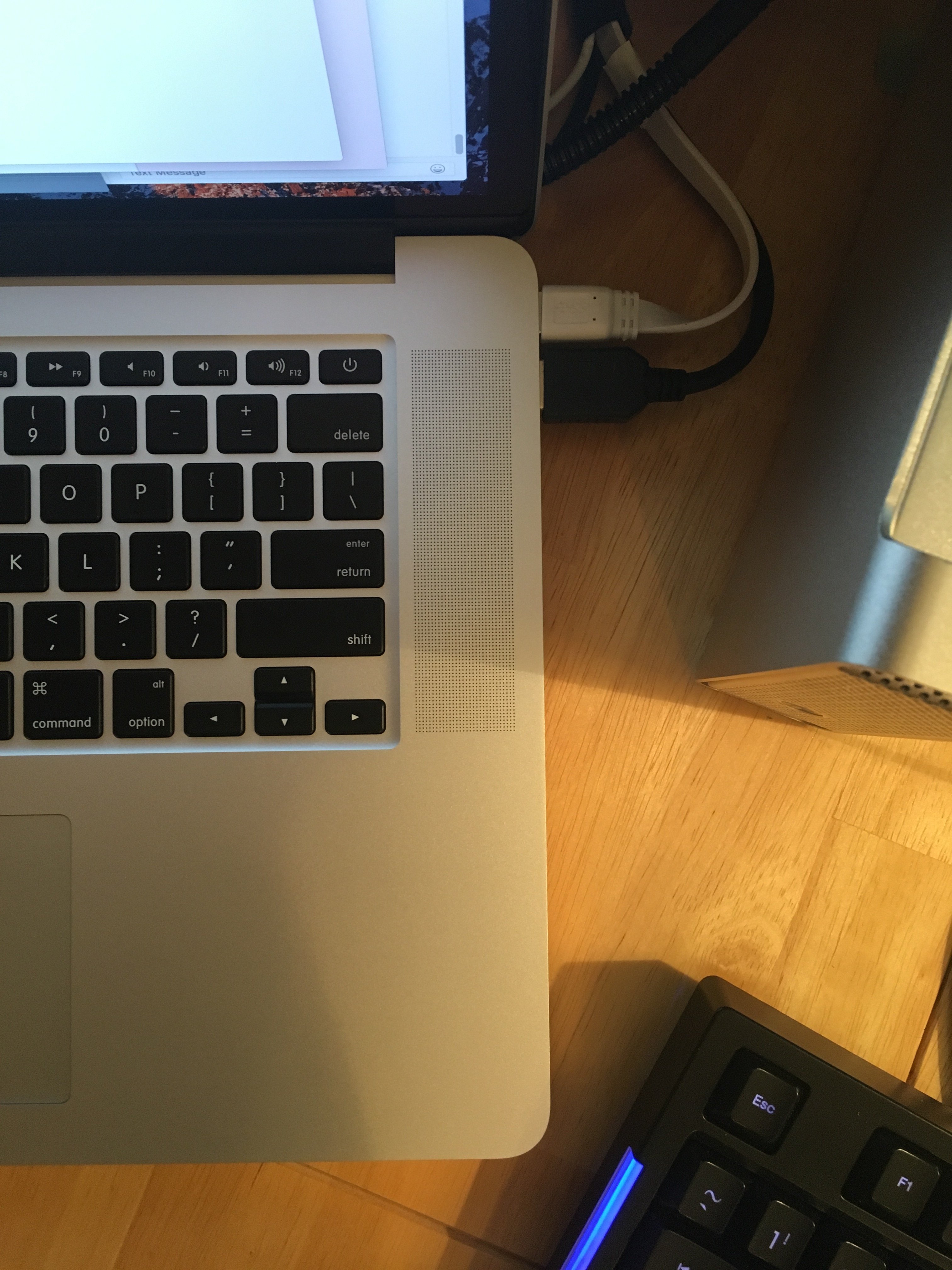

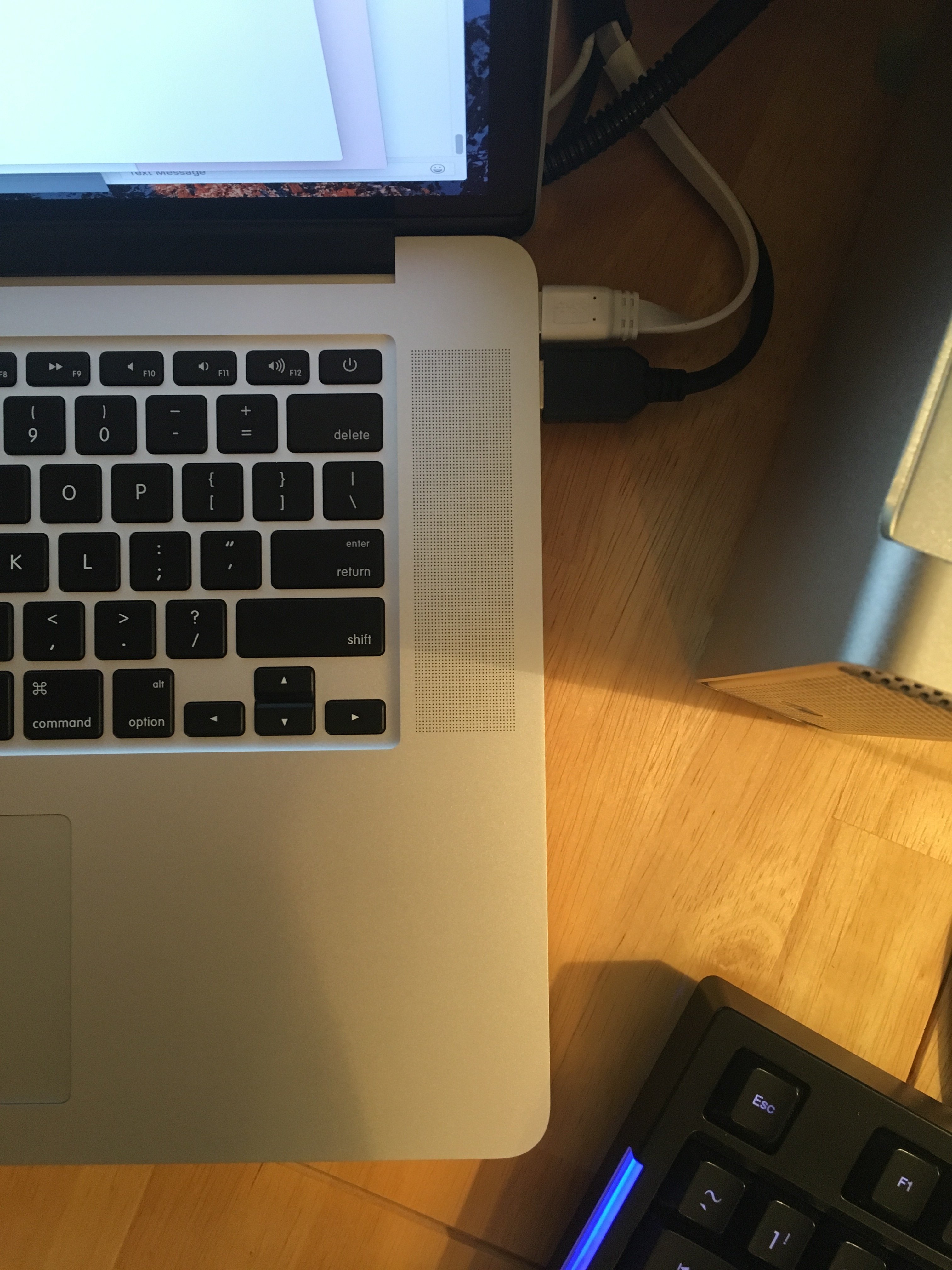

I got mine from Nifty. IIRC they included a free bare bones 4gb microSD card.2017-01-26 11.41.27.jpg 2017-01-26 11.42.20.jpg 2017-01-26 11.42.24.jpg 2017-01-26 11.43.25.jpg

Happy to report that the Nifty MiniDrive arrived today. Short story, I'm happy and plan on keeping it (thanks for your input @ZapNZs).
Longer story, the Read speed is better than the free Samsung adapter and the eBay china adapter. Write speed is slower than the both of the other adapters, but acceptable.
