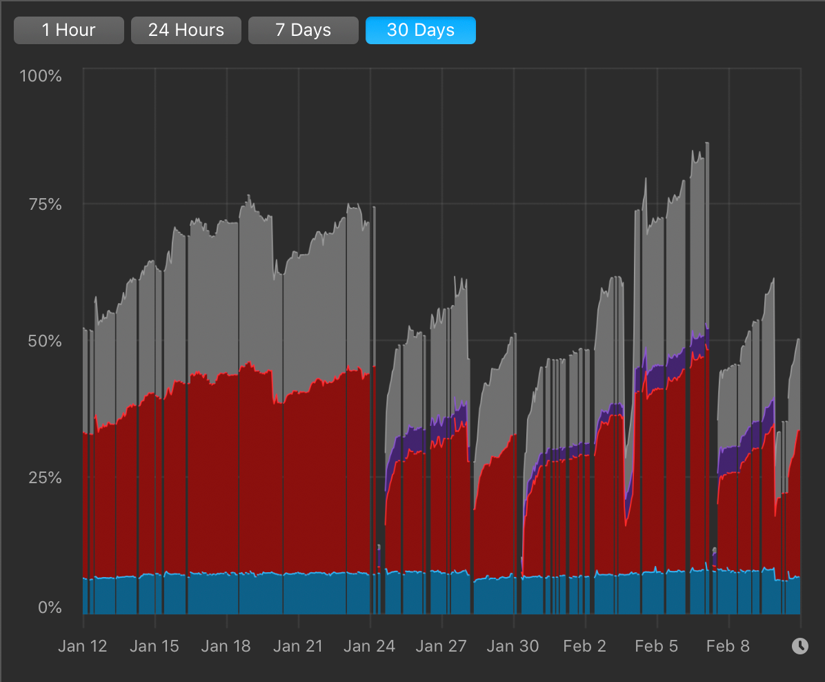

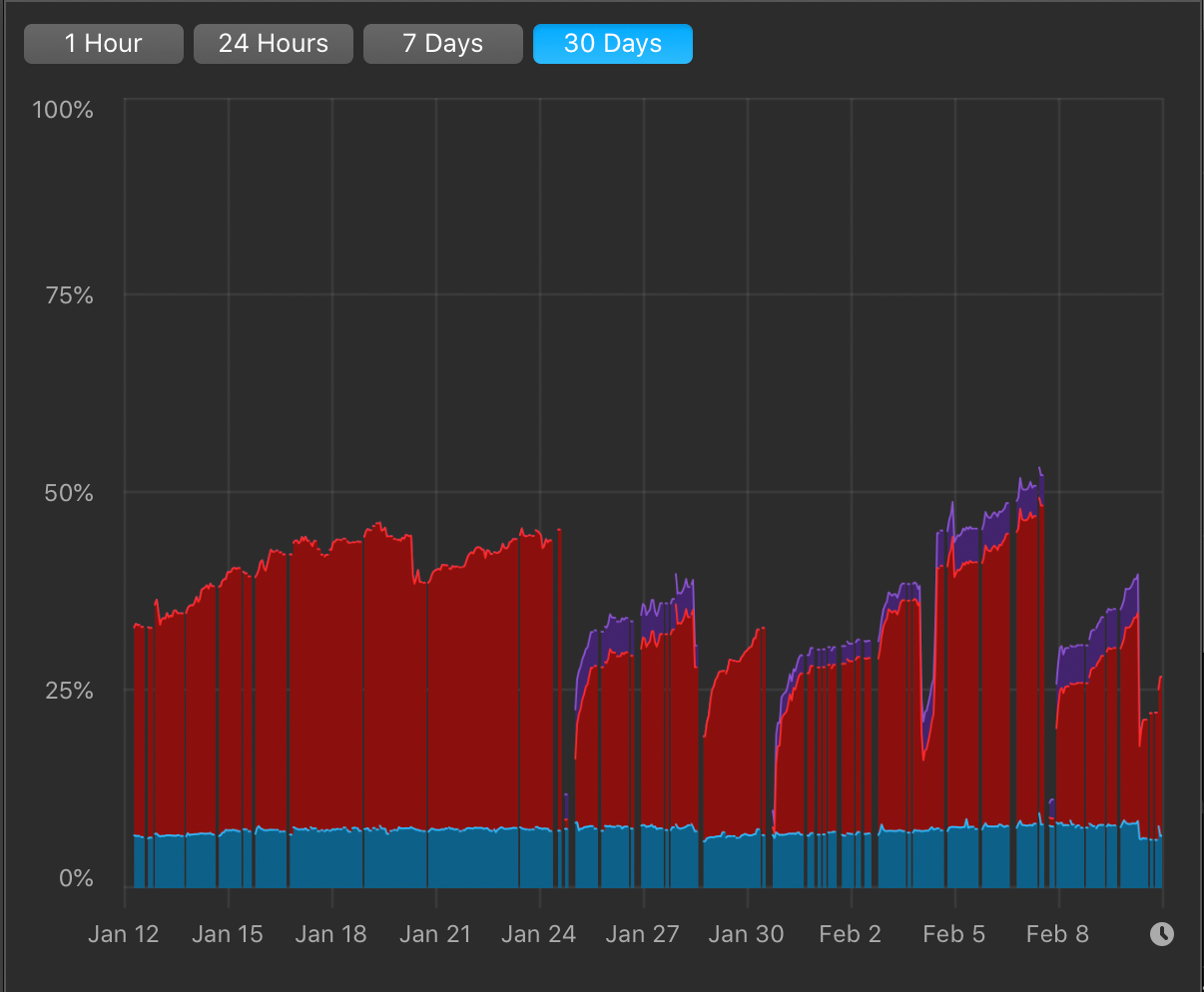

Here we go. RAM usage stays below 50% all the time (some might say I'm not using my computer properly) and swap kicked in a few times. One of those times was 5am, when I was sleeping. ¯\_(ツ)_/¯
RAM
SWAP
I have just realised something in your graphs (I should have seen it right at the beginning). There is a memory setting in iStatMenus called "Hide inactive memory". I think you have this enabled. You should untick it.
With the option enabled, iStatMenus is hiding "inactive RAM" and adding it into "free memory". I have it disabled. Look at this from my 40GB RAM iMac which shows 50% to 60% used (wired + active + compressed):
The light grey is the 'inactive memory'. Even though I have lots of compressed RAM and some swap usage, my free+inactive is nearly 50% like yours. This is normal and the more RAM you have the more is likely to be 'inactive'.
The inactive RAM is a cache of memory belonging to processes on your system, but which have not been used for some long time. macOS keeps such memory in RAM because it is (perhaps) likely to be used again in the future. The algorithm deciding which RAM to keep as inactive, or compressed, or in the swap file is complex (and not published except for what is in the open source parts of the kernel).
My swapfile usage graph has the same characteristic as yours. Firstly after a reboot, the compressed RAM (purple) and swapfile are zero. At various times I do something which requires more RAM (or maybe I just have so many apps running), the really 'free' memory becomes low and macOS compresses some of the inactive (grey goes to purple) and often also sends some of it into the swap file. I only have 40GB RAM (and run lots of apps at once) so I see bursts in compressed and swap more frequently than you with 64GB.
For most people the memory pressure is the only thing they need to worry about. It is a nice single value which everyone can comprehend on some level. Once you start going deeper than that you are in for a steep learning curve (or incomprehension!!). Like some others in this thread, I find OS internals interesting so have climbed that curve to a certain extent.
I hope that helps.
ps. you are using your computer properly and, at times, using all the RAM.

You are right, sir, and this is the updated graph. Still no sign of all RAM being used, so ¯\_(ツ)_/¯. However I'm not worried anymore after your, and others', explanation! Thank you!
