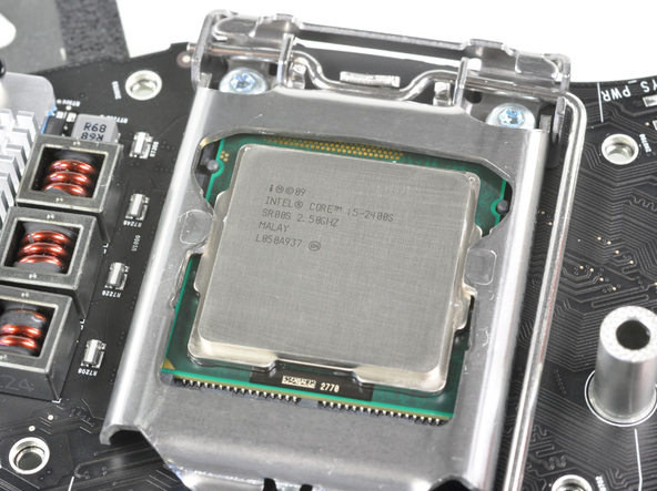

em people, the CPU is not soldered in. Its in a normal socket, and it can be upgraded!!!!!! Just look at iFixit teardown, and people have switched CPU's before. http://www.ifixit.com/Teardown/iMac-Intel-21-5-Inch-EMC-2428-Teardown/5485/2 look at step 13, pic 3. Standard socketed CPU.
Then look here https://forums.macrumors.com/threads/1163142/ for more info. @OP, Don't listen to the previous posters! (no offense people. You were probably thinking about the fact that all apple computers using mobile CPU's (MBA, MBP, MacMini etc.) had the CPU's soldered in an thus not upgradable)
As far as the GPU. Its located on a separate board (forgot the name) and it can be removed. Which means it can technically be exchanged. Problem is no one makes GPU's on these boards (at least you cant buy them, or not at the moment) so you wont be able to do it. Step 12 of the iFixit link above shows the GPU board.

Looks like a socket to me:
xHZYfH2MPGsTsqyT.medium
It's socketed, but the best you can do for the 21.5" is the 2.8 i7, since the 3.4 has too high of a power requirement.

Looks as if the 2.8 i7 are socket 1156 instead of socket 1155. I reckon I'll just leave it and once my mac is out of warranty I'll just overclock it.
Intel must have really seen a difference in performance for that ONE extra pin lol.
