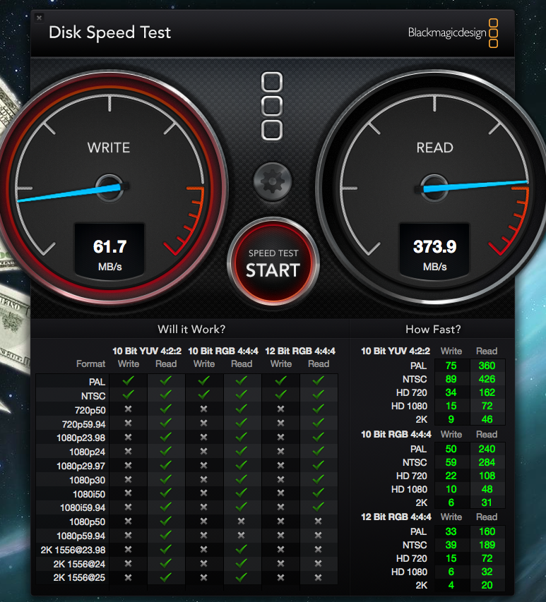

I should note that Black Magic Disk Speed Test shows my write speed no higher than 100 MBPS, but my read speed is up to 400 MBPS. Is this just the test messing up? My MBP is very fast still.

400MB/s read speed looks just fine and definitely nothing SATA 2 can do.
SATA is also serial and unidirectional so it shouldn't matter whether it is reading or writing.
Any chance you are using a small SSD and those write speeds are normal.
Small SSD write much slower yet read speeds usually are okay.
For perceived speed write speeds don't matter. They only matter if you want to extract archives or copy big files. Even for Installs only the random write matters and is generally higher then the CPU at unpacking install packs.

Ok, I have a Samsung 840 120gb. Just wondering if anyone had the same issue.
Well the 400 MB/s aren't too far of and if the write hits about 100MB/s that seems about where it should be. This blackmagic tests usually comes in lower than tests like ATTO.
The Samsung 840 TLC has big chips with only half the controller's channel saturated at 120GB capacity. It is only rated at about 130MB/s.
The 240GB version has all 10 channels saturated and yields about double the write speed. And 480 up really get everything out of the controller.
That is just how it is with small SSDs. 120GB is small were 20nm TLC NAND is concerned. Used to be a problem with 64GB.
