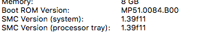

What’s the SMC version? If it’s 1.39f11 it’s a 2010/2012 board, if it’s 1.39f5 it’s 2009 flashed board.
Reactions: crjackson2134
Hi, sorry for late response: here it is:
Boot ROM Version: MP51.0084.B00
SMC Version (system): 1.39f11
SMC Version (processor tray): 1.39f11
So, you can see that this is swapped boards, not firmware update.
