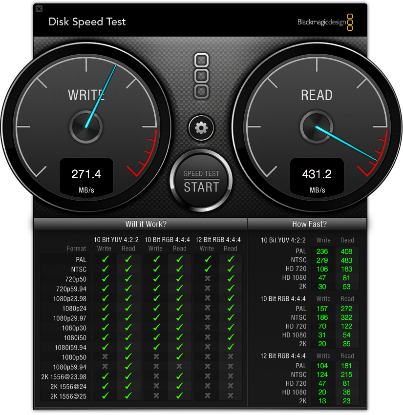

Thanks for the suggestion Fishrrman, that's a good idea that I hadn't considered. What sort of read/write speeds do you think you get over USB3?
Since a USB3 enclosure only costs about 10 quid I think this might be the way to go.
I don't have the figures to hand right now, but I have an OWC SSD on USB3 and Fusion Drive in my 2012 Mac Mini and they benchmark pretty much identically suggesting that USB 3 is no slower that SATAIII. Having said that I previously used the same OWC drive over FW800 (which is a bottleneck, but faster than a 5400rpm HDD on SATAII) as the boot drive for a 2009 mini. I got annoyed with it because the drive wouldn't turn off or sleep when the mini did and sometimes the mini would fail to start up until you turned the drive on and off. I think these are mainly issues with the FW800 drivers though. Definitely give the enclosure a go - you've got nothing to lose.
[[ What sort of read/write speeds do you think you get over USB3? ]]
