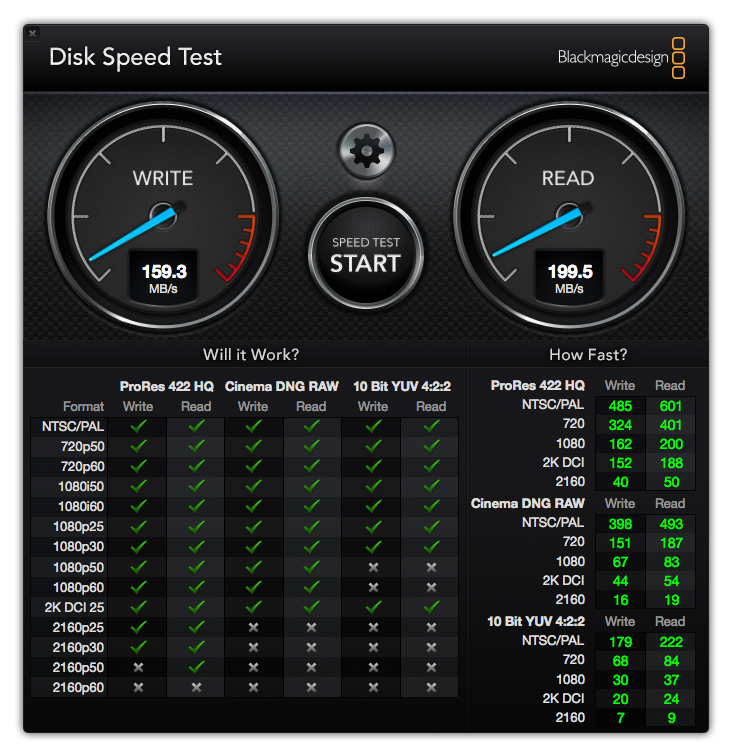

See the attached image, both figures are less than half of what I get with the drive as internal.
Yes, USB 3.0 and UASP. I've ordered the necessary parts from iFixit now, and I look forward to the experience 🙂.

My SSD benchmarked way below would SATA 2.0 should be able to achieve, it's not the bottleneck.
That is what I think is to be expected for a USB-connected SATA-2 SSD.
Hmmm... if it's an older -SSD itself- that is only SATA II, the USB3 enclosure with UASP isn't going to help with the speed. Get a -new- SSD and things will go considerably faster.
