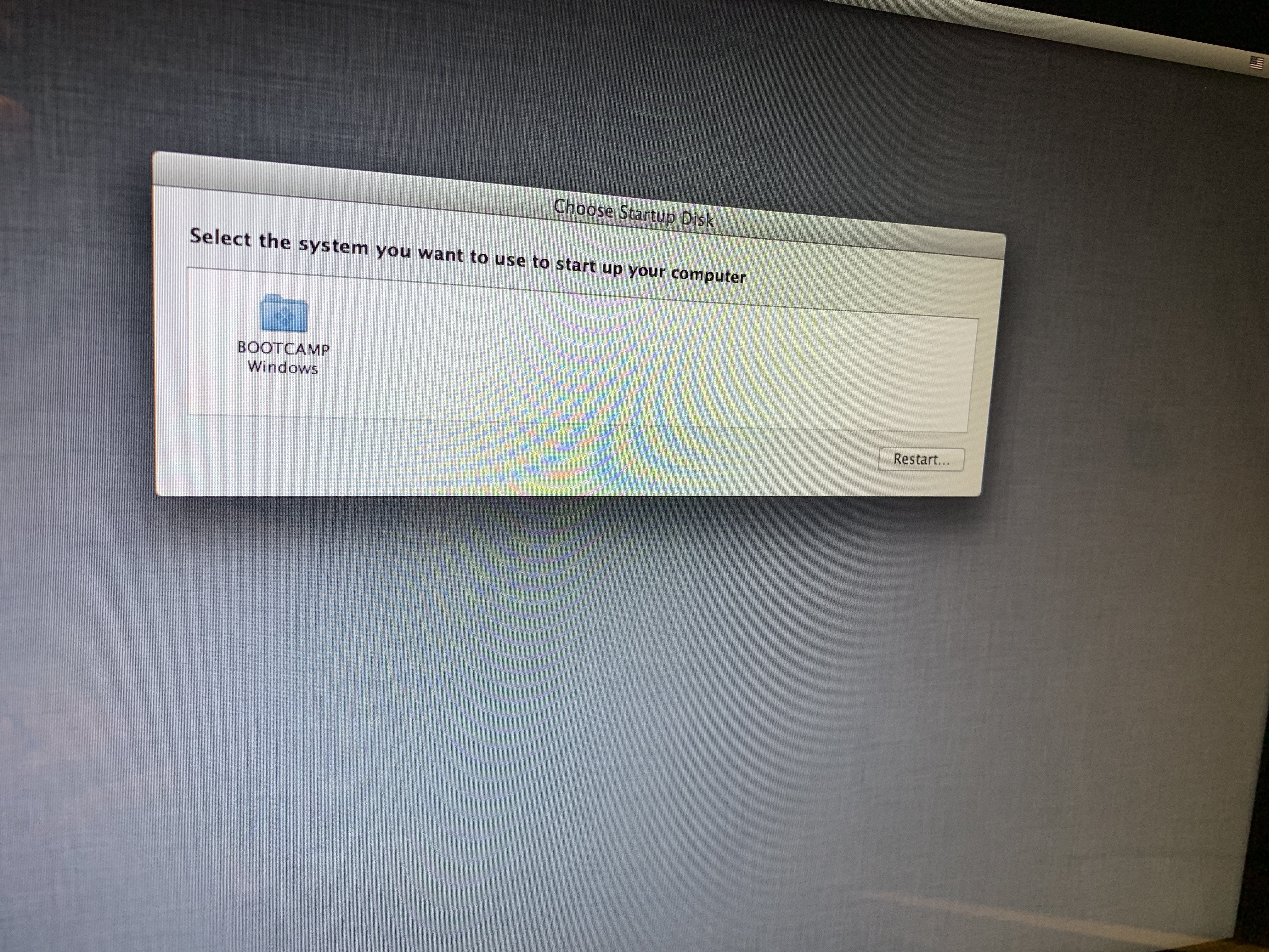

I have opened it up and swapped over the SSD, fired it up and all I am seeing is my Windows partition on disc start up.
Am I doing something wrong? I thought it would be a straight swap and job done.
Do you see the Mac position when holding down the option key? If the Mac position encrypted?
If it's a 2012, it may be missing drivers?

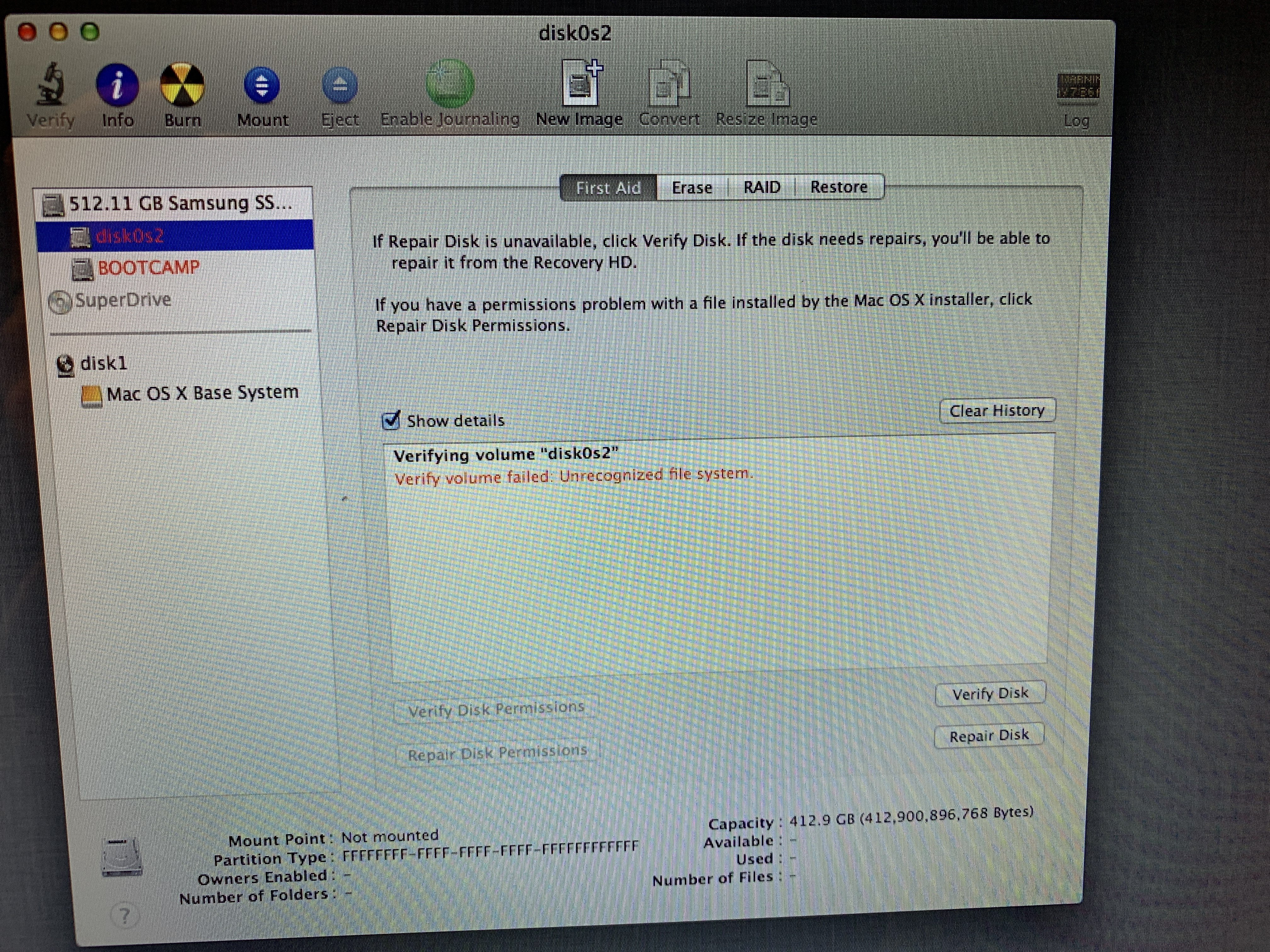

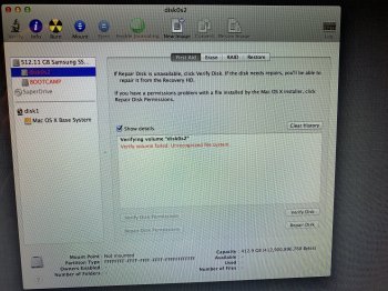

[doublepost=1551216383][/doublepost]Got into the disk utility in recovery mode but still only shows bootcamp to boot from

OK Im all sorted now.
It seems the Mac side got damaged somehow. I booted up in Recovery > Disk Utility then installed from latest time machine backup....
