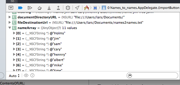

Hey AOW, thanks for the reply. The return value from
Code:
componentsSeparatedByCharactersInSet
returns an array. So nameArray is an array of NSStrings. I included a photo at a break point to show what is in the array.
If I remove the question mark, also know as the optional, from the inString? I get an error message that
'NSString?' does not have a member named 'componentsSeparatedByCharactersInSet'
But in the line above that one where I create the var inString = , that method returns an NSString.
I am assuming that in the image the nameArray says [AnyObject] because I have the optional in behind the inString? If I remove it that line of code will not work. The NSString class can't see the method that is one of it's methinds componentsSeparatedByCharactersInSet
Confused? <-not an optional 🙂

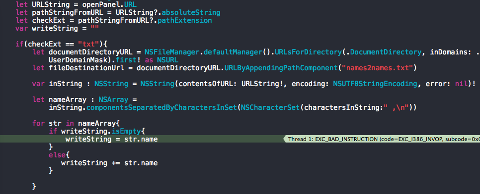

Thanks Lee. I That worked for that line of code but the join function was still a problem. I waited to reply to see if I could search the web to find out more. String and NSString are interchangeable from what I read. I tried to re write the code to concatenate but got a bad access error when running the code.
Here is the full code for the IBAction if anyone would like to help me discover the problem, Thanks.
Code:
@IBAction func importButton(sender: NSButton){ // Opens up the window to select a file
        var openPanel = NSOpenPanel()
        openPanel.allowsMultipleSelection = false
        openPanel.canChooseDirectories = false
        openPanel.canCreateDirectories = false
        openPanel.canChooseFiles = true
        openPanel.beginWithCompletionHandler { (result) -> Void in
            if result == NSFileHandlingPanelOKButton {
                let URLString = openPanel.URL
                let pathStringFromURL = URLString?.absoluteString
                let checkExt = pathStringFromURL?.pathExtension
                var writeString = ""
                if(checkExt == "txt"){
                    let documentDirectoryURL = NSFileManager.defaultManager().URLsForDirectory(.DocumentDirectory, inDomains: .UserDomainMask).first! as NSURL
                    let fileDestinationUrl = documentDirectoryURL.URLByAppendingPathComponent("names2names.txt")
                    var inString : NSString = NSString(contentsOfURL: URLString!, encoding: NSUTF8StringEncoding, error: nil)!
                    let nameArray : NSArray = inString.componentsSeparatedByCharactersInSet(NSCharacterSet(charactersInString:" ,\n"))
                    for str in nameArray{
                        if writeString.isEmpty{
                            writeString = str.name
                        else{
                           writeString += str.name
                    //let str = "\n".join(nameArray)
                    //str.writeToURL(fileDestinationUrl, atomically: true, encoding: NSUTF8StringEncoding, error: nil)
                    println(writeString)
                else{
                    println("NO, not equal to")
Does the Swift String type have a name property?
If not, then this code is wrong:
Code:
Does the Swift type NSString have a name property?
Code:
