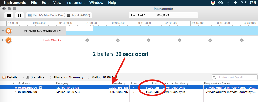

The goal here is to quickly read many segments to fill the in-memory buffers, while the data on disk is still spinning/cached/etc. Once you have a full buffer, you can read "as needed". Using your code, lets say we call a full buffer 25 seconds of audio. Each segment is 5 seconds of audio. So the changes will mean that you read 25 seconds of audio in 5 second chunks in the serial queue and schedule them. Then, once every 5 seconds, you will read another 5 second chunk as a natural consequence of one of the segments finishing playback. A couple nice benefits:
Yes, I get that. The reason I didn't want to "look ahead" that far (25 seconds) is to minimize my memory footprint. I understand that it's best to grab as much as possible from disk, at once, but I had a decision to make, a compromise. Either I grab a bigger bunch from disk and fill up a fair bit of memory, or I could just grab a small chunk every 5 seconds. It's a question of memory footprint vs efficient disk reading, I suppose.
Since, I'm always "looking ahead" at least 5 seconds (plus the initial headstart of 5 seconds), there will never be a hiccup in playback, even if the disk read suddenly slows down (unless the slowdown lasts 5 seconds or more). I decided on just having at most 10 seconds of data in memory at any given time.
I could change that to 25 seconds, I suppose, and see how my memory footprint changes. I'll give it a try and see what happens.
Something worth thinking about is actually doing some napkin math on your buffer sizes. If the PCM buffer is 24-bit at 44khz (for example), each second is about 129KB in size. Each 5 second buffer is then 645KB. For the 10 seconds you are caching, you are using just under 1.3MB of RAM for buffers as written.

Krevnik, I profiled my app with both 5 second and 30 second buffer sizes. I played the same 44.1KHz stereo audio file for both tests.
The single buffer footprints were: 1.68 MB and 10.09 MB respectively. This comes out to 1.68/5 = 344 KB/s of data, not 129KB.
Furthermore, keep in mind that I always have 2 buffers in memory, the one that's playing + the lookahead. So, for a 5 second buffer size, I'm really storing 3.36 MB, and for a 30 sec buffer size, I'm storing 20 MB.
That said, I think that my happy medium is a 15 sec buffer size, which puts two 5.05 MB buffers in memory, for a total of 10.1 MB at any given time.
5 seconds versus 25 seconds of audio buffer is a small difference in memory, still single digit megabytes. But continuously hitting disk and keeping that powered up is likely a noticeably drain on the battery. Try profiling for energy with your 5 second buffer, and see if it's an issue. It might guide you for tuning your buffer size.
Mark, interestingly, Instruments doesn't let me profile for energy with my platform being OS X. Did the developers of Instruments forget that Apple makes laptops that run OS X, that run on batteries ?
30 seconds of playback data takes up 10.09 MB vs 1.68 MB for a 5 second buffer. I don't know if that's a small difference. Maybe, in the grand scheme of things (assuming a modern machine with > 4GB of memory). Here is my code snippet that schedules buffers:
<snip>
