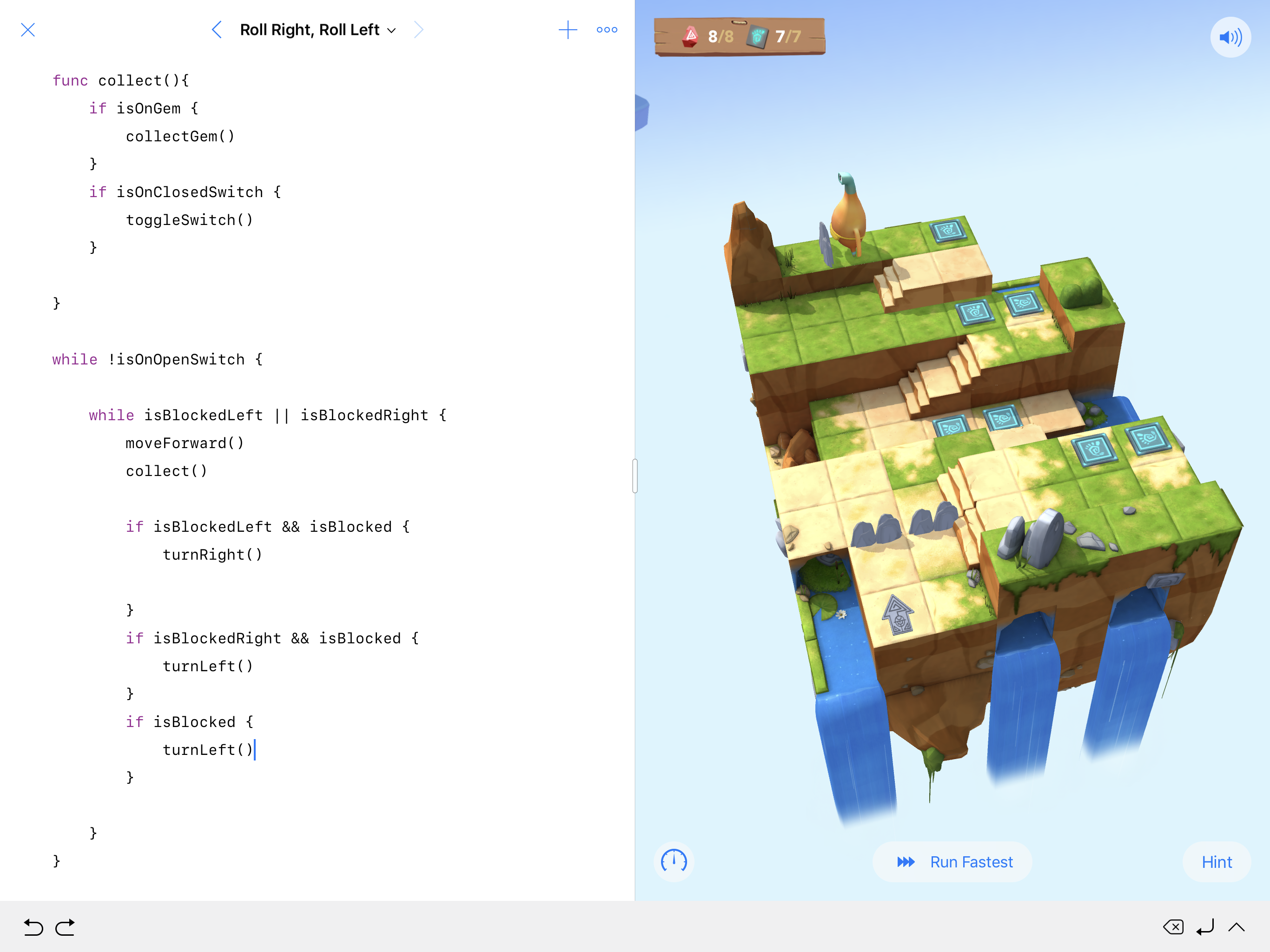

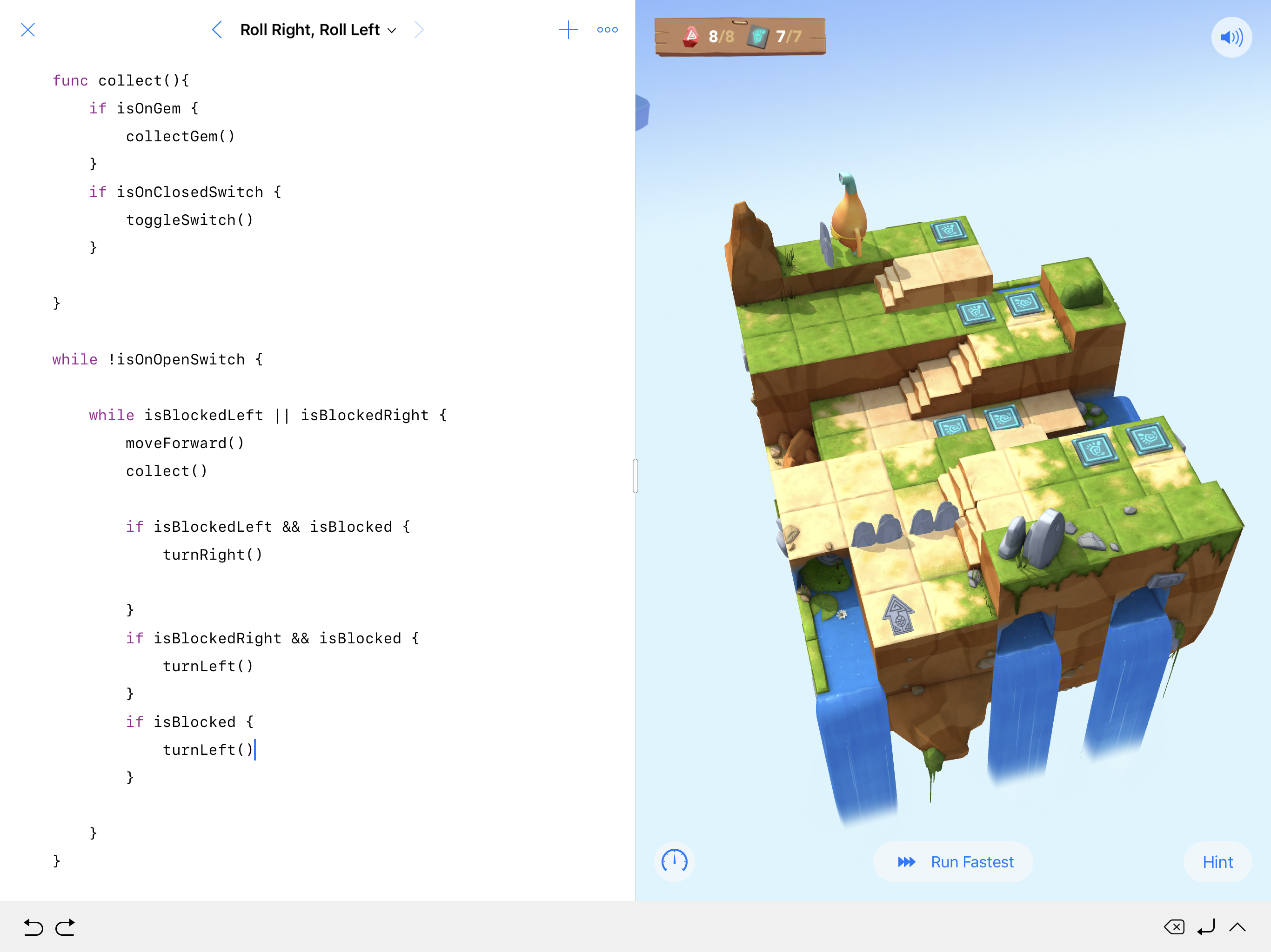

I am so confused that my creature does not stop when it is on the switch. I am sorry for this post I got frustrated.

Not sure where it exactly does that and what behaviour you expect. Could you provide more information?
My code is a bit different than yours, and since I'm on the beta the code won't run any more, so I cannot try your code.
Anyway: Is it possible your issue is because of using the loop:
while !isOnOpenSwitch ?
This causes Byte to try wo walk forever. I therefore used a for (for i in 1 ... 14) loop instead, so Byte stops once the's walked the scene
Yes probably but why? It is on the open switch 🙁
Because it never leaves the inner loop it seems: once in the final row, after turnLeft, its stuck in the inner loop (while isBlockedLeft || isBlockedRight) because it is blocked to the right, so it never leaves the loop and therefore moves forward infinitely...
So I believe I have to correct my first post: the issue is not necessarily caused by the outer loop, but rather in the inner loop, never leaving it once in the final row

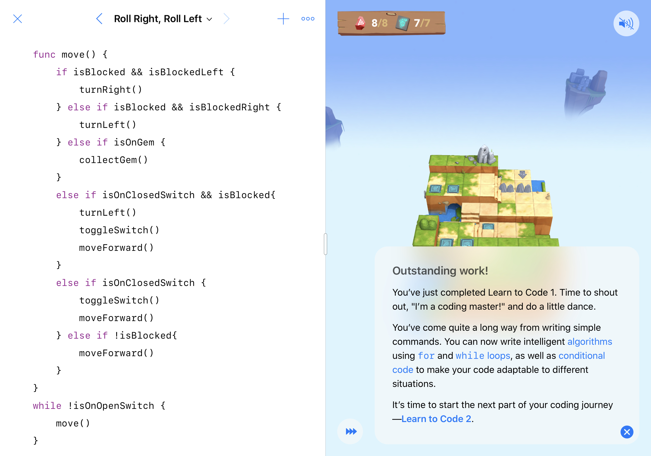

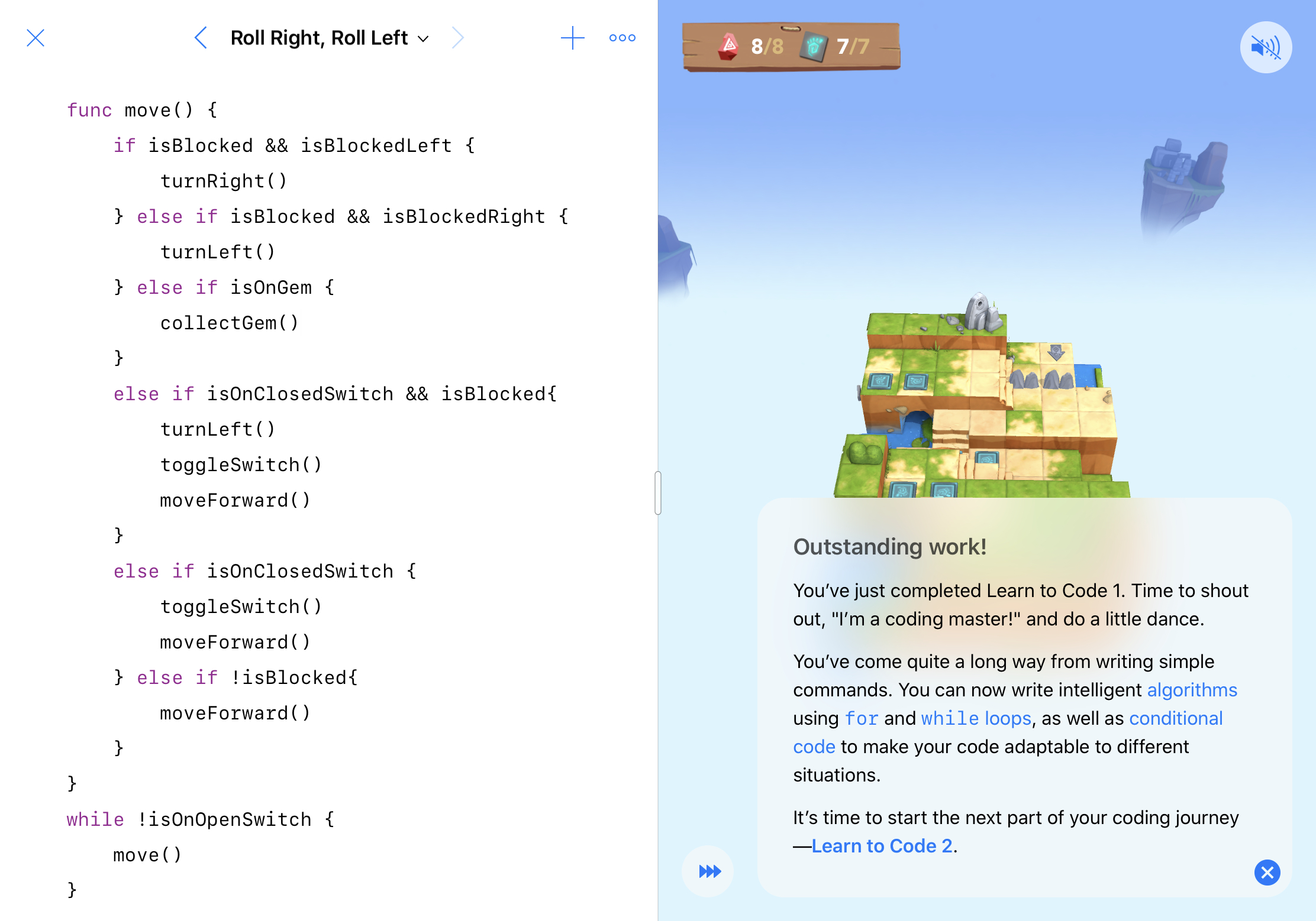

Here is what I used when I finished the challenge yesterday. Though my code isnt as simple as yours. I want to try and find a simpler way later on when I learn more about programming
