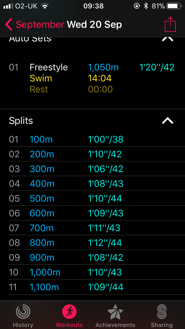

Used my series 2 watch running watchos4 in the pool yesterday and noticed some very odd things.
When I swim I've always been able to check my average pace/100m when I push off the wall as the screen turns on after a push.
I was doing a 1000m swim, and noticed that after the first 100m, 1:20 had elapsed, which is my normal pace. However, the average /100m time was showing 2:07. On the previous OS, this would display correctly and show the 1:20 as the average, since that was my first 100m, and that's how much time had elapsed. At 200m, my pace was consistent and 2:40 had elapsed, yet the watch was still showing an average much higher, this time at 1:50.
Just as odd, when this 1000m synced with my phone, it was showing my splits as being in the region of 1:10s, something which I wouldn't be able to sustain over 1000m.
It does count lengths correctly even though 1050m is indicated as I always do an extra 50m so that the splits up to 1000m are consistent because otherwise it takes into account the time it takes to unlock and end workout into the final 100m.
I've also had it freeze on me 3/4 times since updating, something which never happened on previous OS.
I only really have my watch to monitor my swimming so pretty disappointed with the update.
Anyone able to make sense of this where I am not? Or had any similar problems?

Tried swim.com last night. Much prefer the way it captures what I do. I did some identical swims using both the apple app and swim.com to compare and swim.com was just objectively better.
It uploaded to the health app but I can’t find a way to upload it to strava. Apparently exporting .fit files is a bit glitchy atm?
