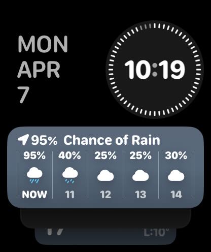

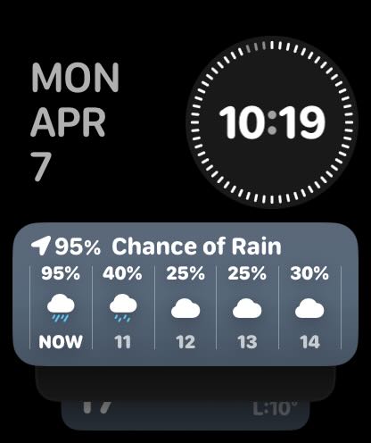

My first AW was a 6, and I now have a 10.
When I first used my 6, I was able to swipe-up, and see my Battery (charge/power level).
Along the way, this ability was removed with an Update (when, I really don't remember).
Only when I attach the Watch to a charger can I see my Battery level.
Looking-through the settings, I cannot--for the life of me--find the ability to add anything (widget?) that will enable me to immediately see the battery charge 🤷‍♂️
When I swipe-up, I get the current date, time, and weather . . . I already know the time; I just want to see the remaining charge when I'm out-and-about.
Any hints?

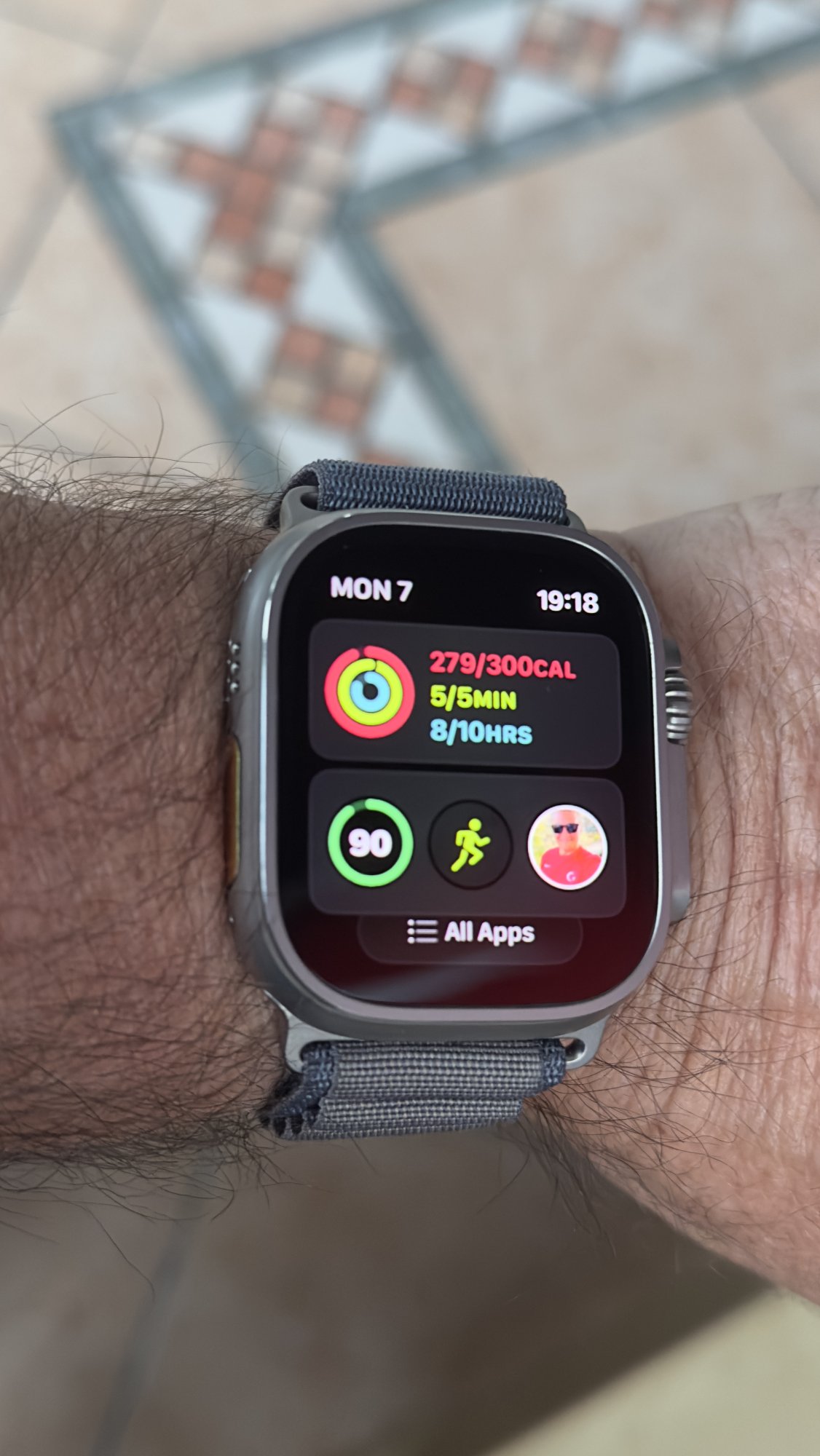

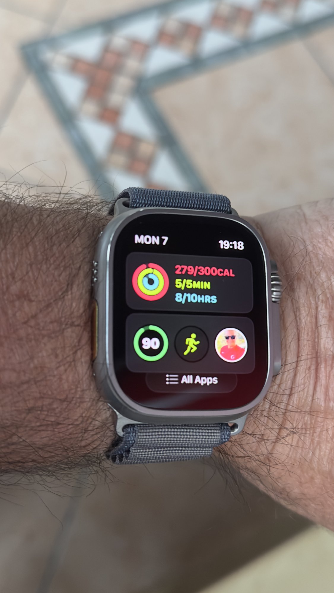

you can add battery to the smart stack for when you swipe up or scroll up
via crown..90% in photo. simply when in smart stack hold down and hit the plus sign to add a widget the battery widget is built in so no additional app required View attachment 2500146
This is actually the battery complication and not a widget. Just to clarify, the Smart Stack contains widgets and this one "triple complication widget" that allows you to add three complications to it. You need to tap the + icon on this particular widget to add the battery complication to it (you may need to remove a complication first). If you tap the other + icon to add a widget, you won't find a battery widget there since there isn't one.
