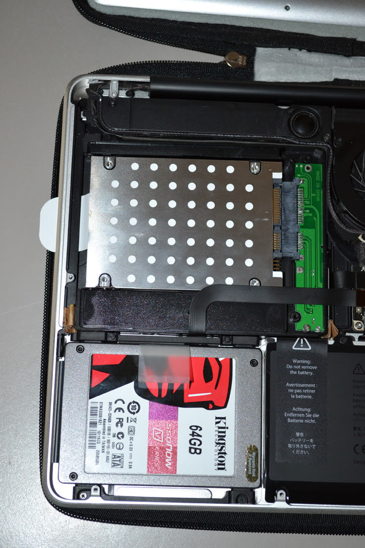

I had once installed a second drive in my 13" Unibody Macbook Pro via a generic drive caddy (with built in connector adapters). Problem is, I only need the second drive when recording audio tracks in to Logic, or when booting Windows 7. I have a 64gb SSD as a system drive, and would rather not have a second mechanical drive spinning up and down when I don't really use it much.
THE IDEA is to interrupt the power connection with a switch so that while the macbook is powered off, the drive can be enabled/disabled. The switch could be accessed via a probe (paper clip?) through the optical drive slot. Similar to how most slot load optical drives have eject buttons that can be pressed through the edge of the slot. The switch would need to be a toggle or locking switch rather than a momentary switch like an eject button is, but I think it can be done.

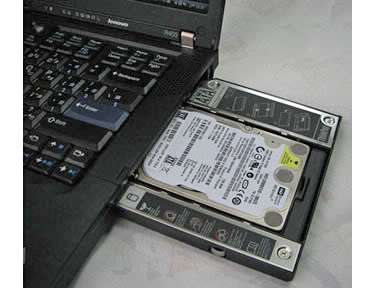

Here is an example of a loaded drive caddy. Note that there is enough room at the end of the drive where the slot in the MacBooks housing is located. This should be just enough room to place a switch of some sort.

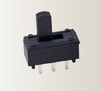

If anybody knows of a switch that might work well, please let me know. So far I am thinking of something along these lines:

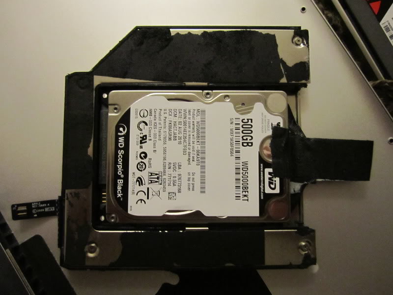

3.27.11 A very functional compromise has been made. The drive is now in a macbook caddy with pull tab and can be disconnected internally with the computer powered off. Works GREAT! Thanks to Reflow for hooking it up with the macbook caddy!

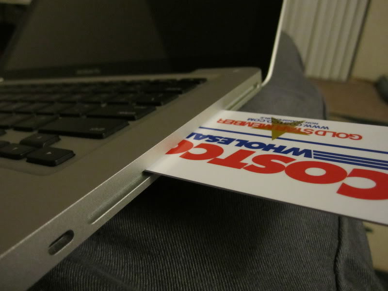

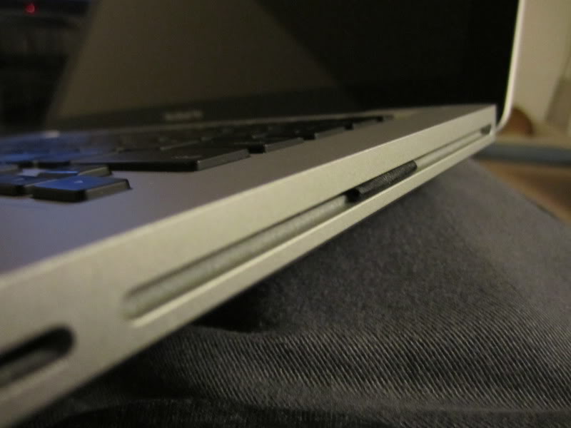

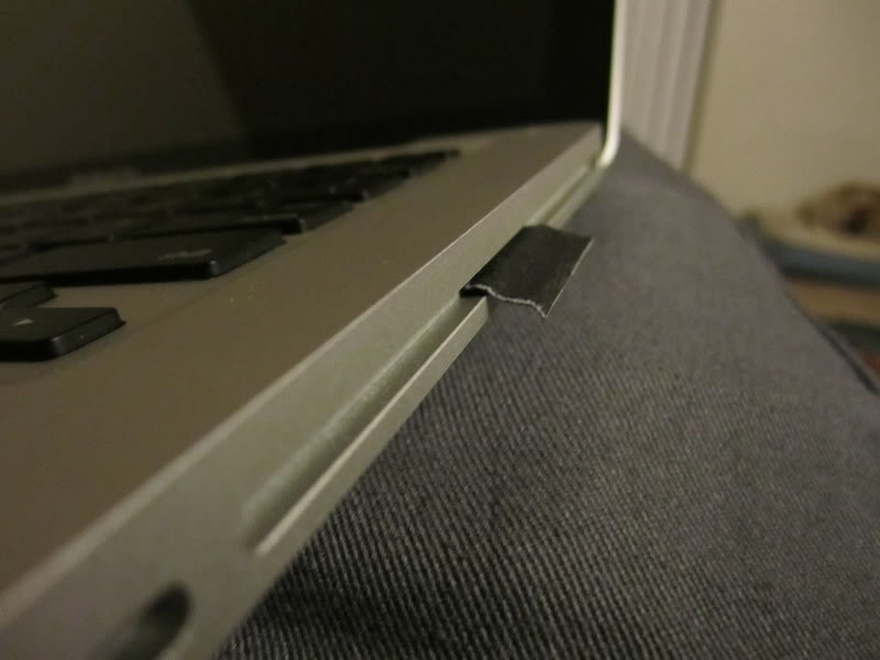

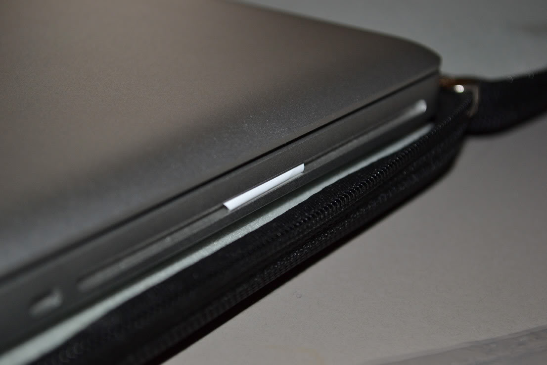

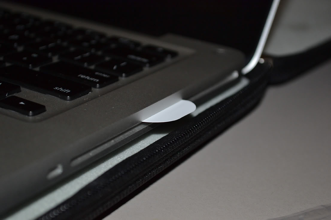

Inspired by the macbook (not pro) hard drive caddy/sled, i used some gaff tape, stuck it out the cd slot. Now with the computer off, I just pull (pretty hard) and the drive slides out from the connector. Reconnecting is done with a credit card or whatever is in my wallet.
The drive has two screws on the sides which keep it snug, and from rattling around even while disconnected.
Now all I need is one of the macbook sleds with the pull tab.

Many thanks to Reflow for hooking me up with a macbook drive caddy/pull tab.
I pulled the metallic shielding/casing from the drive slet. Fits right in with the black internals of the mbp.
